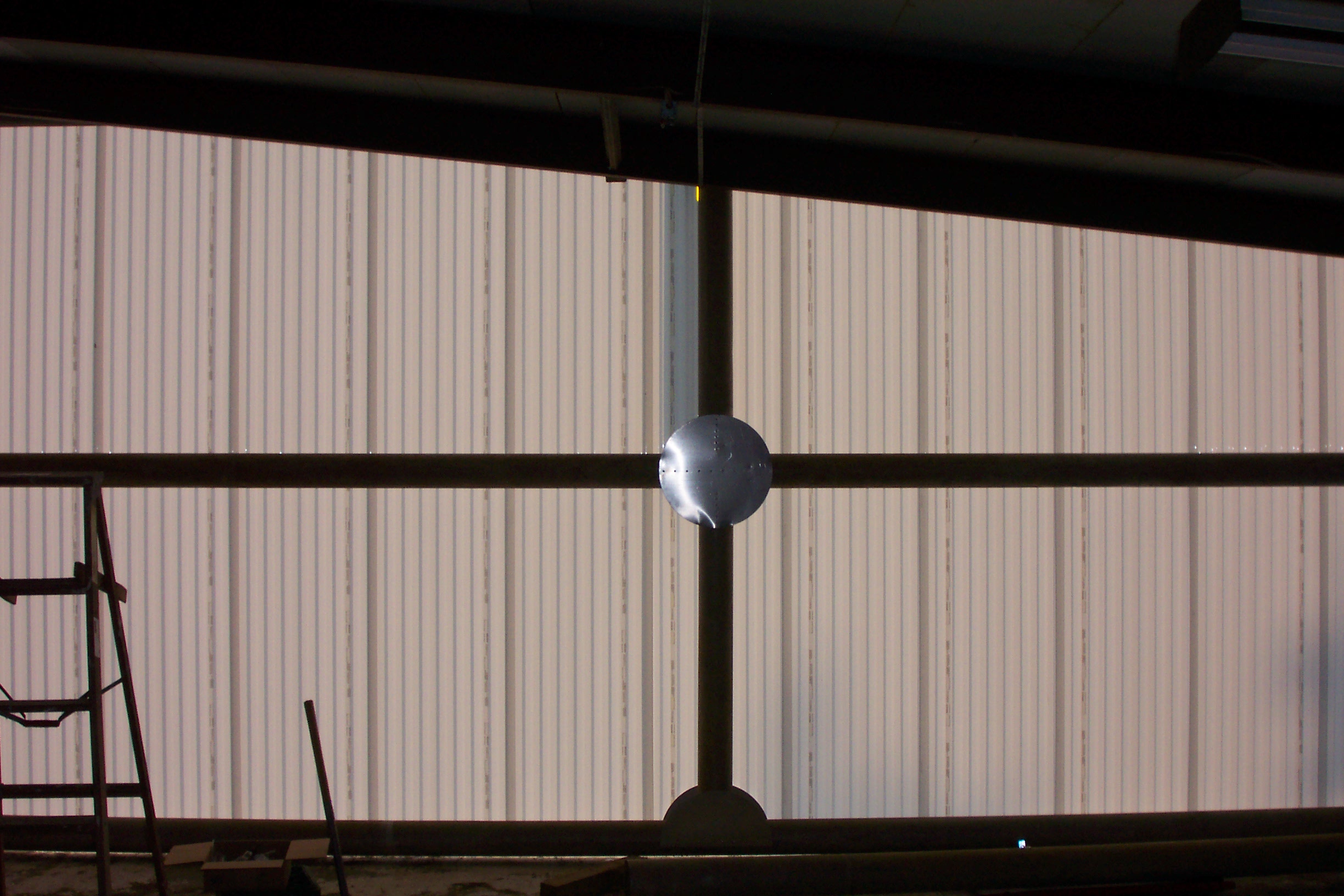

PostPosted: Sat Oct 29, 2016 12:40 pm    Post subject: 5 and 6 inch tubing Reply with quote
I don't know what alloy it is, but it makes a great one piece
hangar/shop door. 10' tall, 30' wide; counterbalanced for manual operation.
If your state publishes an agricultural newsletter, look there for deals
on used irrigation tubing.
Charlie
