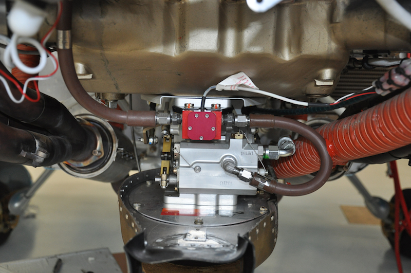

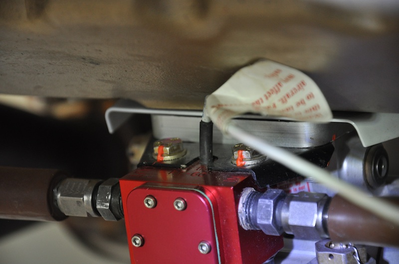

I prefer the red cube on the engine. Here are a couple pictures of a bracket I make for the red cube.  It just mounts to the studs that secure the servo.  Made from steel similar to Van's other brackets.
