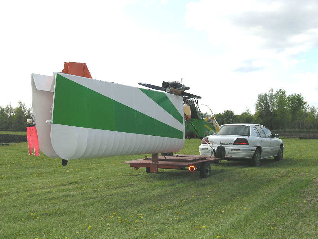

Towing ,nose forward, offers a more simple method..but not on a windy
day...Herb
On 10/16/2016 09:23 PM, Richard Pike wrote:
Years ago I built a trailer for my Maxair Hummer, which was Part 103 legal, so probably lighter than a typical Firestar. It was a modified motorcycle trailer with a MUCH longer tongue. Towed it with a VW bus. No trailer brakes, no braking problems. Biggest problem is the turbulence when an 18 wheeler passes you.
