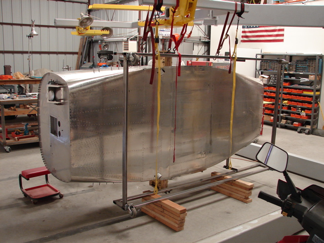

Ed
Sorry it took a while to respond, as I just got home from vacation.
This is the best picture I have of the rack handy, but it shows that
the wood between the main spars is used to mount to the rack, and
supports it in any position you need, if you have a lifting device. The
supports attaching to the step receptacles are there for when I attach
the tailcone primarily, as the fuselage is pretty much balanced on just
the spars. I made the rack low, so it can roll under things , but I
place jackstands under the lower rails when working on the plane in the
normal level position. I can easily roll under it with a creaper when
needed.
