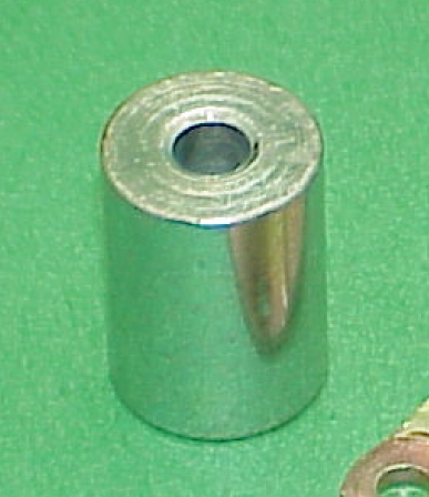

The contact mechanism I think a thick washer)
Not exactly . . .
[img]cid:.0[/img]
and its associated armature have mass.
Yes, but even less than the legacy whisky-barrel
contactor . . .
[img]cid:.1[/img]
