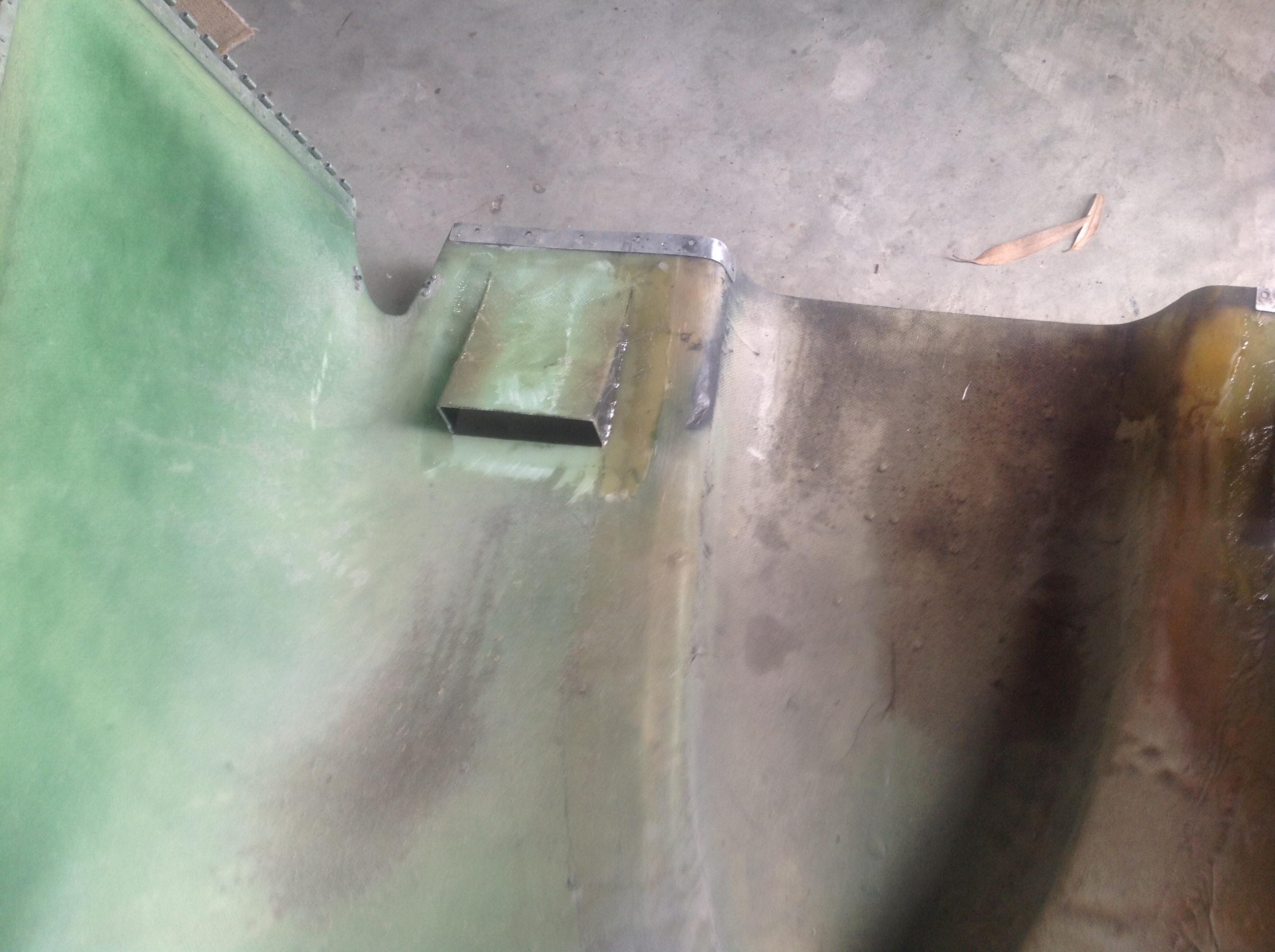

Greg McFarlane
Joined: 12 Apr 2012
Posts: 58
Location: Albany Western Australia
PostPosted: Mon Jun 13, 2016 2:23 am    Post subject: Re: Cowl Flaps Reply with quote
Have to agree with Pascall, AntiSplat has got some good gear, however you may consider this Low Tech Low Cost mod, with care can be done on painted bottom cowl, pic shows "letter box" vents in bottom cowl of an RV6. I did the same on my flying RV10. Locate the three sided cut about three inches from the rear edge of the bottom cowl, lift the front to clear the exhaust fill in the sides, job done. This mod has been very successful in reducing OIL and CHT temps on two and four place RVs here in WEST OZ by providing extra exit air flow. Other advantages apart from being a home grown successful mod are, no observed speed penalty, undetectable from the side of the aircraft, makes a handy hand hold when fitting the bottom cowl, permenant no ongoing maintenance or extra wirering and plugs. Cheers from Western Australia

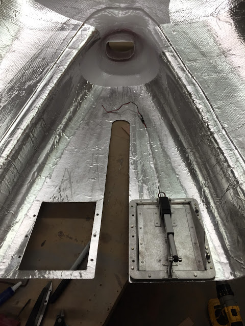

PostPosted: Mon Jun 13, 2016 6:07 am    Post subject: Cowl Flaps Reply with quote
I have a pair of AntiSplat cowl flaps installed in my 10. I'm not sure that I would do it again if I were starting over. They were expensive (at $370 each), and both of the hinges ended up cracking due to the VERY tight radius they bent into the aluminum piano hinge. I ended up replacing the hinge with stainless hinge.
Maybe I'll be a little happier with them in a few months when the PITA of replacing those hinges isn't as fresh in my mind!
As for cooling, I never had the stock louvers installed, so I can't compare one to the other, but I can do full power climbs (at ~120kts) all the way to 12k with CHTs staying below 400.

PostPosted: Mon Jun 13, 2016 1:56 pm    Post subject: Cowl Flaps Reply with quote
Thanks Ed. Very helpful. I guess that shows the stock louvers are not that effective. I was thinking of putting the cowl flaps outside the louvers. I will have to but a 3-D template to verify muffler clearance, but looked okay this morning, just eyeballing it.
