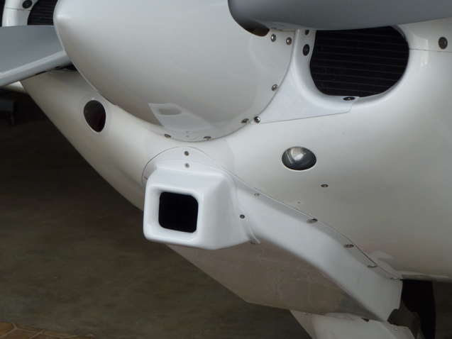

My Uncle has been working on this issue for years with different mods.  This is the current setup and works very well in the heat of Southern California. I can forward you his email if you are interested.
Image:
http://www.europaowners.org/main.php?g2_view=core.DownloadItem&g2_itemId=99649&g2_serialNumber=3
Kyle

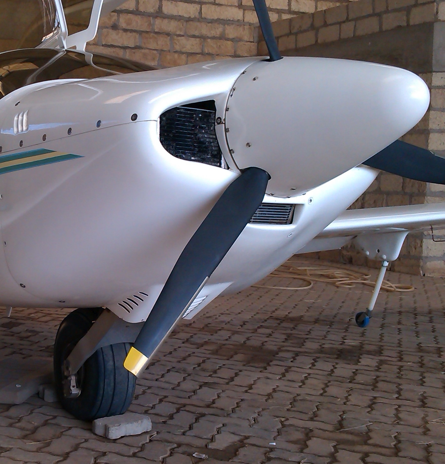

Hello Gordon,
I have the oil cooler beneath the spinner in my Kenya Europa, works very well, have never had an oil temp over 120 degrees, despite operating in 30 C temperatures. Occasionally in the climb its good to level out a bit to keep it beneath this.
I try to attach picture here, sorry cant do something more detailed, I am away from the aircraft just now (will be back to it in 2 weeks time).
Also, pictures don't attach easily on this site.
I think other cooler designs are much like this.

GBWFH2010
Joined: 31 Jul 2011
Posts: 38
PostPosted: Sun May 15, 2016 3:43 am    Post subject: Re: Reposition oil cooler on Classic Trigear Reply with quote
Richard,
Thanks for the picture. I agree my temps are ridiculous so hopefully moving the oil cooler will make a big difference.
Gordon

Quoting Dave Watts above "I mounted the cooler to the engine, centrally below the spinner arc".
Dave, I'm curious to know for how many flying hours your oil cooler has been mounted to the engine and also whether you found it necessary to mount it to some kind of 'rubber' suspension blocks to minimise the risk of engine vibrations causing the oil cooler core to crack.
If I ever have to move south into warmer weather, possibly following a Scottish referendum vote in favour of full independence, then my aluminium sticky tape solution described above might not give enough oil cooling.
Perhaps I'd use your solution which makes removing the bottom cowling so much easier.
dg.watts(at)talktalk.net
PostPosted: Thu Jun 30, 2016 6:49 am    Post subject: Reposition oil cooler on Classic Trigear Reply with quote
Jonathan,
I had done 450 hours with the original installation with the oil cooler behind the water radiator.
I have now done 1780 hours with the new installation, the last 1330 hours with the 912S fitted.
I used small Lord rubber mounts to isolate the cooler from the engine.
Dave Watts
G-BXDY Classic Monowheel 2232 hours
http://forums.matronics.com/viewtopic.php?p=457557#457557
GBWFH2010
Joined: 31 Jul 2011
Posts: 38
PostPosted: Fri Jul 01, 2016 12:31 am    Post subject: Re: Reposition oil cooler on Classic Trigear Reply with quote
Jonathan thank you for taking the trouble to post your suggestion. I have already sealed the gap between the radiators and it made a very small difference, but not enough to really help. At OAT below 20C the problem is manageable but in our 'summer' it becomes a real pain.
Dave Watts has been really helpful and supplied me with pictures of his installation. I am sure he will not mind if I share these with you and I will send them to you via email. I am in the process of trying to get a mod submitted and approved based on Dave's mod. I will let you know how I get on.
Gordon
