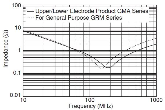

PostPosted: Thu Apr 14, 2016 12:57 pm    Post subject: RF Interference Reply with quote
Your itty-bitty filter:
1. how big is it? perhaps put a penny in the picture
about .4 x .8 inches
2. when you designed the filter, what frequency are you trying to filter? I'm guessing it's somewhere in 110-140 MHz but what about harmonics?
yes, the parts are 'speced' in the VHF comm
range but effectiveness of the array extends
upward a decade or more.
3. are those tiny surface-mount components an inductor & a cap? (or is it the case that: "you could tell me but then you'd have to kill me?" Wink
No big deal. Pick a series reactance from
this array of possibilities . . .
http://tinyurl.com/zn4knzj
Primary concerns are current trough the inductor
and voltage drop in the inductor. Then see
how high a reactance you can get within space
and volume concerns. Capacitors either side need
not me more than 1 to 10 nF . . . These monolythic
capacitors have 'dips'in impedance in the
regions around VHF comm . . . but still quite
useful over the regions on either side.
[img]cid:.0[/img]
Designing these filters is not very technical.
They're easy to craft with a brute force approach
to energy attenuation above 20 MHz or so.
 Filesize:  129.23 KB
 Viewed:  1681 Time(s)
