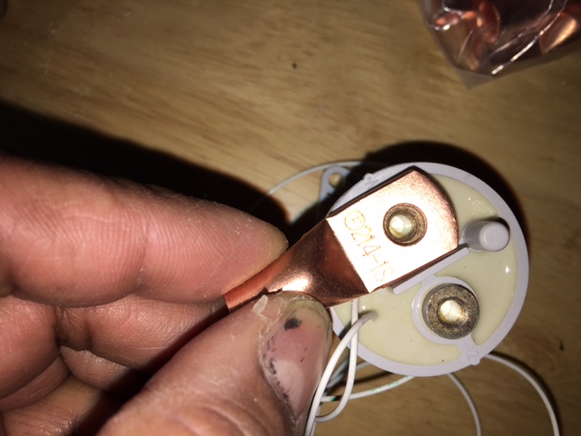

Hello Group
I have been looking for terminal lugs for these contactors without much luck. These contactors have terminals that take M5 (0.19") bolts and the smallest holes on a copper lug that I could find are 5/16".
To those who have used these contactors, what lugs did you use?

What size cable are you using?

PostPosted: Tue Mar 29, 2016 8:40 am    Post subject: Ring Terminals for Tyco LEV100A4ANG Reply with quote
#2 and #4
I found a 1/4 lug, but it is still large. Not sure if I can use washers between the terminal and the lug.
Hari

PostPosted: Tue Mar 29, 2016 8:42 am    Post subject: Ring Terminals for Tyco LEV100A4ANG Reply with quote
At 09:56 AM 3/29/2016, you wrote:
Hello Group
Order 3/16 terminals and drill them out to M5
