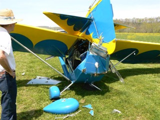

On Mar 22, 2016, at 4:39 PM, Bill Berle <victorbravo(at)sbcglobal.net (victorbravo(at)sbcglobal.net)> wrote:
Also, the hinges themselves are not designed for the loads to be hanging out 3/8 or 1/2 inch from their attachment, like a diving board.
Bill,
The surest way to compromise the structural integrity of a Kolb Aircraft is to attempt to fix a structual problem/weakness that does not actually exist.
Over the years numerous kolb aircraft have experienced catastrophic violent crashes and not even in a violent crash has one ever documented a failure of the parts you hope to “improve”.
[img]cid:EC5B878A-11DA-4A2E-ABDC-DAC2CFB95947(at)PK5001Z[/img]

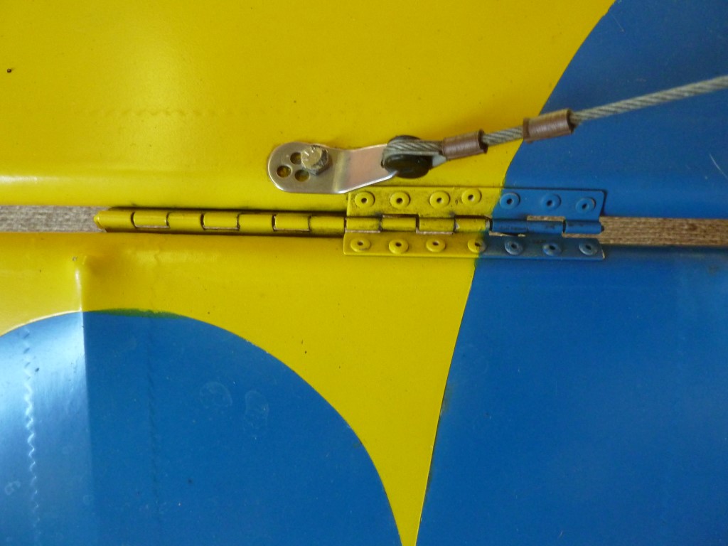

If you don't like having all the hinges on one side, there is an easy fix: check out the picture of the elevator hinge below.
Thanks to Eugene Zimmerman for the picture of N582EF in a wad. Kolb has come out with a new and much stronger axle fitting - shame that so many of them had to break first.

Thank you sincerely Richard, that hinge setup in your photo looks a lot more solid to me. If I were going to use the stock piano hinge I would do it that way (and feel much better about it than the original plans method). In fact, if there turns out to be some unforeseen problem with my own proposed hinge method, I will revert back to the method shown in your photo with piano hinges. At the very least it balances out the off-axis forces, which is what I was not happy with in the first place.
is an easy fix:
Richard Pike

Front spar collapse: John Hauck posted some really freaky pictures of what happened to his front spar when the forward part of the ribs failed in compression, and brought him down under silk. Make sure that your leading edge cannot move or displace under any circumstances.
