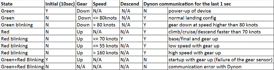

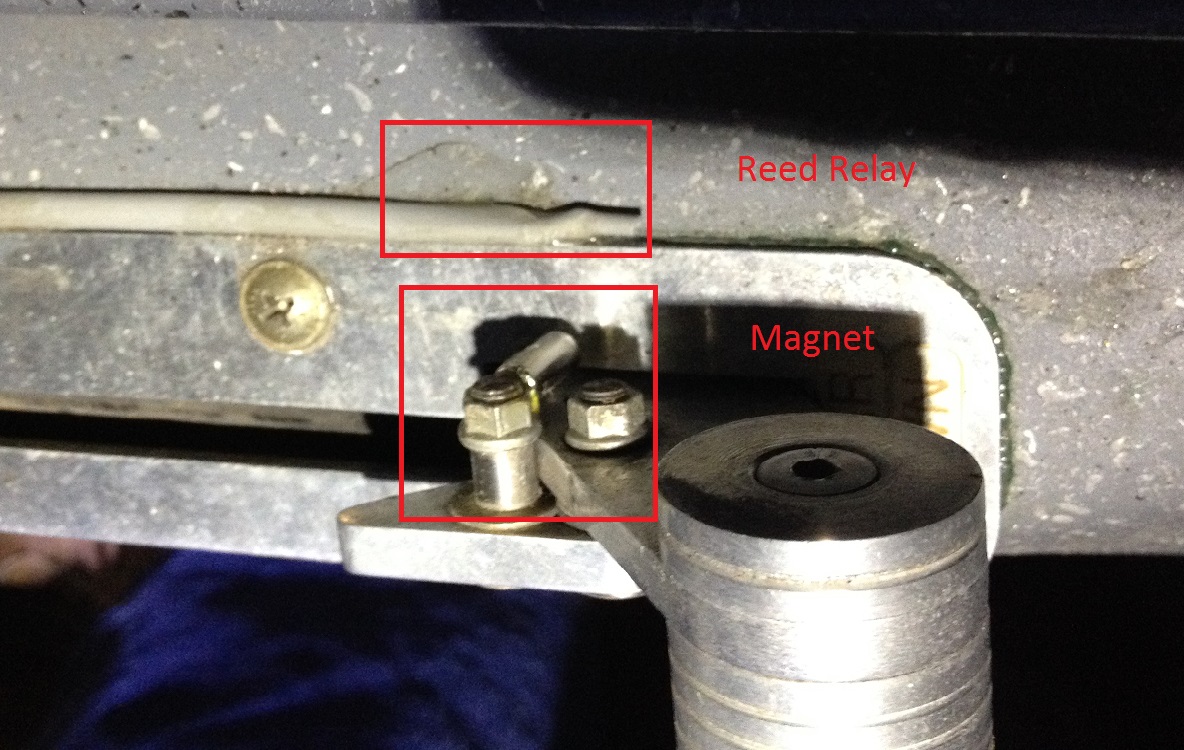

Here is a picture my system:
- a reed relay in the gray heat shrink
- a magnet that only activates the reed relay when the gear lock is down
The reed relay is connected to a small box with an arduino that reads out the serial stream of a Dynon D10A (for speed and climb information) and lights up a dual color led on my panel according to the following scheme:
 Filesize:  35.28 KB
 Viewed:  11173 Time(s)
 Filesize:  308.71 KB

Just looking at your annunciation "truth table" in your gear_scheme_624.gif.
Shouldn't line 7 warn if the condition is "high speed gear DOWN"?

(at)Nigel, red blinking is the annunciation that you are above 160knots (about Vne) for line 7. In this case, gear is up.
When gear is down and above 80knots, line 3 becomes relevant and the annunciation is green blinking.
So basically when something is wrong with speed/gear, you get a blinking led.
When the situation is "normal", you get a steady led: red for gear up and green for gear down.

Thanks for the clarification Jacques, I can see that now, and spotted
line three after I posted. I'm just about to fit a SmartAss myself so
have an interest.
Nigel
