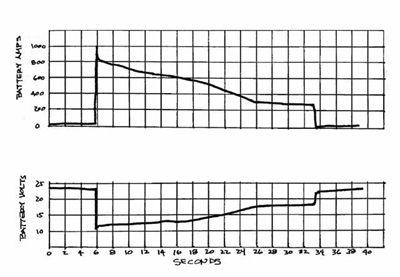

Understand. Inrush on a turbine engine is typically
1000A . . . Here's a plot taken from a Beech 400
(Beechjet/MU300) . . . real contact welder!
[img]cid:7.1.0.9.0.20160220115115.07420e28(at)aeroelectric.com.0[/img]
Thanks for the expansion!
