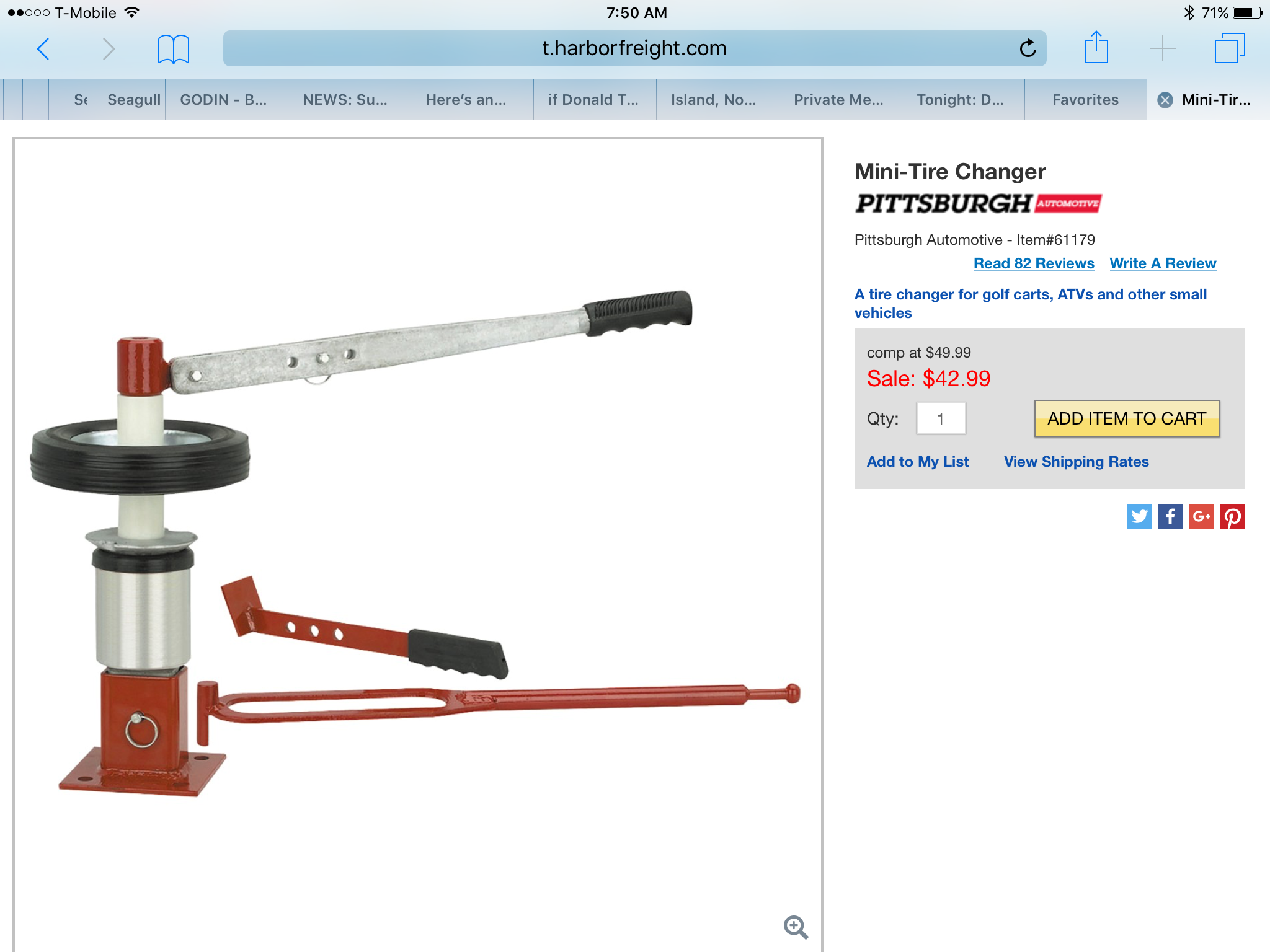

I bought this mini tire changer six years ago at Northern Tool. It has worked well for me. They no longer carry it, but Harbor Freight is advertising it.
Hope that helps!

PostPosted: Fri Feb 19, 2016 4:58 am    Post subject: Re: Tire Replacement Reply with quote
Wow! That turned out way bigger than I intended! Sorry!
Hope that helps!
