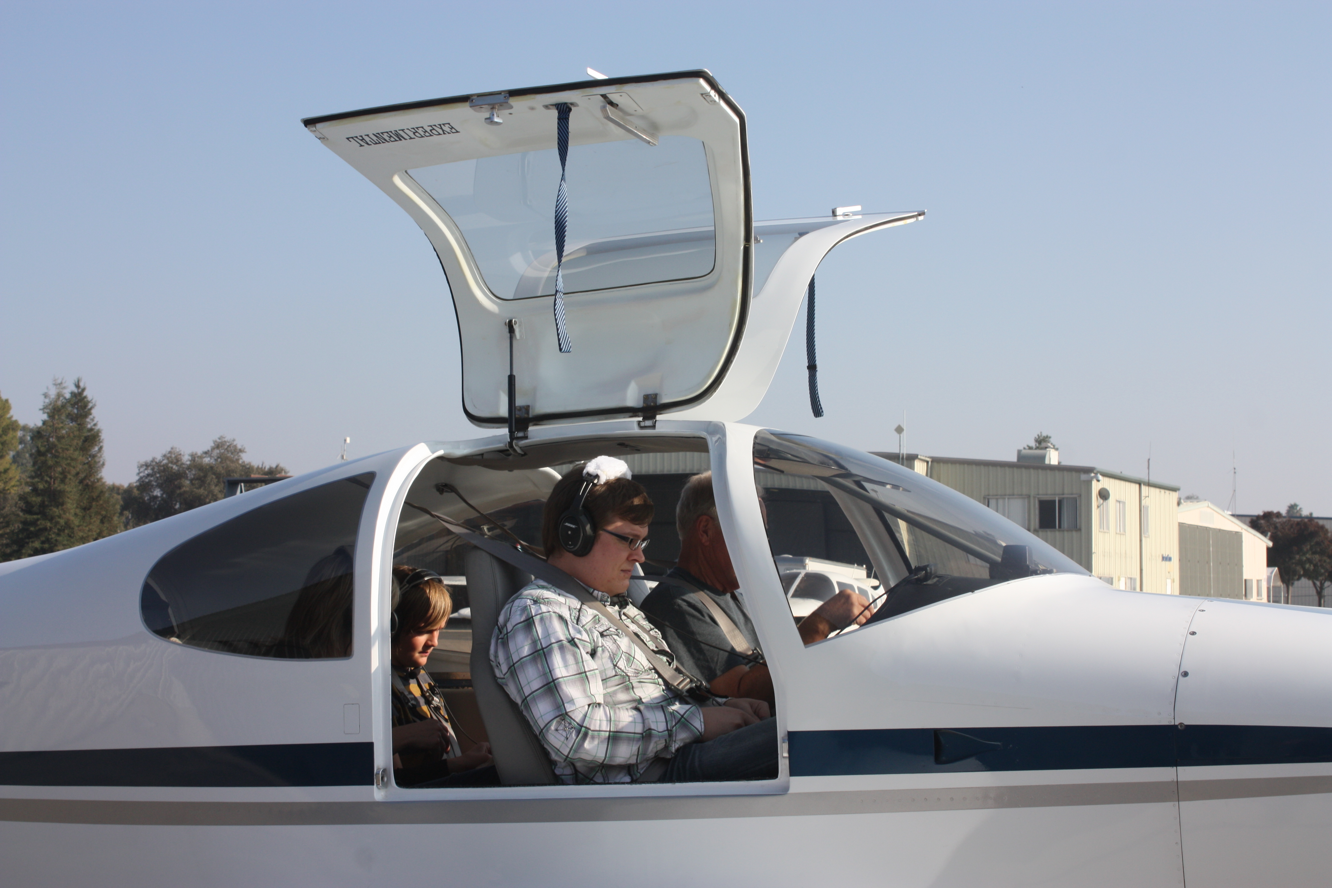

do not archive< --> http://www.matronics.com/Navigato --> h &nbsphref="http://www.matronics.com/contribution" target="_blank">http://www=======================
 Filesize:  3 MB
 Viewed:  24190 Time(s)

I agree on the straps.  Having just flown around the tropics a bit, I found that the strap combined with fresh struts allow me to engine start and taxi with 1 or both doors fully open.  The straps allow them to be pulled down while belted in.  The also allow an arm to be hooked in the strap so the door can be held close but with the prop blast keeping a 3 - 6 inch gap.  All very useful here in NC let alone south FL.
Bill "flying with fresh struts and new latches" Watson
On 11/2/2015 5:07 PM, Don McDonald wrote:
Strap is nice to let the door up, and pull the door down..(while firmly sitting in the seat).. not sure I would like going back to not having the strap.

Be careful.  The door hinges are fragile.  I have a rule that if the engine is running or if the plane is unattended and not in a hangar, the doors are shut and locked.
Carl

I realize this is not a flying situation, but the doors were known for flying off their hinges in the air when the rear wasn’t completely engaging. My rule is I check the doors are shut and secured before starting and they don’t open again until the engine is shut off. The vents provide plenty of air for me in So Cal during the middle of Summer while the engine is running.
Pascal

That's a good rule and one worth following.
I just can't follow it.  It's almost always too hot to even think about taxiing around with the doors shut in the NC hot seasons.  In KEYW FL with humidity, heat and sun, it can be dangerous even with1500 RPMs blowing vent air directly on the face and body.
I accept that the hinges may be fragile but I don't see any sign of them being fragile relative to be open when taxiing.  It didn't feel right when I first tried it with the minor flopping around and stuff but I've gotten use to it and haven't found any cracks yet.
Regarding the 'flying off the hinges in flight' issue.  My original build includes aftermarket pin blocks along with the full Vans electrical check system.  Along with all that, this pilot visually checks front and rear door seating before every takeoff.  But that's still short of foolproof  enough for a version 1 door latch so I just added the Plane Around 90 degree retrofit kit.  I already had a flush latch and door lock.
The retrofit kit is wonderful when compared to the version 1 Vans latch (w/o later mod).  Previously I had trouble using the flush latches to fully close and lock the doors.  I never let a passenger operate the door latch without my hands on it.  Now everything works perfectly and easily.  And though I will continue to visually check the door seating on each takeoff, I haven't been able to close the door and latch without engaging both pins no matter how I or my passenger try to screw it up.  Great kit that!  Now I just have to refinish the interior of the door.

I was speaking more from my perspective of having 2 young daughters that I have at least once been distracted enough to miss a Checklist item, and specifically when hot and everyone tends to want to rush to get up in the air. I simply need both hands on mixture and flightstick and radios to not want to worry about the doors and missing any items on the Checklist. No way I would trust anyone to hold the door open while taxiing,
Although we both have mild winters where we live, maybe a good project for you this winter-http://www.matronics.com/searching/getmsg_script.cgi?INDEX=73537077?KEYS=pascal?LISTNAME=RV10?HITNUMBER=785?SERIAL=0813279166XXX?SHOWBUTTONS=YES
Just need scrap (maybe time for a new cooler [img]cid:2B04E87F58004C6EBA1A8942AA89776C(at)pascalPC[/img] ) I happen to have an old oil cooler that came with my engine so most parts were available.
Only issue with this is getting ice, but most FBO’s I stop at tend to have ice, don’t need much just enough to blow colder air than the OAT.

I again urge caution.  While you may have successfully tested taxi with the doors open, the “other airplane” prop blast might be waiting to bite.  Same for leaving the doors open or closed but not locked on the ramp when the plane is unattended.
Just did a run out west this summer to Albuquerque and Phoenix.  While warm, once the engine was started there was adequate cockpit ventilation with the doors shut and locked to make things tolerable.
Carl (been there – done that and the hinges snapped like dry twigs)

I've been following this thread with much interest, and have some questions ....
Is the failure of the hinges caused by the door in motion coming against the hinge travel .... such as caused by a gust of wind or prop blast on an unrestrained door?
How about a door partially open and restrained?
I envision the strap on my door .... used to close it while seated .... with snaps ... think boat tarps ... strategically placed so that it serves as a safety to restrain the door in case of an opening in flight and also to hold the door partially open for ventilation.
I have the replacement 600N gas struts.
Linn .... painting tail feathers, pants and fairings
