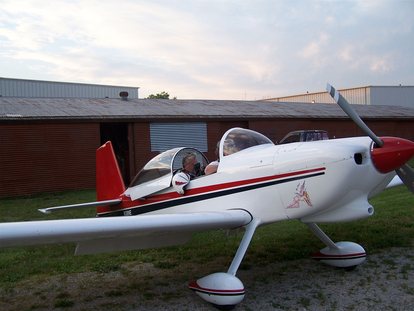

Gary,
Great reply. My flying buddy weighs 240 and I go 204.The great thing about
the RV8 is that we both fit just fine., even when we're flying to a new
airport restaurant. With 200 HP+ and a constant speed prop the little sky
dancer jumps off the runway in about 300 ft and cruises 22/24 at 160 kts.
Top speed at altitude is 194mph.The plane still came in at 1128 lbs with an
ostrich leather interior complete with side panels and rear armrests. We are
full IFR 2 GPS's and unless your stomach is a lot more stable than mine you
won't push the 6 G limit all that much. Keep pounding the rivets , it' all
worth it!
Tom
