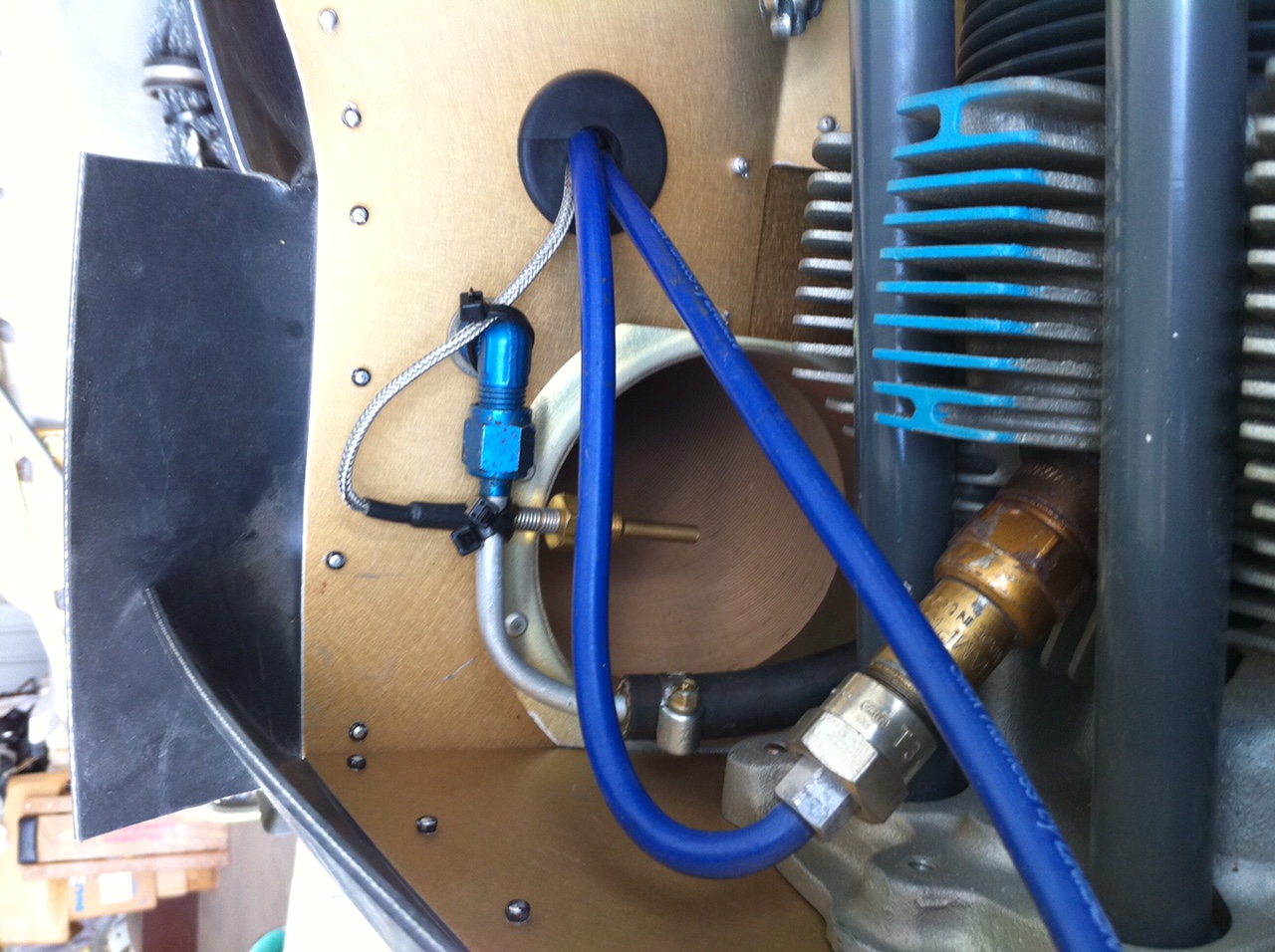

PostPosted: Fri Oct 30, 2015 5:17 pm    Post subject: AA5B vs. AG5B Reply with quote
At one point in time my AG5B had the induction set up to derive the incoming air from either the factory AG5B location on the bottom of the cowl or the factory AA5B location behind cylinder #3
This could be changed from one to the other while in flight.
The difference in manifold pressure was 3/4 to 1" with the AA5B inlet having the higher pressure.
Just FYI,
The LoPresti nose bowl advertisements say that the NACA side scoop provides lower inlet air temps.
I put a temp sensor in front of the AA5B type inlet in my Tiger and found that the inlet temp is equal to the OAT at all times except when sitting on the ground in high OAT temps after idling for about ten minutes. Then the inlet temp was a little higher than OAT
Ned
