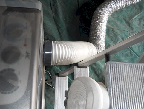

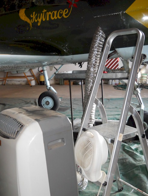

Hi
This is how I do it:
I use a portable on wheels airconditioner, a small heater and a aluminium foil type duct which can be bought at a DIY store.
Normally an airconditioner will take warm air from the rear inlet, cool it and blow the cold air out in front and the hot resultant air out of its "exhaust outlet". This outlet pipe is usually routed out of a window or maybe a hole in the ceiling and out.
So what I do is to extend the standard outlet with the aluminium flxible duct and route it in to the engine bay between the fuselage and cowling.
I place the little heater at the rear of the airconditioner at the inlet.
The hot air from the exhaust is hot and a strong airflow.
This works much better than just a small heater with a fan or other sump heaters.
I set this up as a first thing and then start pre-flight. By the time I am done with the pre-flight, the CHT temp raised by at least 20 degrees Celsius.
This way you heat up the whole engine and not only the sump as with some sump heaters.
I must say that the winters never really get colder than -2 to -3 degrees Celsius and the YAK-52 live inside a hanger.
