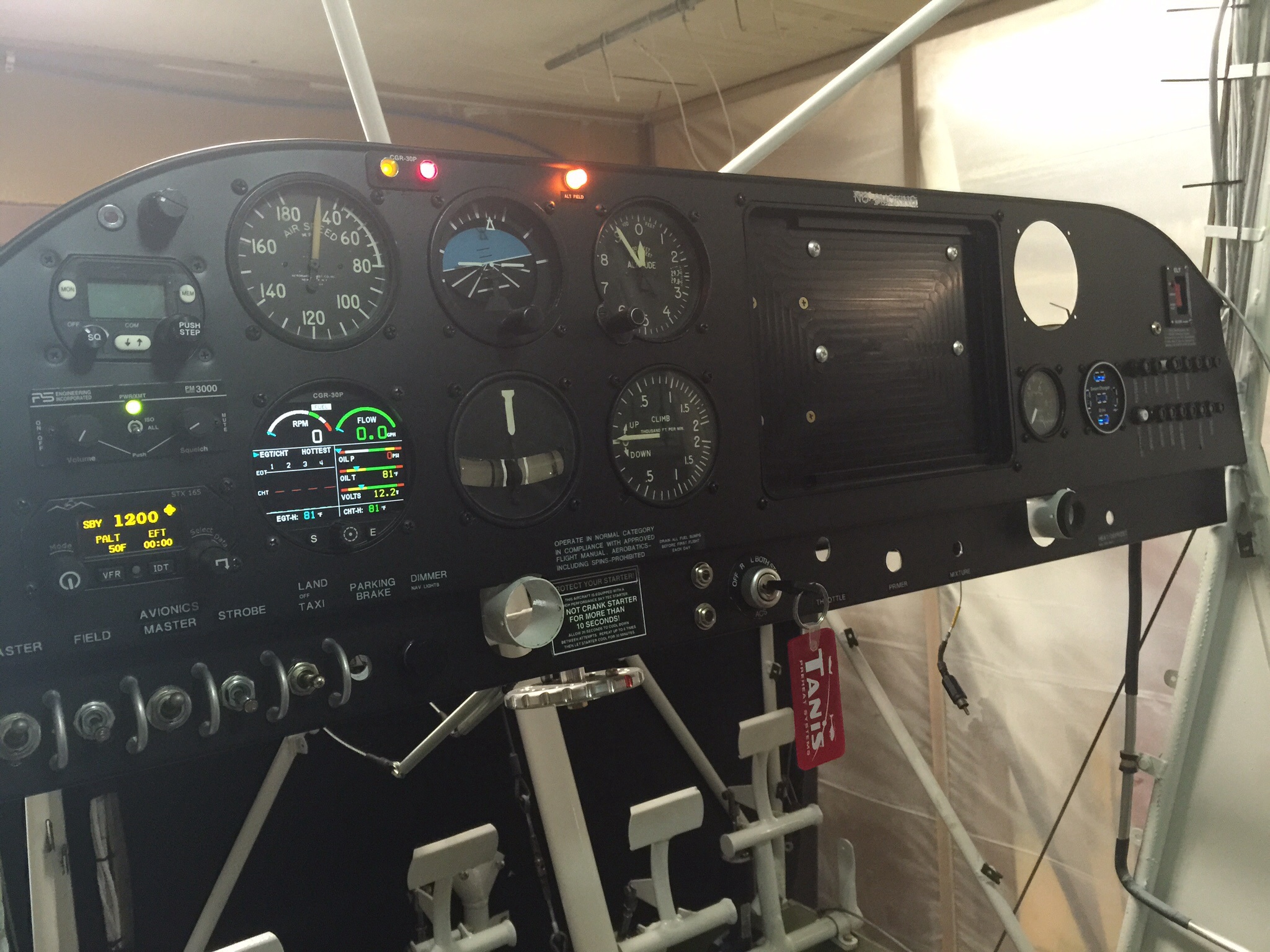

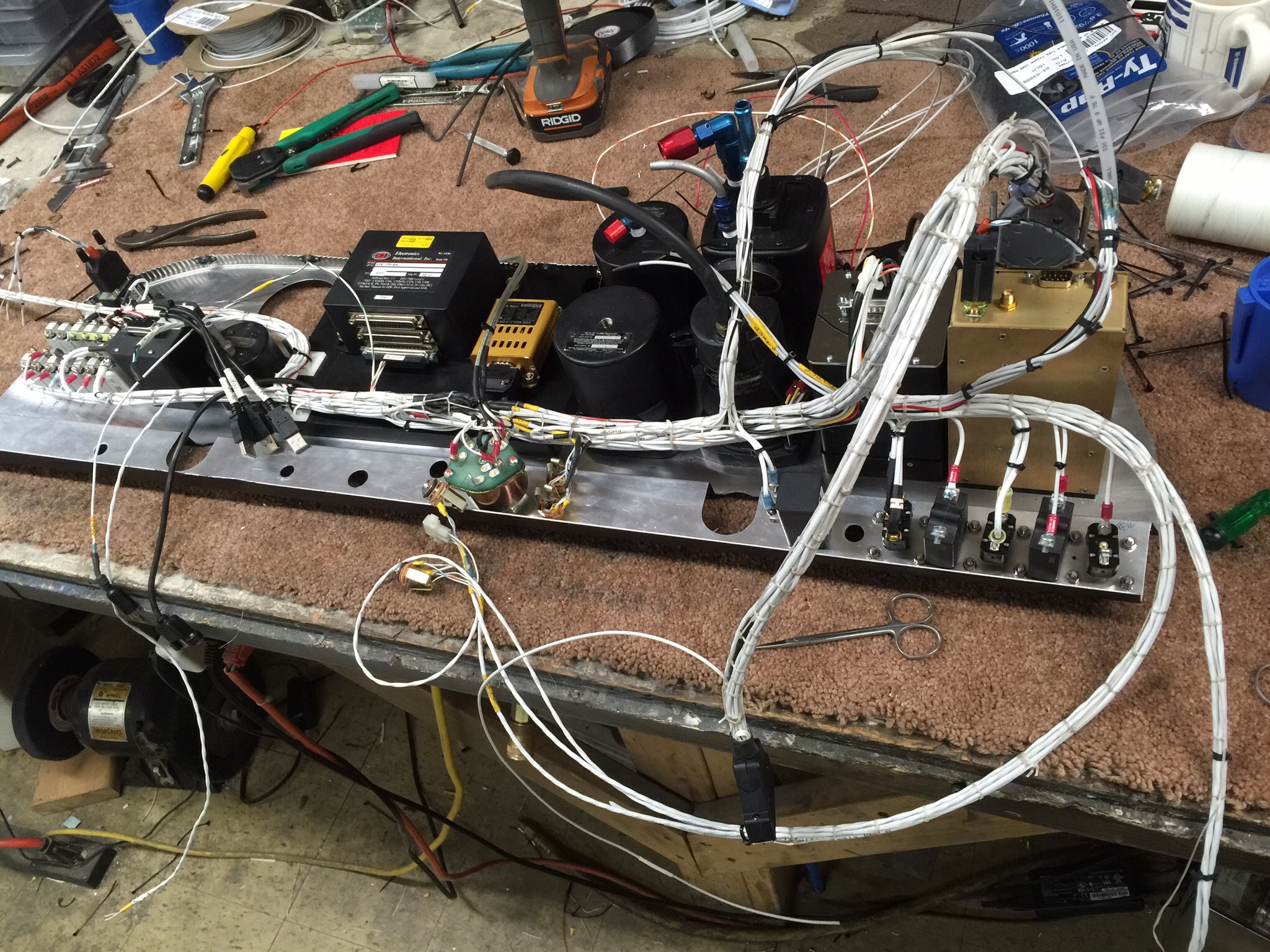

Panel is almost ready to instal. Dimmer pot for the Ei hardware should be here today. Head set jacks extended. A few zip ties remain. On the subject of stuck starter solenoids. On my list of pros and cons for locating the starter contactor under the seat... How easy is it to get at if I need to whack it with something or disconnect it from the battery? Deciding the trade off... More wire up the firewall to a solenoid location accessible with the cowl open. Or deal with pulling the seat.
Marv and I spoke yesterday about the avionics master. When the PM3000 and the Sandia transponder was installed. The avionics guy told Marv and I to pull the breakers for them before starting the engine. Don't recall the reason. If the battery is nearly dead, low voltage....start contactor just asking to be stuck. Or brown out. A good battery shouldn't pull down below 10.8 volts under a load. What if it does due to poor health or some other reason. Being in the middle of now where. Many many times waiting for the temperature to reach 25 below zero before the first flight. Decided the avionics master is a good thing for me.
Some of the other decisions I made... Perhaps due to drain bramage....but. Decided to go with the Ei amp shunt on the alternator. I'd rather know if the field voltage reduces as the battery charge state comes up after starting. Or to discover the ampherage is greater than normal, indicating a possible battery problem. Monitor the battery health with the voltage meter.

At 12:19 PM 6/22/2015, you wrote:
--> AeroElectric-List message posted by: "mmoyle" <moylemc(at)gmail.com>
Normally, shuts off the battery master to stop the fault . . . so that it can be dealt with in a relaxed manner.
Ideally, one chooses a starter contactor designed to minimize the sticking phenomenon . . . THEN one also MAINTAINS the battery in a condition that (1) provides design-goal-driven endurance requirements from which the happy condition (2) arises: Risks for starter contactor sticking are significantly reduced.
I'll bet he doesn't have one . . . beyond the notion that 'everybody does it' . . .
Further, pulling a breaker is not accepted operational practice . . . you won't find that behavior in any TC aircraft POH. If shutting a thing OFF for cranking operations is a good thing to do . . . then the reason is probably NOT something you want to spend money on.
BINGO! Routine preventative maintenance of the battery is the time honored, demonstrated recipe for comfortable completion of missions to PREDICTABLE compliance with design goals while minimizing miseries. There is NO GOOD REASON to be "in the middle of nowhere" with a soggy battery . . . there are lots of bad reasons . . . mostly founded in the owner/operators's less than responsible attitudes toward battery maintenance.
Being short on fuel 'in the middle of nowhere' would get you many raised eyebrows around a table of suds and pizzas . . . sadly, being caught in-the-wild with a soggy battery is all too often simply attributed to 'bad luck'.
I suggest that it is easy to make it NOT so . . .
Bob . . . [quote][b]

No smoke..... Every thing functions.... Haven't powered up the radio yet. I'd like to have an antenna connected before closing the breaker.... Marv gifted me The Bob's book. Arrived in the mail today. Another manual to digest.... Thank you Marv and Bob. When I get to the Bearhawk harness I will be better edge-you-ma-kate'd. One odd thing I found today. Have installed a dimmer rheostat for the Ei components. The engine monitor dims nicely.....thing is the Ei USB power supply is opposite. It gets bright as the engine monitor gets dim??. Don't know if I made a mistake...some ting Wong? One question I've asked on the shortwing and Bearhawk group.... No answer. Hour meter. The Ei engine monitor is programmed with the actual total time on the aircraft. Do I need a separate hour meter? Not having fresh trout for dinner......
