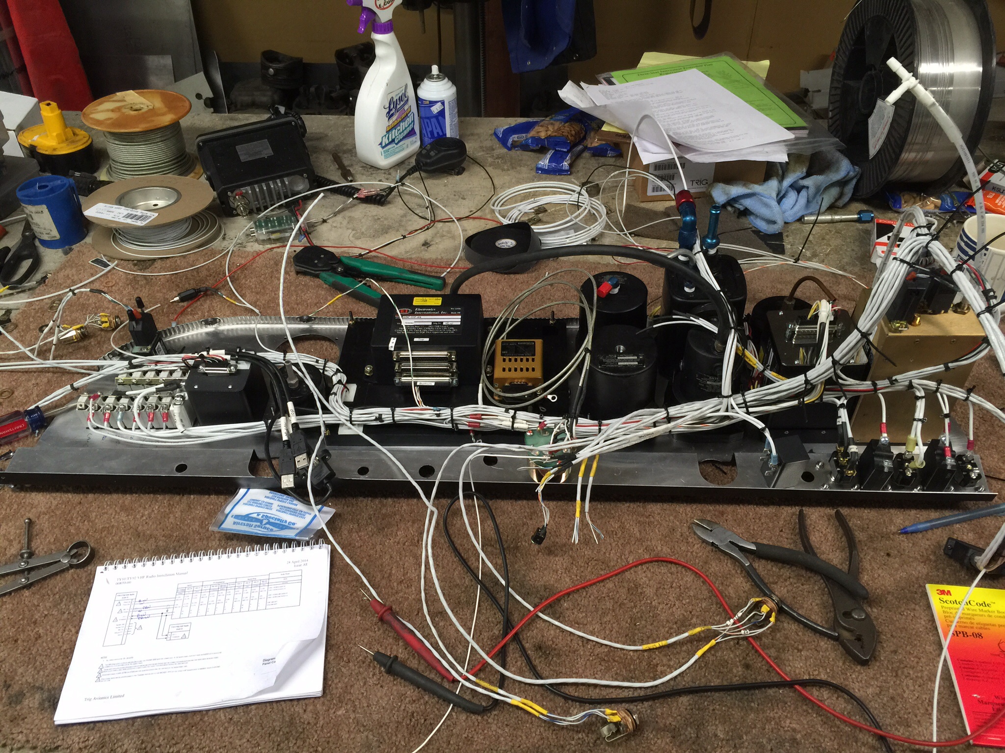

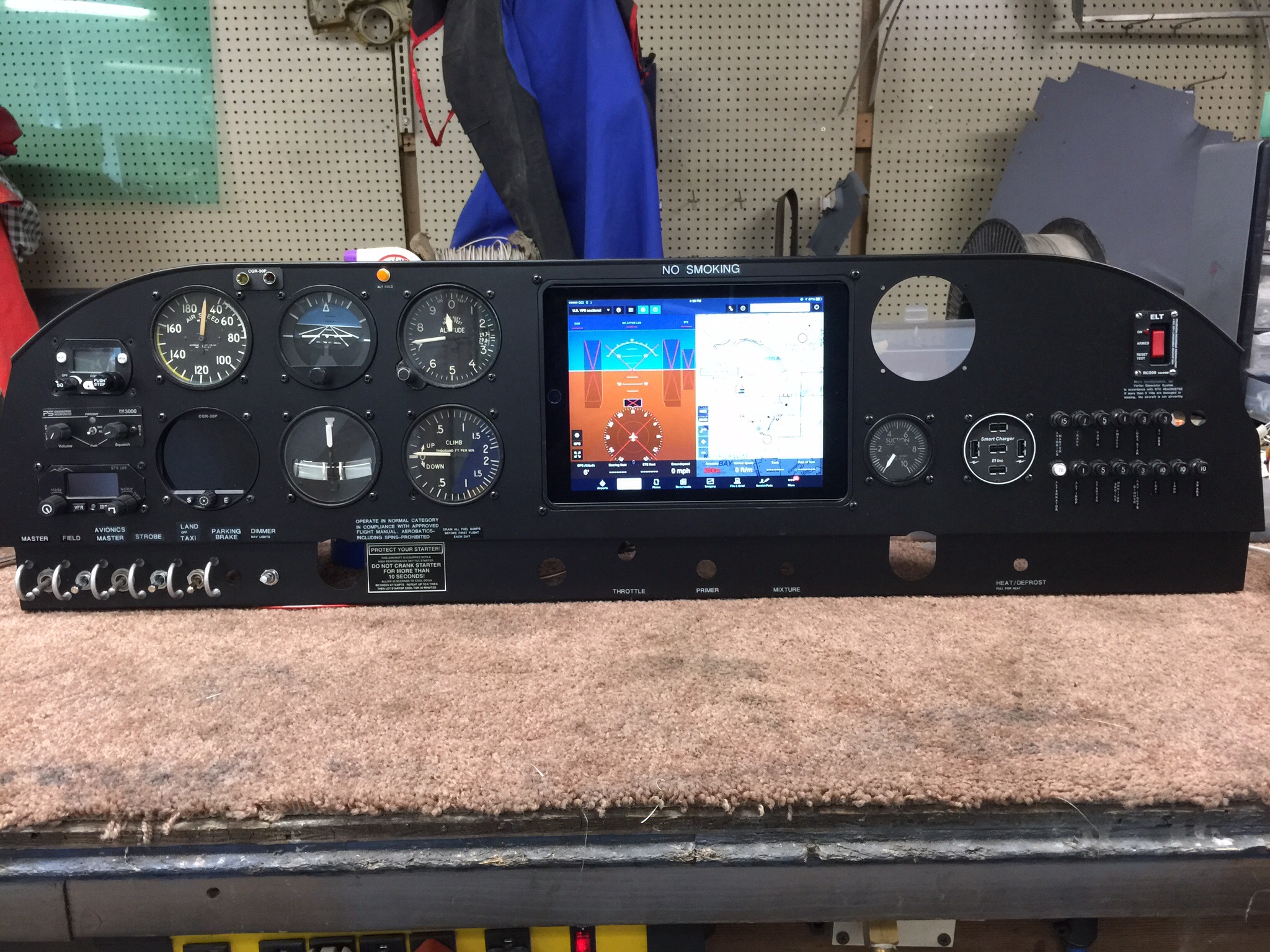

Progress as of yesterday. Remaining before installing the panel are the jacks for the PM3000, 2ea 1 amp shunt breakers, connecting the power supply to the Trig radio and PM3000

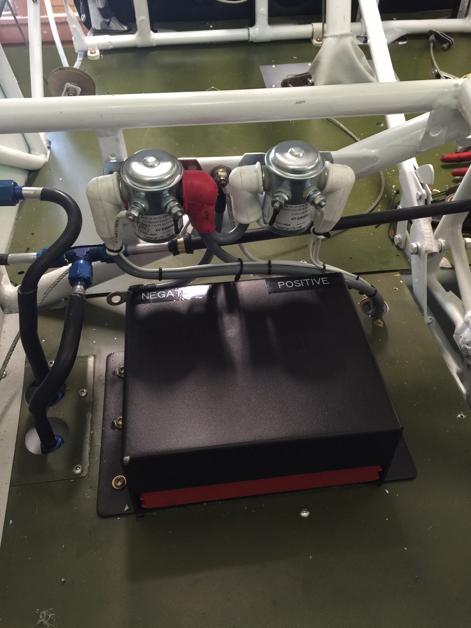

Battery mount.
http://forums.matronics.com/viewtopic.php?p=443859#443859
http://forums.matronics.com//files/image_438.jpg
http://forums.matronics.com//files/image_347.jpg
Hmmmm . . . looks like your project has already
passed many opportunities for considered decisions.
When you published your diagram, I mistakenly
assumed you were in the planning stages . . .
Getting back to your original diagram, what
questions are as yet unresolved?
Bob . . . [quote][b]

Battery mount.
What are the functions of the two contactors?

The two solenoids are Lamar. One continuous duty. Is closed at the panel's master switch by completing the ground. The other is intermittent duty and is for the starter.
Those particular starter contactors have poor
track records. They feature low pressure mating
surfaces . . . they're a slightly modified version
of the continuous duty contactor . . . we tried them
at Cessna in the 60's . . . pain in the arse . . .
Starter contactor right next to the battery contactor?
Forgive me, I thought we were at the planning stages.
The drawing you offered was not a wiring diagram but
a rough architecture . . . not unlike the Z-figures
in the book. Building a wiring diagram around an
architecture drawing takes some time, conversation
and thought. The wire book with understanding gleaned
from a team of guys who have been there done that goes
a long way toward putting grins on your flying-fuzz when
they sign off on your rebuild. You were already at the
top of the ski jump . . . a bit late to be getting input
from the coaches.
