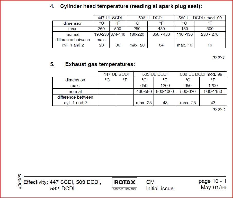

I don't seem to be able to copy the page out of the two stroke manual, but MAX EGT is 1200F.  Normal EGT is 860F to 1000F.  That is on page 10-1.
MAX CHT is 500F.  Normal is 374-446F.
Seems to me if you operate the 447 at 1200F and have your warning light set at 1225F, you will be well over the red line before you know it.  I cannot remember how far downstream the EGT probe is located, but it is a significant distance from the edge of the exhaust port.  Seems to me, as an uneducated hobbyist, the exhaust will be cooler at the probe.
Again, ultralight instruments are far from precision instruments.
I did pretty good with my two stroke engines flying them as they were set up at the factory.  The idea is to prop to the engine, not tune the engine to the prop.  Most two stroke engine failures are the result of operators chasing their tail, trying to reinvent the wheel.
Here's the URL for the Rotax Two Stroke Manual.  I assume it is the current version:
http://www.rotax-aircraft-engines.com/portaldata/5/dokus/d04495.pdf

Ah-Ha!  Good find John. Thanks for the link.
My manual is older, and has this info:
I will be downloading and using the new version from here on out. EIS limits will be adjusted down to 1200°. It is also interesting to see that it is acceptable to be in the high 800’s in normal operation. My understanding was that it should be at least 1000°.
Strange, I had asked this question at OSH specifically since it was not in my manual. Based on the higher CHT temps, the slightly higher 1250° EGT seemed to be in line that the 447 ran slightly hotter than the 503.  HMM, makes me wonder about other things said there……
Most of the time I am seeing 1150 – 1190, but on a couple of occasions I have seen it spike into the 1200+ range, which I quickly got out of by changing throttle settings or adding “choke�.
While I don’t think any damage was done, there certainly is no reason to push destructive temperatures.
The probe bosses were welded in by Rotax. I don’t remember the dimensions off the top of my head, but I did measure to see that they matched the instructions of where to drill if there were no bosses.
If memory serves me the hot spot may well be farther downstream than the port opening itself.  From welding class days the hot spot of the flame is not at the tip but at the point of the lighter blue flame in the middle. Since I can’t see inside the exhaust, I can only imagine that this MAY be the case.
I am going to read this updated version to see what other changes there were.  That may shed more light on what steps to take next.

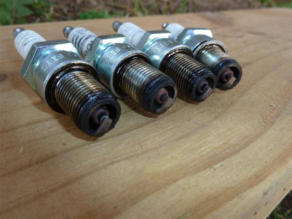

PostPosted: Mon Apr 27, 2015 6:53 pm    Post subject: Re: Firefly/447 RPM question Reply with quote
[quote="John Hauck"]<snip>
The idea is to prop to the engine, not tune the engine to the prop.  Most two stroke engine failures are the result of operators chasing their tail, trying to reinvent the wheel. <snip>
This. Jet it the way the book says, and then fiddle with the prop pitch until the numbers are happy. Did a 150 hour carbon cleanout of the 582 top end last week, flew Friday, climbout turning 6300, EGT 1,000. Cruising at 5,300 to 5,600 rpm gave consistent matching EGT's of 1050 to 1100. No problem with high EGT's on descent because you adjust the throttle a bit and they stay around 1000. Checked the plugs after landing, they are a medium brown.
Hope to fly again tomorrow with a passenger, will give an update and maybe a photo of the plugs. The plugs verify if the temperatures are acceptable, and if the EGT is close to accurate. From then on, the EGT gauge is mostly to warn you anomalies.

PostPosted: Mon Apr 27, 2015 7:27 pm    Post subject: Firefly/447 RPM question Reply with quote
Shouldn't the plug check be done at the power setting that you want to
check, e.g., cruise, WOT, etc?
If the plugs are checked after landing and taxi back to the hanger, does
that not give you an indication for low speed, low power settings?
I have always heard that, but years ago when I was building dirt bikes - 2 stroke - I would check the plugs after a plain "ride," and then do a run at a specific speed or load to check the jetting, and I couldn't see the difference. Perhaps an expert with a magnifying glass could, but in my laymans experience, the plugs sort of were what they were. For instance, putting in brand new plugs, going out and doing a test, and then pulling them and looking at them, there was not enough accumulation to tell much of anything.
Maybe I was just doing something wrong, or maybe I am missing something. I would be glad to hear from somebody who is actually real good at that particular skill.

Richard Pike
Posts: 1671
PostPosted: Tue Apr 28, 2015 4:55 pm    Post subject: Re: Firefly/447 RPM question Reply with quote
OK, had a good flying day today. Temp when we started flying was low 60's. MKIII Classic, 582, 2 people, 1(at)200 lbs, 1(at)185. Full throttle climbout, 6300 rpm, 50 mph, EGT 1000. Water temp constant at 140 in all situations.
Cruise 1075-1100 EGT, stayed very constant, no appreciable variability. RPM varies 5500-5900. (Lots of lift & sink across the low hills) Airspeed averaged 65.
Temp later in the day 70, no change in any of the above numbers, airspeed on final approach at a couple different strips was 60, EGT 1000 (at) 3000-3800 rpm. I fly cruise airspeed until time to throttle back, dump the flaps, and reset the trim.
Final numbers, 1.5 hours total, 7 gallons used. Last landing of the day before I took the pictures had time on final of probably less than a minute at 3-4k rpm, burst of power on short final. Landing, turning around and taxiing to the hangar took probably around a minute and a half, was at a low rpm, EGT was at 900. Pulled the plugs and took several pictures, this one is the most accurate in terms of how they actually looked. Interestingly, the plugs at the PTO end were lighter and more reddish, the ones at the mag end were a bit darker and more grey.
Numbering from left to right, #1 is closest to the mag. #2 is also mag end cylinder, but closer to the PTO end, #3 is the PTO side cylinder, mag end, and #4 is PTO side cylinder, PTO end. Have no idea why the difference.
Not sure that this establishes any sort of jetting/load/EGT/spark plug doctrine or proves anything, I just found this whole topic interesting and wanted to pursue it. Maybe it will be food for thought, and as Beauford says: worth what ya paid for it.
