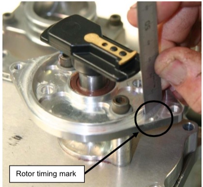

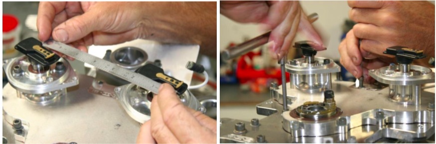

The rotors don’t look parallel to each other when they are in the correct position. See pictures.
You can see this without taking it all apart again look from left side of engine with dizzy caps out of the way.
With the engine at 25 deg BTC the rotor arms 'leading edge' of the metal bit must be in line with the timing marks.
See ruler against mark in the not very well taken picture.
Not the middle of the metal tab but the leading edge. right in the picture I think, might be left, move the engine to see which way the rotors move forward.

<![if !supportLists]>5. <![endif]>Set the distributor shafts so that the rotor points to the timing mark on the distributor base.

Pete, middle left or right side of rotor?, metal bit is about 10mm wide, what does ‘points' at mean ?
'so the rotor points to the timing mark'

5. Set the distributor shafts so that the rotor points to the timing mark on the distributor base.You will most likely have to remove the flywheel anyway as you will have to lift the gearcase cover to change the distributor alignment. Lifting the cover will break the Loctite 515 seal so you will have to reapply the Loctite. If you remove the flywheel:

It does not matter.

I used a Honda Coil on the right side and the Rotec E-Mag on the left.
The engine started but ran very, very rough and sounded like it was out of time. It also would not run with the choke off nor would it take the throttle. We used fresh 100 LL and took the bowl off the carb and made sure we had plenty of fuel flow with the elec. boost pump.
The engine would start easily but ran very rough and would not take the throttle even after warm up. Outside temp was 72 F. deg.
Going to either one mag made no difference in how the engine ran although you could hear a little drop in RPM.
Can anyone offer a solution. I sure do not want to remove the engine and flywheel and start over. Could I be a tooth off on the distributors??

Many thanks to Pete and Clive for the helpful info about timing the 3300.
I did the 7 tooth test as described by Pete and both rotors were in parallel with the trailing edge aligned with the timing marks on the distributor support.
So I do not believe I will have to re-do the timing.

I will drop off one of my Dizzy caps and look at the timing marks and the rotor arm. I remember posing the question to myself but can’t remember what the answer was. I found the manual (Jem 001) unclear and the photo’s weren’t either.
I did have one apart a month or so ago so should have taken more notice. The accuracy of the timing is from the magnets passing the coils of course which I’m sure is why Pete said it doesn’t matter.
Remember though, the arms aren’t parallel with each other. They are almost but not truly parallel, recheck the picture in Jem-001. They are in the same position relative to each timing mark though.
