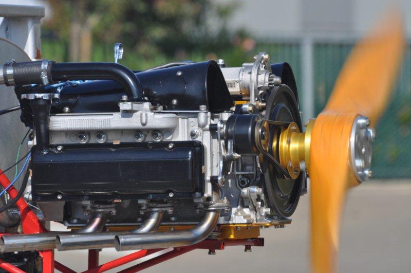

How does frontal area of the Corvair compare with the 912?
sfrIII
Joined: 09 Jun 2013
Posts: 10
PostPosted: Sun Feb 22, 2015 3:51 pm    Post subject: MK III Engine Options Reply with quote
Hi John,
I found this photo of a running Corvair on a Peitenpol.
I don't think it is any larger than the 912.
Thanks, Sam

Samuel, William Wynn is the defacto expert on the Corvair engine, is he not? His web site lists the all up wet flying weight of the Corvair at somewhere between 212 to 225 lb. That is not 30 lb. more than the Rotax 912, that's 62 to 75 lb.I worked on a MkIIIX for a customer and shaved every pound possible off the aircraft and couldn't get the weight below 620 lb and it was powered by a 582-99 that's over 100 lb. lighter than the weight listed by Mr. Wynn.
Rick

Your absolutely correct.    In  revue of William's site, I found
that my comparison should have been with a VW installation.
I guess the girl friend will have to ride in the nose cone!!
Sorry about that,
Sam
