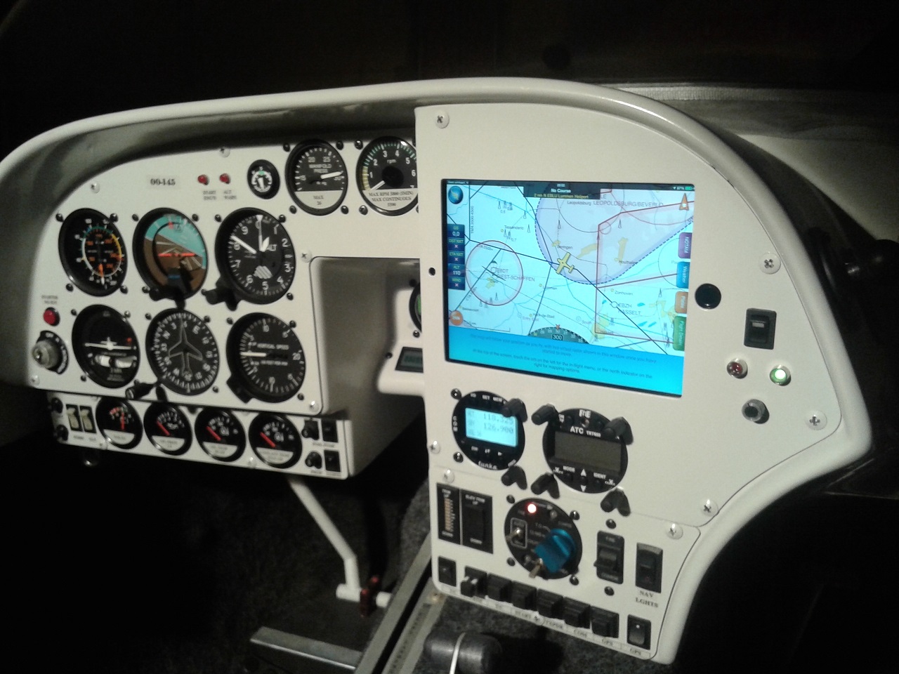

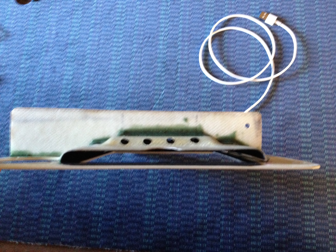

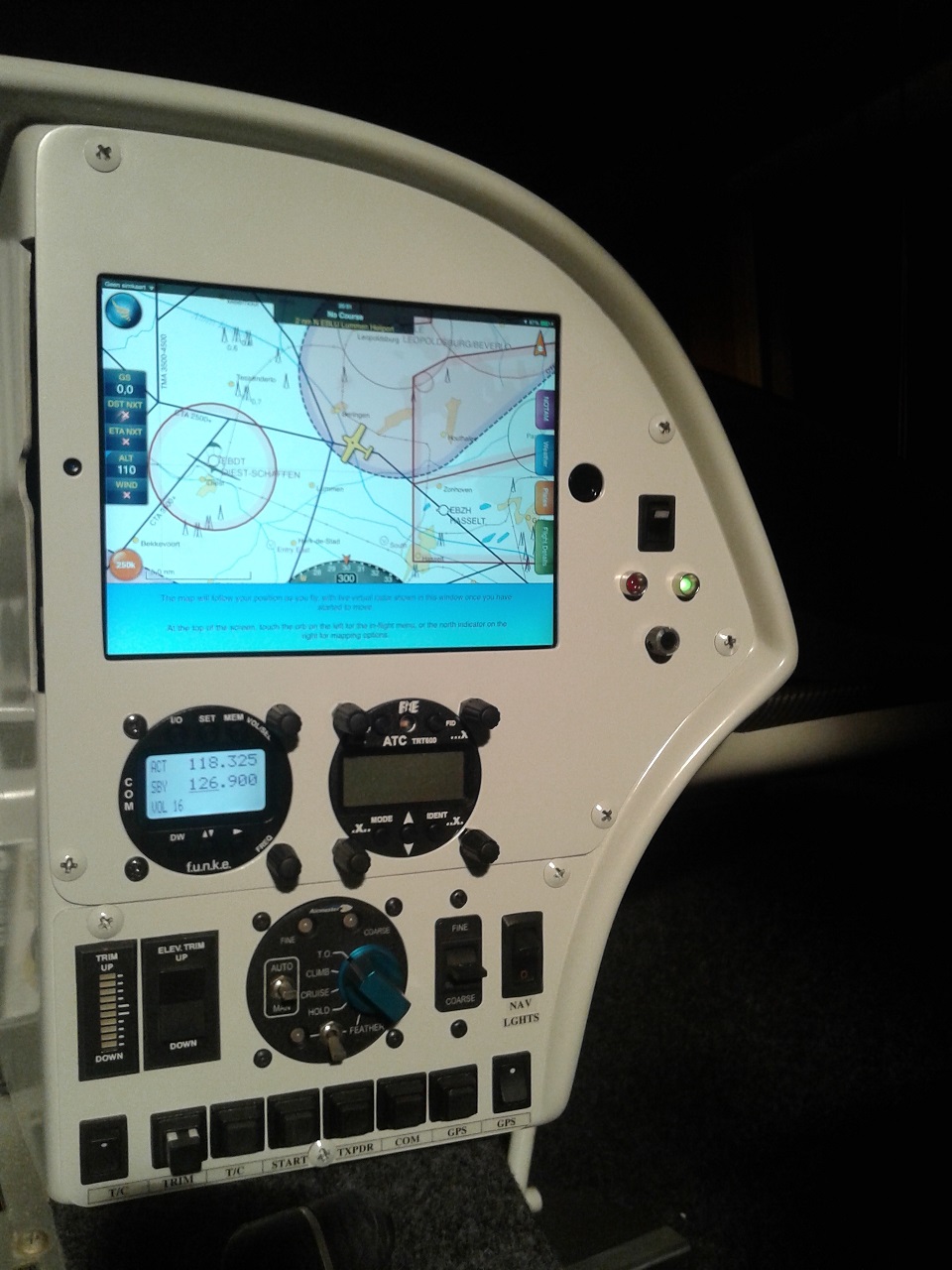

Hello all,

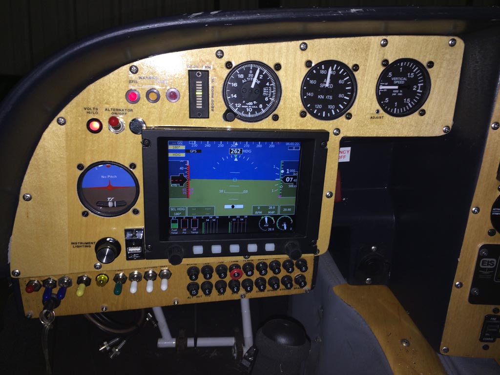

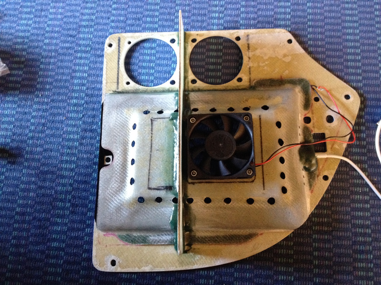

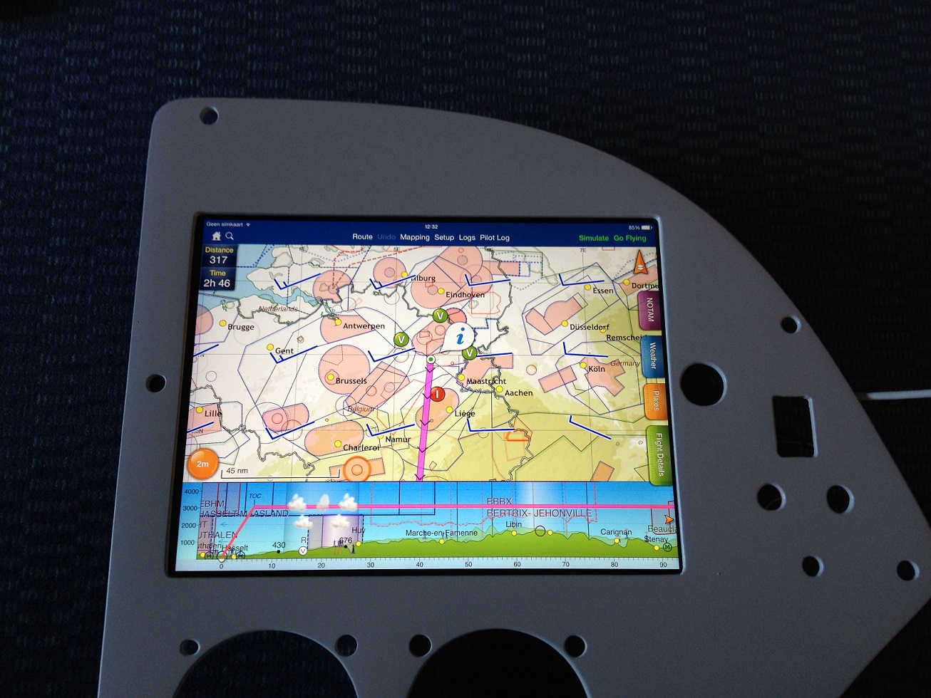

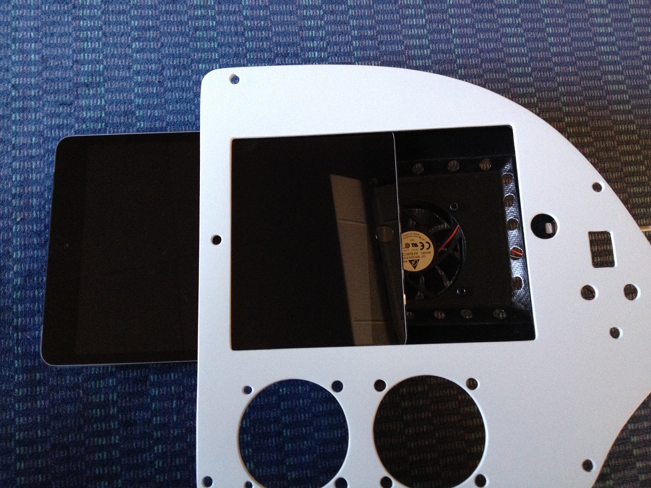

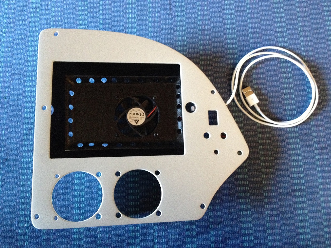

Just wanted to share some pictures of the outstanding work that Dirk Oyen, the builder of OO-145, did by integrating an ipad mini in his panel. A new left panel fiberglass made in which you just slide in the ipad mini.
On top of that, a dedicated converter takes the ipad lightning connector digital audio information and transforms it to analog in order to enter the aux input of the Funke ATR833 radio.
So Skydemon as moving map and the ipad music player as entertainment source. The cable on the pictures is the original one without audio interface.
Have fun, Jacques

Hi Jacques,
Great job! How can we reproduce it?

PostPosted: Thu Feb 05, 2015 10:33 am    Post subject: Re: Integrating an ipad mini in the panel Reply with quote
Very Nice Job.
How is the GPS Reception into the Ipad?
I found mounting the Ipad similar to yours, that the GPS reception was poor. To get over the poor reception I had to use a bluetooth GPS receiver.
Another problem I had was powering the Ipad. The plug into the 12V power outlet (cigarette lighter socket) Different units produced static interference over the head set. I could not find one that did not cause a problem. I would be interested in knowing how you have got over the problem and what interface you used for powering your Ipad.
Your work looks very neat. Any information you may want to share would be very gratefully received.

PostPosted: Thu Feb 05, 2015 1:01 pm    Post subject: Integrating an ipad mini in the panel Reply with quote
Hi Jaques,
Nice panel; interesting to see that the trim switch has been installed so that the operation matches the position indicator - ie.,'up' against 'up' - contrary to the manual. I've turned my switch around as well and it's certainly more instinctive, and hence safer for me, than the original configuration.
Kind Regards

PostPosted: Thu Feb 05, 2015 3:23 pm    Post subject: Re: Integrating an ipad mini in the panel Reply with quote
Hello Richard, the Funke ATR833 is very sensitive to interferences (EMC) and so we had to go for an expensive TomTom 12V to high power USB adapter.
Is your panel metal or fiberglass that you had GPS issues? This one is fiberglass for not blocking GPS signal.
If you want more infos, you can send me a private message to receive Dirk's e-mail.

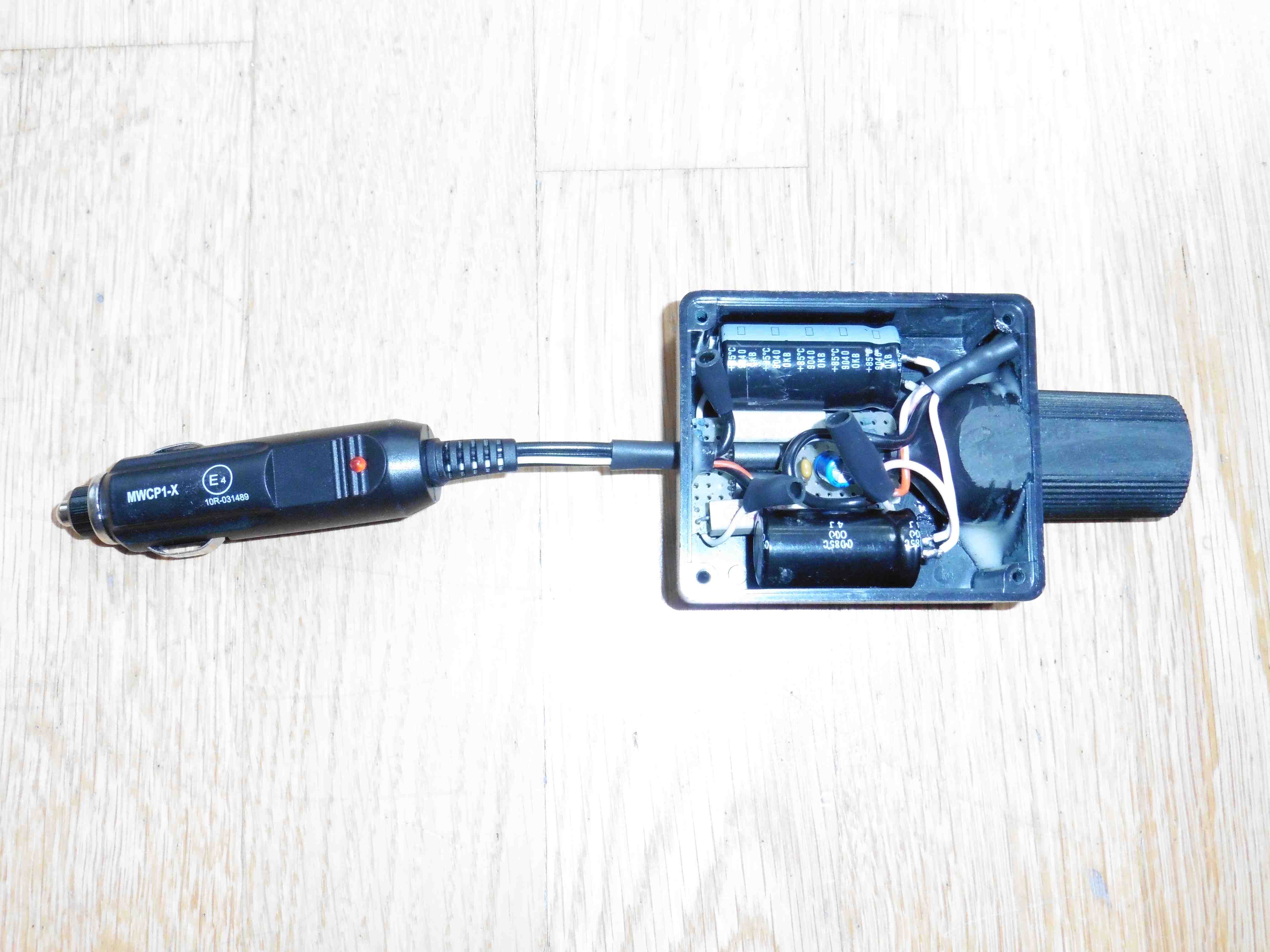

I have had a lot of interferences from the iPad power cable, especially at the lower radio frequencies, typically 121 MHz and below. My friend and Europa builder Denis Mangeot designed and provided a filtering circuitry which, after many hours of testing and modifying, finally solved the problem. Attached is a picture of the final version of this filter. I do not have a circuit diagram and component list available right now but I could work at it if anyone is interested.
Remi

After many attempts I have found a charger which was clean enough to not cause interference for my radios, but I still definitely would be very interested in a schematic and parts list if possible.
