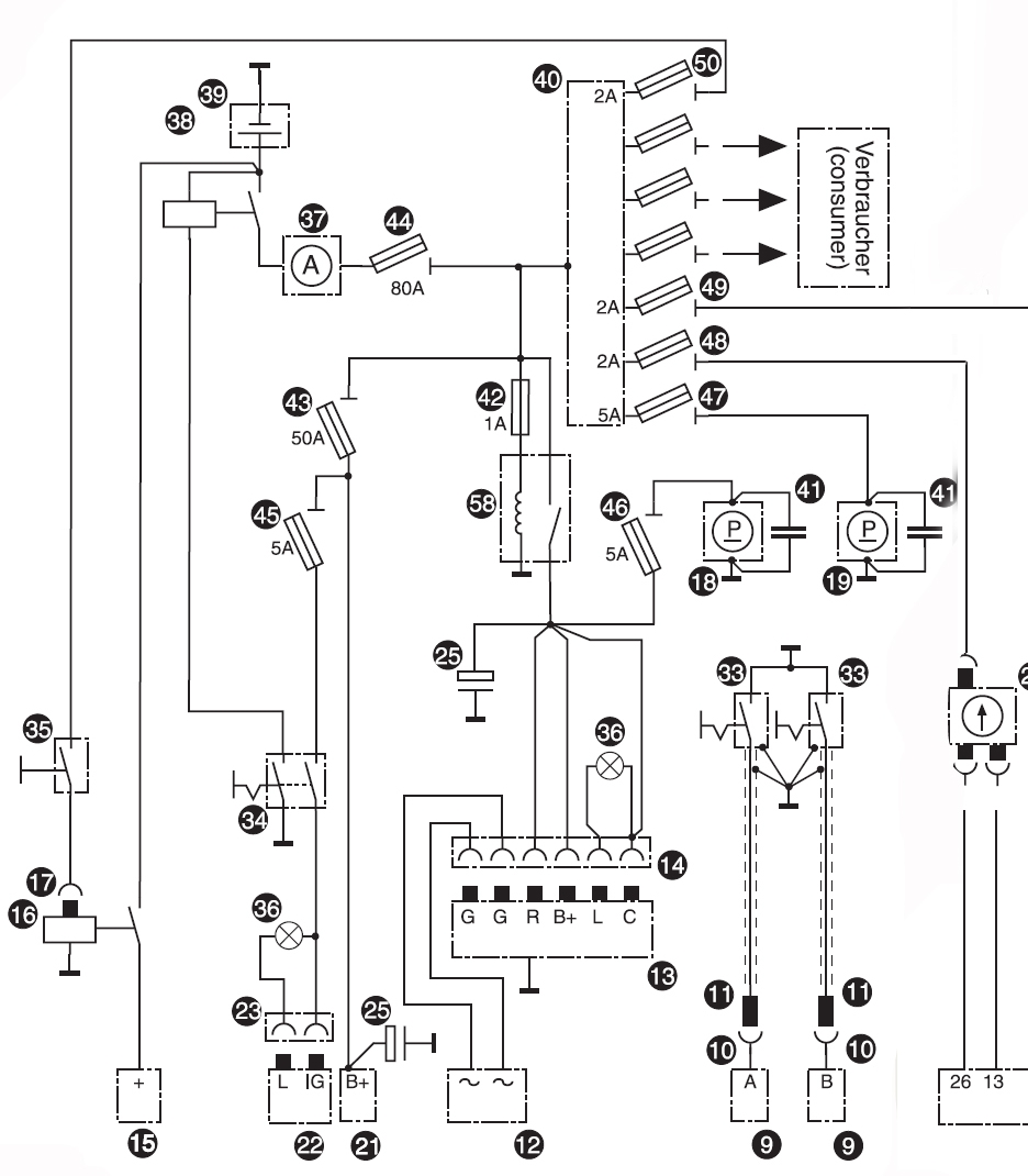

Rick, It's the wiring diagram from the Installation Manual for the 914.

Thanks Bob. I do have the book. I am building a Just Aircraft SuperSTOL. A previous lister said that the IG wire from the external alternator needs to be disconnected to avoid drawing down the battery, which it is on the Rotax diagram (via the master switch). Are you saying that you disagree with this and that the IG wired does not need to be disconnected to avoid drawing down the battery?
  Ooops . . . sorry 'bout that.  We're talking about the wound-field
  alternator . . . not the PM machine. That light doesn't work with much more
  intelligence than that annunciator on the PM rectifier/regulator.
  It's definitely dark when the alternator is working but may
  not light when the alternator is inadequate to system
  needs. I don't use those outputs either.
  If you're planning on ACTIVE NOTIFICATION OF LOW VOLTS then
  you can simply leave the light off the panel and leave the
  terminal disconnected.
  But you're correct, when wired per the Rotax drawing, IG gets
  disconnected when the big-alternator switch is OFF . . . so if
  you plan to use the light, wired as shown eliminates the
  concern.
  An interesting feature of their wiring gives you no control
  over the little alternator . . . it is automatically switched
  ON via relay (5Cool with an unnecessary, 1A fuse in the coil
  lead. This relay closes as soon as you turn on the master
  switch and will stay closed as long as the engine is running
  even if battery relay (3Cool is opened.  Bringing engine
  rpm down will slowly drop voltage on the bus . . . and
  might cause the little-alternator relay to drop but
  this raises all kinds of questions about the behaviors
  of the ship's accessories.
  The relay will certainly drop after the engine is shut
  down.
  Another interesting feature uses the little-alternator
  output to power up one of two fuel pumps whether or not
  the master switch is ON.
  The 80A breaker is, in US TC aircraft philosophy, not
  necessary or useful.

Rick,
I will be incorporating Robert Paisley's Bus Manager, along with two lithium batteries, and am trying to figure out how the Rotax wiring diagram relates to that. Info on Bus Manager can be found here if interested: http://flyefii.com/bus_manager/Bus_Manager_Installation_Instructions.pdf

At 03:12 PM 11/26/2014, you wrote:
Rick,
I will be incorporating Robert Paisley's Bus Manager, along with two lithium batteries, and am trying to figure out how the Rotax wiring diagram relates to that. Info on Bus Manager can be found here if interested:Â http://flyefii.com/bus_manager/Bus_Manager_Installation_Instructions.pdf
That's a LOT of hardware for what would otherwise be
a simple system.
What are your anticipated missions that would benefit
from dual batteries and the automation offered by
the Bus Manager? Your continuous loads are minimal.
Even the 3.2A value for the radio is probably more like
0.2A receive, 3.2A transmit . . . which pushes its
energy requirements down to insignificant . . . about
1/4th power it takes to keep one battery contactor
closed.
How, and under what circumstances, would dual batteries
mitigate perceived risks for the operation of your
system?

Being in Alaska, many landings are remote, off airport. The engine must start. If it doesn't the only option is to trigger search and rescue. Two batteries mitigates the risk of the engine not starting 150 miles from the nearest civilization.
 How, and under what circumstances, would dual batteries   mitigate perceived risks for the operation of your  system?
Okay, how often has the 'unavailable battery' syndrome
presented itself . . . and what was root cause for the
failure?
A battery can and should be the single most reliable
source of energy on your airplane. This presumes, of
course, that you give it the same level of attention
to airworthiness that is bestowed upon fuel, oil, tires,
continuity of flight controls, fuel filters and sumps,
prop blade nicks, etc. etc.
Batteries tend to be the oft neglected step-child
of flight systems. The predominant public perception
of battery consumerism is to run it until it wont
crank the engine any more . . . Walmart sells
a gizillion batteries every year that are replaced
in response to that same symptom.
Some years ago I corresponded with a Cessna 206
floatplane owner in S. America who was wanting to add a
second battery to his ship. We pondered useful volume
to exploit for several exchanges of e-mails. We
finally decided that inside one of the floats was
the best location. The battery could be positioned
right on C.G. and it occupied volume that had
no other purpose.
After we had corresponded a few times, he agreed
that his REAL worry was for loss of a battery contactor.
He conceded that in the grand scheme of things,
battery maintenance was not a big adder to cost-of-
ownership, his big worry was for loss of battery
contactor that would make the battery unavailable.
I suggested then than he add a piece of welding cable
to run from downstream side of battery contactor to
the battery box (accessible while standing on a
float). Should preflight testing before tossing
the mooring lines showed that the battery contactor was
"iffy", he could make a manual connection to the
battery (+) terminal with the short jumper.
He decided that was a much less expensive, lighter
and lower cost plan-C for dealing with a failed
battery contactor. We also discussed simply carrying
a spare contactor and tools . . . but that didn't
cover the potential loss of wiring and/or battery
master switch. So he opted for the jumper-cable
and a pair of pliers.

Well, having flown for 20 yrs in Alaska, I would take starter motor
failure as a higher risk than battery failure. Adding electronic
ignition to a plane in that environment IMHO adds risk over a dead
simple pair of magnetos. Most of time there is a means to hand prop if
lack of battery presents itself. Needing electrons to fire the ignition
as well as crank the engine creates more potential risk.
failure?

I also fly in Alaska. I agree that a battery failure isn’t as likely as a starter failure, but if having two batteries on the aircraft is an acceptable risk mitigation step for him, then he is justified having the extra battery. I will have two alternators. One gear driven and one belt driven. I will also carry a battery jump starter pack and a solar cell that is capable of charging it when I plan on spending any time in the bush. I understand the added weight of the pack, however after using it just a single time, it will have been worth it. If my starter does die and the battery still has at least 6 volts (EFII system minimum), the ignition and injection systems will still operate, making hand propping much easier than a healthy magneto. I will still need enough voltage to excite the alternator for continued 12v operation. One pass of the flywheel magnets past the crank trigger should start the engine.
I disagree with the statement that electronic ignition adds risk. There are many reasons.
1st reason is the massive amount of time electric ignition has been in operation. Nearly every vehicle manufactured since the mid 70s has electronic ignition, meaning there are MANY MANY more hours of operation on electronic ignition units than magnetos. They have been proven VERY reliable and need very little maintenance.
2nd reason is there are solid state units that require no moving parts (crank trigger systems). It is true that there are different electric systems out there, however they all run on the same principal. There are also redundant systems available that can keep the engine running in the extremely unlikely event that one fails. Choose the one that is satisfactory to you and go with it.
3rd reason that electronic ignition doesn’t add risk is the complexity and unreliability of magnetos. They have moving parts that wear. They have TBOs on them because they are known to wear and malfunction. They are heavy, expensive, and do not provide the same amount of energy that an electronic ignition does. I have personally had 3 magneto failures. Thankfully both have never quit on me at once. A good friend in a Maule M4 just had one fail last week.
4th reason is the correct 12v system architecture that electronic ignition requires is very reliable. The Z-diagrams that Bob has authored have the capability to mitigate most risk involved with the 12v system. I have personally chosen to go with a dual alternator system. I will carry small light solar panels that can recharge a battery in a matter of days.
There is a good compromise out there. Look at the G3i ignition system. It adds an MSD electronic ignition box and runs it through the magneto (if you feel that you MUST have the unreliable mags). If the MSD box fails or if the battery dies, the magnetos will still act like magnetos.
The thing to keep in mind regardless of how many batteries that you have on the aircraft is watching your battery health. If your battery or batteries show any sign of ill health, replace them. Don’t push it. Batteries seldom fail overnight. Some people even replace them every annual.
I feel that a properly installed and maintained redundant electronic ignition system will actually REDUCE the risk that the legacy magneto systems offer.
> The point to ponder is how best to accommodate or
> modify a system that is a direct descendant from
> systems common to garden tractors: PM alternator,
> simple rectifier/regulator and a lead acid battery.
> It seems that the elegant design goal is to craft
> a combination of architecture, preventive maintenance\
> and operating procedures that accommodates low risk failures
> -OR- drives specific failure rates down to insignificance.
> I believe this can be achieved without adding the
> weight, cost or complexity of burdening a
> garden-tractor-style electrical system with
> concepts holy-watered by the FAA and embraced
> by Boeing and Airbus.
> This requires a simple but thorough thought
> process that goes through the steps of considering
> EVERY part of your electrical system from crimped
> terminals to alternators and batteries.
> How can this part fail?
> Is failure pre-flight detectable?
> If it fails in flight, how will I know about
> it?
> How would in-flight failure affect comfortable
> termination of flight?
> What are the lowest cost, lightest weight,
> simplest mitigations for the failure?
> Due diligence to Failure Mode Effects Analysis
> (FMEA) offers the short-path to the simpler,
> lightest weight, lowest cost, lowest risk
> (elegant) design easily understood and managed by the
> cognizant pilot.
> Bob . . .
> _blank">www.aeroelectric.com
> .com" target="_blank">www.buildersbooks.com
> ="_blank">www.homebuilthelp.com
> ="_blank">www.mypilotstore.com
> ank">www.mrrace.com
> _blank">http://www.matronics.com/contribution
> ist" target="_blank">http://www.matronics.com/Navigator?AeroElectric-List
> tp://forums.matronics.com

Well, I had two electronic ignitions stone cold fail in Alaska. One at
40 below. The other in summer, but just as inconvenient. You don't hear
about the failures much because they just pull over to roadside and call
a tow truck. Typically when they fail it is a hard failure, not just
rough running like a mag on its way out. I may install electronic in
place of one mag, but definitely not two.
Respectfully,
Justin
> On Nov 27, 2014, at 11:10 AM, Kelly McMullen <kellym(at)aviating.com> wrote:
> Well, having flown for 20 yrs in Alaska, I would take starter motor failure as a higher risk than battery failure. Adding electronic ignition to a plane in that environment IMHO adds risk over a dead simple pair of magnetos. Most of time there is a means to hand prop if lack of battery presents itself. Needing electrons to fire the ignition as well as crank the engine creates more potential risk.
> On 11/27/2014 12:32 PM, Ken Ryan wrote:
>> An argument can be made both for and against the second battery. I have considered both and determined that in my case the extra battery is justified. Your points are nevertheless well taken.
>> On Nov 27, 2014 10:54 AM, "Robert L. Nuckolls, III" <nuckolls.bob(at)aeroelectric.com <mailto:nuckolls.bob(at)aeroelectric.com>> wrote:
>> failure?
>> no other purpose.
>> it?
>> cognizant pilot.
>> Bob . . .
>> ank">www.mrrace.com

Nothing that we do in aviation, experimental aviation especially, is without risk. It is merely a game of acceptable risk. For me, having 2 independent and completely redundant electronic ignition units provides an acceptable level of risk. This is because there isn’t a single point of failure in the system. I feel that the benefit of having both electronic units is the added performance of an adaptable timing curve and a much hotter spark. Others, such as yourself, feel comfortable with one electronic unit and one magneto. Both are correct because the system meets the designer’s acceptable amount of risk and both for different reasons.
Cheers
Justin
On Nov 27, 2014, at 12:15 PM, Kelly McMullen <kellym(at)aviating.com> wrote:
Well, I had two electronic ignitions stone cold fail in Alaska. One at 40 below. The other in summer, but just as inconvenient. You don't hear about the failures much because they just pull over to roadside and call a tow truck. Typically when they fail it is a hard failure, not just rough running like a mag on its way out. I may install electronic in place of one mag, but definitely not two.
> Respectfully,
> Justin
>>> failure?
>>> no other purpose.

At 09:52 2014-11-11, you wrote:
The Rotax 914 wiring diagram shows an integrated generator with
external regulator-rectifier and an external alternator with built
in regulator. It looks like the integrated generator is disconnected
from the battery (by relay) when the master is off but the external
alternator remains connected. The text indicates the integrated
generator will run the battery down if not disconnected, but does
not say that for the external alternator. Does this make sense?
Sure. The alternators on ALL vehicles are controlled
to a quiescent state when not in use. They present no
load on the battery. Wire per Rotax instructions and
it has a 99.99% probability of functioning as they
intended.
