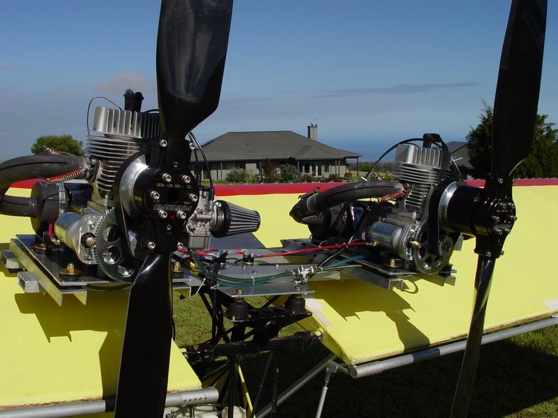

Several months back, I posted my intention to install two Hirth F-33 engines on my Firestar 2. The design goal was to end up with an aircraft that could at least maintain altitude on one engine and get to a landing spot if one of the engines failed. The main issues I anticipated were vibration and the possible interaction of the overlapped propellers. The engines were mounted on two struts that were secured to a flat plate that was mounted on the original Lord engine mounts. In turn, the engines were flat plate mounted on their own set of mounts.
The right engine uses a prop extender to put the 53 inch Powerfin two blade prop 4 inches behind the left engine prop and allow the overlap. Each engine is mounted 16 ½ inches from the aircraft center line, and each propeller clears the aileron on its side by several inches. The whole installation including the mounting system (excluding battery) weighs almost exactly the same as the Rotax 503.
The interaction of the two propellers crossing each other in opposite directions at the overlap was pretty much a gamble. I couldn’t find any information whether or not it would work. In the early 80’s, I had the chance to do some thrust tests on the twin engine setup of the “Para Plane� powered parachute. The Para Plane installation was very well designed with two small single cylinder (Solo, if I remember correctly) engines mounted on both sides of a central set of concentric prop shafts. The engines were connected to each shaft with a belt drive, and the props counter-rotated several inches apart. We wanted to find out if the two counter-rotating props would affect each other at various RPM’s of the two engines. Interestingly enough, there was no measurable affect. With both engines running at full RPM, the thrust (150 lb) was twice that of when one engine (75 lb) was run alone. With that knowledge in my pocket, I figured overlapping props crossing in opposite directions would probably not interact appreciably.
It took several months of part time work to get the mounts set up and the throttles/choke, fuel system, and electrical system set up. When all that was complete, I tied the Firestar securely, and started and broke in the engines. I had some jetting issues because of being at 5,000 feet density altitude. Matt Dandar, the owner of Recreational Power Engineering (where I purchased the F-33’s) gave me good technical support, and I got the engines running quite well. With a spring scale tied to the tail wheel area, each engine measured about 150 lbs of static thrust when run alone. The vibration level was about what you would expect from a single cylinder engine – not unreasonable at all. However, when both engines were run together at high RPM, the thrust was only a little over 200 pounds, and the vibration level was high. It appeared that the area where the props overlapped and crossed was too turbulent for the props to work efficiently.
I had to wait several weeks for the local winds to drop below 10 mph, but finally had several days with light winds. I trailered the Firestar to the Waimea Airport, which has almost a mile of paved runway. My grass strip at home is only 700 feet long, and is not ideal for testing a modification of this magnitude. Takeoff confirmed the static thrust test info. The thrust was not nearly equal to the Rotax 503, and it should have been greater. I climbed to a couple of thousand feet above the airport and alternately put one engine to idle, and the other to full throttle. The yaw was easily controlled with rudder and I could just maintain level flight. Vibration was about the same as with the Rotax 503.
With both engines anywhere above 4,500 RPM, the vibration was severe enough that eventually something on the plane would fail. I did a touch and go, and a full stop and called it a day. The experiment was a failure, and I really don’t see that there is much I can do to fix it. I think it would work if the engines could be moved far enough apart to eliminate the propeller overlap, but that would require bigger struts (more weight and drag). Also, the aileron gap would have to be extended (shorter ailerons) to provide sufficient clearance for the props.
I hate to post the details of a failed experiment for the world to pick apart, but believe it is good to get the info in the archives in case someone else in the future has the same idea. I think it could be made to work with a concentric shaft counter-rotating setup like the Para Plane, but I don’t have the machine shop resources available to build it. Guess I’ll remount the Rotax 503 and go fly. Mine has never missed a beat, and hopefully will continue in that mode. In the meantime, I’m looking at the HKS 700E.
As a footnote, the Hirth F-33 engines are beautifully engineered packages, and I’m in no way being critical of them. They are good engines, and Matt Dandar of RPE backs up and supports his product. They would be my first choice as a light weight compact package for a single place trike, powered parachute, or other Part 103 legal ultralight.

Dave,
Thanks for posting your report. I found it very interesting and appreciate your pioneering resourcefulness.

In a message dated 6/27/2006 10:29:36 A.M. Eastern Standard Time, rp3420(at)freescale.com writes:

Hi Bill, Dave/All
I think Bill is onto something: having the props
counter-rotate would have the props pass,moving in the
same direction with respect to the individual blades.
Said another way, if the issue is the coverage of the
two blades, in the current config, with one descending
and one ascending causing a turbulent cavitation
‘zone’ then counter-rotating blades would smooth that
zone providing thrust in the zone where they cross.
Some two strokes can be set to run either way, but
must be supported by the manufacturer since there can
be many gotcha’s that could cause trouble—not readily
apparent to the us pilots. Hirth engines tend to be
robust, straight forward designs, so if any two-stroke
will run the other way, I would expect a Hirth to.
The final issue is the belt drive; the belt AND
sprockets must be able to transmit the HP going the
other way. Again I would check with your engine
vendor.
Naturally you will need to somehow swap/reconfigure
the blades the make thrust the other way.
I suspect you might be able to solve this interesting
issue, please keep us posted whatever you decide.
Your efforts have made for some of the more
interesting posts I have seen in awhile, thanks.
Jim Clayton
California
Mark-3X, 912ULS.....Building
www.quantumwrench.com/Kolb.htm
Why go to all that trouble.
_____________
|--O O---|
_____________
The above represents two engines, back-to-back on the
mounting plate with the counter-rotating shafts mounted below
the crankcases.
other way
Not a problem...see above.

Thanks for all the positive feedback and brainstorming. Here's my take on two of the ideas presented:
Turning one engine around and using belt drives to drive concentric drive shafts to counter-rotating props is an elegant solution, and I'm sure it would work. The thing that bothers me about this method goes back to the original design criterion, that being to fly on one engine when the other "craps" out. If one of those belts fails (and they do), it would most likely go through both of the counter-rotating props and take them both out. Perhaps the belts could be enclosed or guarded somehow.
Changing the prop direction on one engine by reversing the engine might cut the interferance. You would have to modify the timing plate inside the flywheel so the ignition advance would be correct for the change in rotation. Right now, the sparks come at some number of degrees before top dead center, and if you just reversed the direction of rotation, the sparks would come at the same number of degrees after top dead center. The engine might run with that degree of retardation, but wouldn't have much power.
Every solution I can come up with seems to bring a whole new set of problems. I think I just have to look in the mirror and tell the guy there, "You blew a lot of work and money on that one - move on!"

Reversing the rotation on a two-stroke is not as simple as just
changing the ignition timing.
Sure, a two-stroke can be caused to run backwards but making equal
power in the opposite direction will require changing the cylinder
ports to the opposite side also.
Because normally the crankshaft acts as a rotator of the fuel/air
charge in the crankcase providing a supercharger effect to throw the
fuel/air charge towards the open intake port side of the cylinder.
Changing the rotation will cause the fuel/air charge to be thrown
towards the opposite side of the crankcase away from the intake port
side. This greatly hinders the ability of the engine to "breathe"
properly.

One more idea before you decide to throw in the towel - The Rotax A
drive gearbox relied on an adapter plate to mate the gearbox to the
engine. If you could mate a gearbox to the Hirth, then you would get
your prop turning the other way.
Or just substitute a Rotax 277 with gearbox for one of the Hirths? The
277 makes 28 hp.
(Easy for me to say, since you are the one spending the money...)
> Dave Bigelow
> Kamuela, Hawaii
> FS2, Rotax 503 DCDI

No - On the Kolblist website you can see he has two 28 hp engines
mounted side by side a couple feet apart. Replace one of the Hirth
engines with a geared Rotax 277, and then one prop turns one way, the
other prop turns the other. Or put a gearbox on one of the Hirths, and
then that prop turns the opposite direction from the other engine. (Belt
drive, the prop turns the same rotation as the engine, but with gearbox,
the prop turns opposite from engine rotation) He keeps his same basic
setup, but eliminates the problem caused by both props turning the same way.
> The 277 makes 28 hp.
Belts? Belts??? We doan need no steenking belts!!! Wonder
what the ratio of that big ring gear would be driving another
gear? A whole other set of problems now......backlash/chatter

Who says you have to mount the engines on top of the wings? The creator of the Kolb Flying Machine who has a bunch of multi-engine experience in ultralights always mounts his multi-engines below the wing. Must be a big reason why he does this.
Ed, may pay for you to spend a dime and call Homer and have a chat with him about multi-engines.
He may save you a bunch of grief and dollars

Great work, and kudos to you for it. I had the same idea for a 503 to F33 modification - but I have a slightly different idea. Since you have the F33's already in your possession, perhaps you might be interested in my idea?
Basically, the idea is to have the engines mounted 30" off center and use 28" props on the F33's using direct drive (no belts). This will admitedly result in less prop efficiency, but save the cost / liability / and maintenance of the belts while virtually removing cross-prop interaction since there will be a few inches between them - even with them mounted in-line!
This is similar to the lazair of many years ago, but in a pusher configuration.
Let me know if you are interested in trying this alternative, or perhaps interested in taking an offer for those F-33's???
