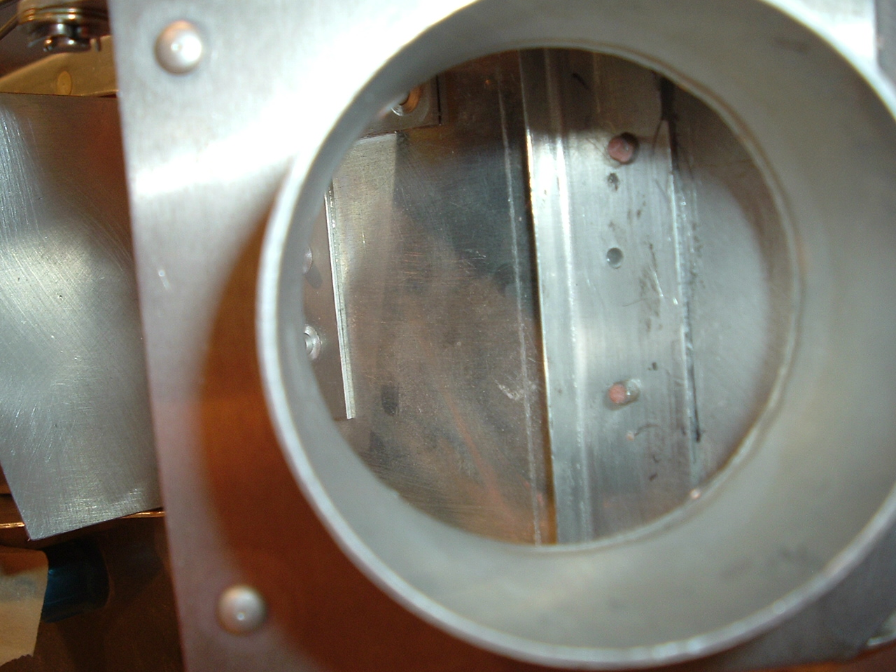

I wanted to pass on a suggestion for those looking to keep their RV 10 TUNNEL cool. Take your Black & Decker Wet vac and hook the hose to the blower/discharge air. Then place the hose over one of the heat vents on the firewall simulating hot air blowing into the cabin. Close the vents and see if air is still entering the cabin with the vents shut and the wet vac blowing air into the vent on the firewall side. What we discovered was alot of air was entering the OPPOSITE vent when both were closed. The air was coming in under the hinge on the vent door. When I placed a small aluminum divider between the air vents on the firewall the air ceased leaking into the cabin tunnel. After playing with a few DEFLECTOR designs, I used the inside mounting bolt on the vent box to hold a deflector in place and then also put an 1/8 inch deflector inside the vent box so air could not sneak under the front of the vent door. This should solve the problem with HOT air entering the Tunnel with the vents CLOSED. There still may be a Radiant heat problem but insulation on the firewall and tunnel floor and silicone between the firewall and vent box helps for Radiant heat.

This is exactly what I thought. I believe the discharge air from both valves (when in the closed position) leaks into the cabin because of the design of the valve. Your solution should work.
Also note in the latest RVator that Vans addresses the HTS (Hot Tunnel Syndrome).

Couple of things. The way the cabin heat boxes work is that they dump
the hot air from the exhaust muff overboard, at the cabin heat box, when
it is closed to the inside cabin. This is supposedly so the heat muff
and SCAT tube doesn't overheat. This effectively provides a nonstop
blast of hot air at the heat boxes and firewall. There is a few things
you can do for this:
1) Several people have reported good success with using a silicone
gasket between the heat box and the firewall providing a thermal break.
I also did this. You get a silicone gasket with AviaComps heater boxes
if you go that route. Most people I talk to think it's a bad idea for
Van's stock boxes to be made from aluminum which has opened up a nice
niche for SS boxes. I sent an email to Don at AviaComp today asking him
if he would make a left cabin heat box in addition to the right side one
he makes.
2) Use some sort of insulating barrier at the firewall, on the inside,
and also in the tunnel. This is recommended either way. I used a
ceramic paint additive to reduce radiated heat but I don't know how well
it will work yet.
3) Make sure that no air is sneaking in through the heat boxes. Recent
post on this.
4) As you said, ceramic coat the exhaust pipes. John Forsling is
selling pipes for the 540 on the RV-10 and they are ceramic coated,
produce more horses, and are only a couple hundred more than Vettermans.
Forsling and Vetterman used to work together and Forslings exhausts are
usually considered superior, at least by the people I have asked. If
you are at OSH you can see a set on my engine at Barretts booth. Keep
in mind that you will have lower performance from a heat muff with a
ceramic coated exhaust.
5) Something I'm thinking about is a way to mix cool air in at the
engine compartment. Normally I would suggest making a diverter to
bypass the heat muff, but I don't know if heat really is an issue at the
muff. I honestly don't see why it would be as the SCAT isn't going to
melt unless the muff is made out of aluminum.
