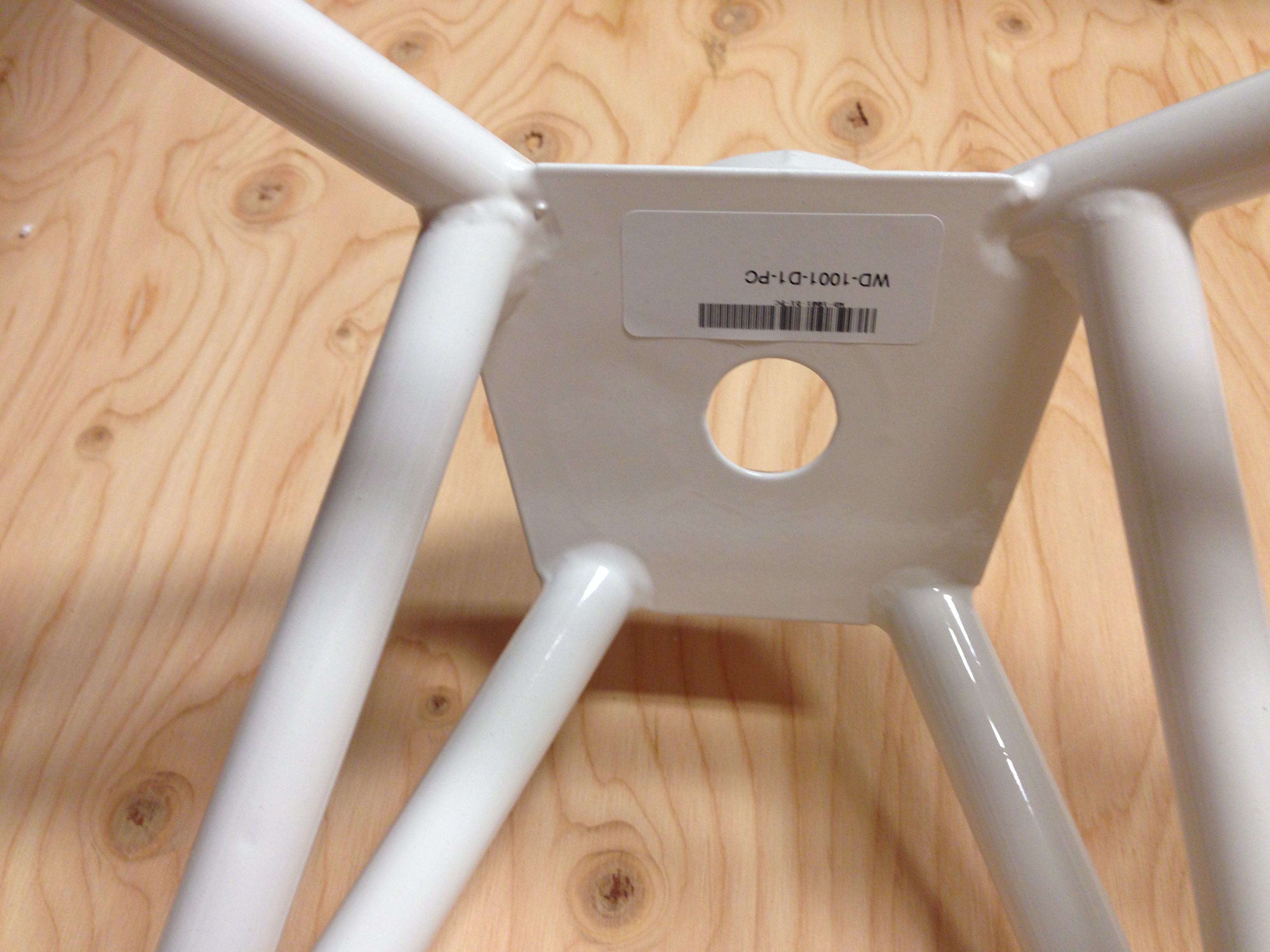

Since mine got destroyed when the nose gear leg weld failed, Here is what the new engine mount/ gear leg looks like:
  [img]cid:inlineImage0[/img]

gengrumpy
Joined: 07 May 2013
Posts: 131
Location: Tullahoma, TN
PostPosted: Mon Sep 22, 2014 12:50 pm    Post subject: SB Nose Wheel Report Reply with quote
Can you post pics of the weld failure?

PostPosted: Mon Sep 22, 2014 1:23 pm    Post subject: SB Nose Wheel Report Reply with quote
Thanks Danny,
so it looks like a doubler welde on or is the whole plate thicker?
Is there as well on the inside an additional ring or is that as before
(looking from the other side).
Cheers Werner
