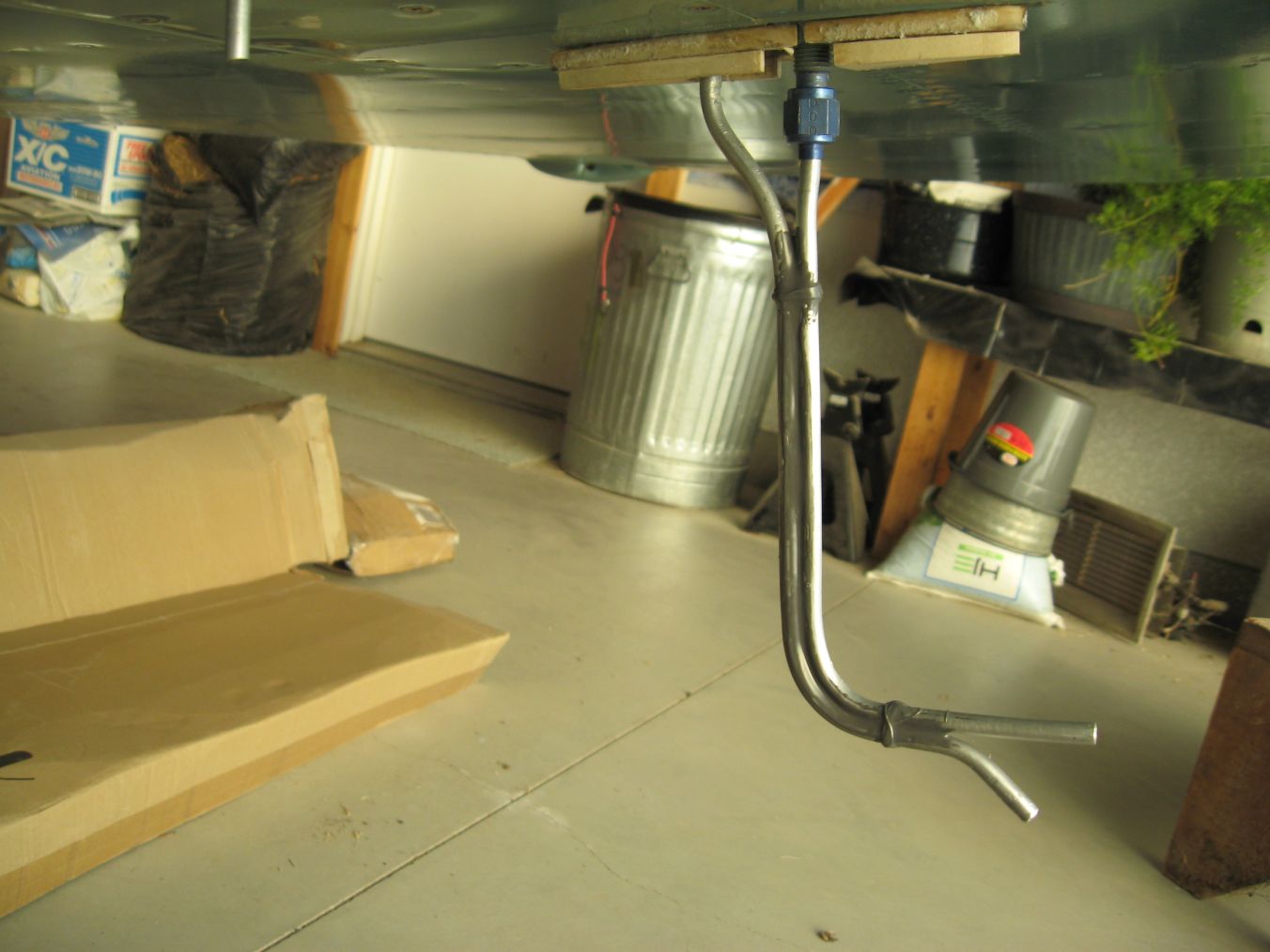

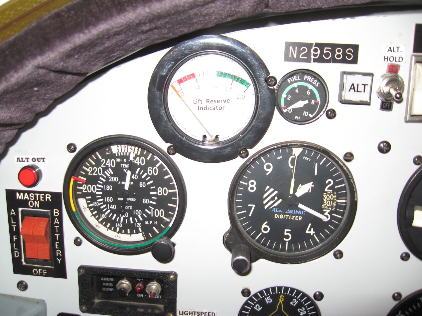

Russ, all, Somewhere in the archives should be an article I posted about
three years ago that a member of my EAA chapter wrote about the lift
reserve indicator he built for his RV. It was complete with the part no. of
the gauge he used and instructions on how to tune the two pitot tubes that
drive it.
Rick Girard

All, Time flies when you're having fun, right? The article I thought I'd posted about three years ago was actually posted last May. As Maxwell Smart said, "Sorry about that, chief."Anyway here's article and photos.
Rick

Richard
I'm interested in this AOA system but can't figure how to hook it up. The water column gauges I've seen on line have only one input so I'm baffled as to how they can measure a pressure differential.
mojavjoe

   Regarding that Lift Reserve Indicator that Rick shared, I did share it too, and I also built one that I can
detail the steps how I did it.  I have a OEM one, and made my own duplicate version.
   FYI for those thinking about making one for themselves;  the factory uses the Dwyer 0-2 inches of mercury
gage, but Dwyer makes an exact same version that lists the column in CCs.  I bought four and they are
the same model except it is marked metric rather archaic inches.  But, in any event, it doesn't
make any difference in the world what the markings are, all we care about in our uses is the scale from
zero to full.  Inches or CCs make no difference.  I'll find the model numbers of the ones I bought.

  About two plus years ago I shared with this list a home-made AOA indicator (I think) using a Hall Effect circuit, magnet and torpedo pointer looking thing.
  I know I shared with list the home-made "lift reserve" indicator.  I have one "store bought" model (made by LRI, Inc), and I also have one I made exactly like it myself.
  If anyone is interested, I'll dig through my files and see if I can post them again.
mojavjoe

  I am pretty sure I have the directions from my store-bought LRI.
When I have the time to respond to Russ, I'll look for it.
  Probably tomorrow morning.

Joe, The carb synchronizer that's used for Rotax two strokes has two hook ups. You can make one from 20 feet of 3/16" vinyl tubing and a 6' piece of 1 X 6 for less than $10. If you use water with red food coloring it reacts faster than using ATF.
Rick

Everybody,

PostPosted: Tue Aug 26, 2014 5:45 pm    Post subject: Angle of attack indicators... Reply with quote
AOA systems compare either pitot pressure or pressure in a port just aft and above the leading edge of the wing, to either a 2nd pitot input angled downward, or pressure in a port just aft and below the leading edge of the wing.
If you see a water column gauge with only one 'port', there's another somewhere on the device; you just can't put a hose on it. A differential pressure gauge will have 2 ports that you can access. Here's one
http://www.ebay.com/itm/230564187946?ssPageName=STRK:MEWAX:IT&_trksid=p3984.m1423.l2649
that some with cooling issues are using to compare plenum pressure to cowl pressure after the heat exchanger (or engine, for air cooled engines).
Download the links from the Aeroelectric site & you can see a couple of examples of pitot style dual ports. If you google the term, there is at least one commercial product for homebuilts that uses tiny holes drilled in the nose skin of a wing, just above and below the leading edge. These holes are plumbed to a differential pressure gauge with an analog display, and a tone generator that can be wired into the intercom.
