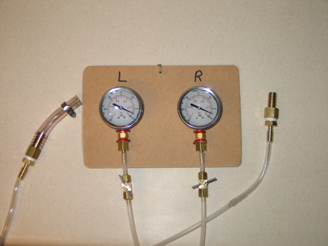

PostPosted: Sun Aug 24, 2014 5:09 am    Post subject: Re: rough running at 3400 RPM and above Reply with quote
Gauges are all over the market as some have pointed out. All you need is 2 vacuum gauges that go from 0 to 30 in. I prefer liquid filled gauges.Buy some vacuum tubing from the auto store or Ace Hardware )about 10'), buy two needle valves from Ace (install them about 6" from the gauges) and then buy a 3/8" barbed fitting and reducers to fit the small vacuum tube (sand off the barbs so it is smooth), then get a 6" piece of poly tubing to fit on the other vacuum tube.
When you sync the carbs push off the left or right side rubber hose that is on the carb balance tube. Now the carbs are separated. Then put the smooth brass end in the rubber hose and slide the poly hose over the 90 degree fitting on top of the air intake.
Start your engines!
p.s.
The clear hose in the picture is for demo and it should be regular vacuum hose.
With gauges like these you can diagnose many carb issues and balance is faster because you can instantly see which carb needs what. Once in a while simple is better.
If you really wanted a carb sync tool on steroids put these gauges inline with an electronic model and you could have both worlds at your finger tips, but would be a little bulky and you would still need to hook the electronic one to the battery. I have seen 1-2 like that.
- The Matronics RotaxEngines-List Email Forum -
http://www.matronics.com/Navigator?RotaxEngines-List
