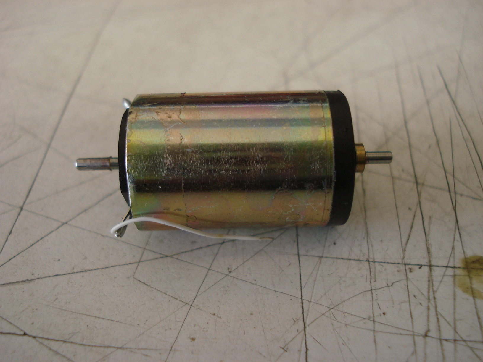

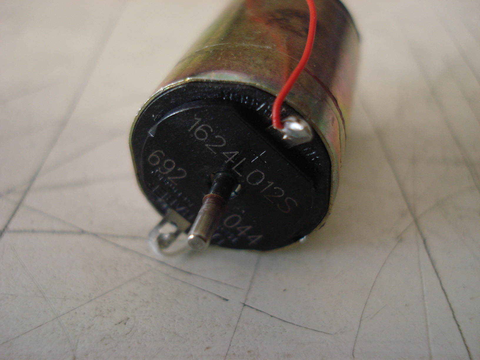

PostPosted: Mon Aug 18, 2014 4:47 pm    Post subject: Navaid AP-1 gyro motor Reply with quote
First, a couple of shots of the original motor Micromo 1624L012S692 044.
[img]cid:tie_8D1895D956477A4_23B8_27F77[/img]
[img]cid:tie_8D1895DF595B8D6_23B8_27FAD[/img]
So far the closest items to the original motor that I can track down easily are the following and my known criteria are:
12VDC
15,000 to 20,000 rpm
1620 to 1625 size (dia/bodyL)
double shaft 1.5mm dia or greater (to allow use of the original flywheels)12VDC
http://www.hollywoodfoundry.com/MHK1624.htm
http://www.hollywoodfoundry.com/MHK1620.htm
-GV

vanremog(at)aol.com
PostPosted: Fri Aug 22, 2014 6:37 pm    Post subject: Navaid AP-1 gyro motor Reply with quote
So, what I have found out is that the original motor from Micromo is no longer available. The closest thing to the original is their 1624T012S123-277. It differs from the original in the kind of grease used and the back shaft is 1mm shorter. George Hunt and Jani Glover at Micromo were very helpful in helping me nail down the details.
The replacement motor is $110 and was in stock. I should have it in a week or so and will advise whether I have the AP-1 working again or it and the new motor have gone off to Valhalla.
The challenge will be to install the .149" thick flywheel on the 4mm back shaft. I will rough up the shafts, apply some Loctite 271 and press the front flywheel on until flush then press the back flywheel on only .125" or so. Once that is done and I have reassembled the unit, balanced the gyro/motor/flywheel on its shaft and wired it up I should be good to go. It's not nearly as complex as the multilayer high density surface mounted defense boards I work on every day, but does require a steady hand, good soldering skills and a microscope. Hope for the best.
-GV
