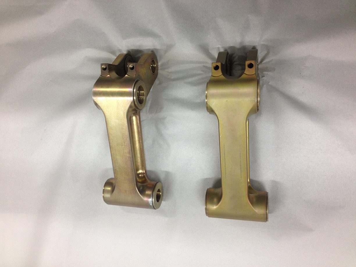

I would prefer to leave mine bare metal in colour to match the main gear leg, so I enquired about plating with a specialist (Precision Aircraft in Reading) and they advised:
"I have attached a photo of a cad finish so you can see what colour your part would look like when plated, cadmium is a white colour but is dipped in the olive drab passivation solution after plating and de-embrittlement. Your part would require stress relieving prior to cadmium plating 190-230°C for a minimum of 4 hours. After plating your part would require de-embrittlement which would be the same times and temperature as the stress relieve."
I don't much care for the resulting colour, so I may be forced to paint mine white - it is far enough away from the main leg not to jar on the eye and Dave J's doesn't look too bad after 14 years...
NB the attached picture is NOT what a TW spring looks like after cad plating!
