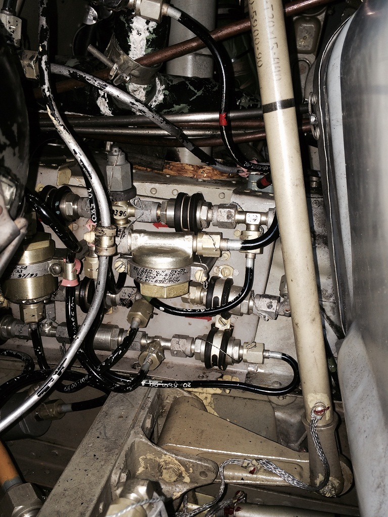

Is there someone who could help me identify the cause and cure for an air leak in my 18T.

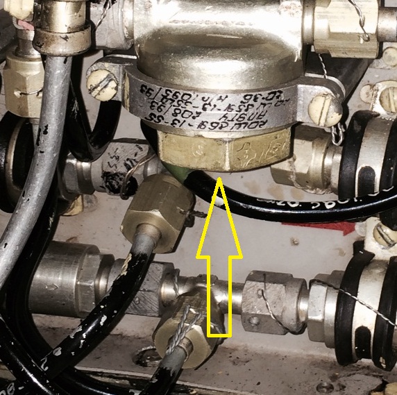

Ref attached picture, I have a constant air leak at the bottom of the unit shown with an arrow.
This part is located on the left side, inside the front inspection hatch
Once I shut the ‘main air’ this leak bleeds the ‘main air’ system in about 30 min. Emergency air is not affected.

A friend suggested that this unit should not normally have air pressure inside, unless the emergency air is opened, leading to
believe that the problem might be elsewhere, a leaking shuttle valve?

It looks like as the air valve that permit to send air from the emergency system.  This valve contains a spring that can be stucked by dust and rust.
You have to remove the part, unscrew the big cap and wash the inside with glycerine and alcohol. And the problem will be solve!

Looks like it's the 562300 protection valve (#12 bleeding down valve in attached PDF schematic - machine translated from Russian so make allowances for phrasing!).
This valve vents to atmosphere below 5 bar pressure and is used primarily to bleed down the emergency air system after use.
However it's secondary function is to vent small air leaks entering the emergency system from defective seals on either the gear up-locks or the adjacent non-return valve (NRV) emergency feed to the brakes (and flaps in the case of the -18T) .
If these get large enough (>5 bar) it shuts and the pressure build up will release the up-locks and slowly blows the gear down, which tends to get your attention!
In your case it appears whatever is leaking has yet to get to 5 bar so the protection valve is just venting it to the exterior (which you can hear).

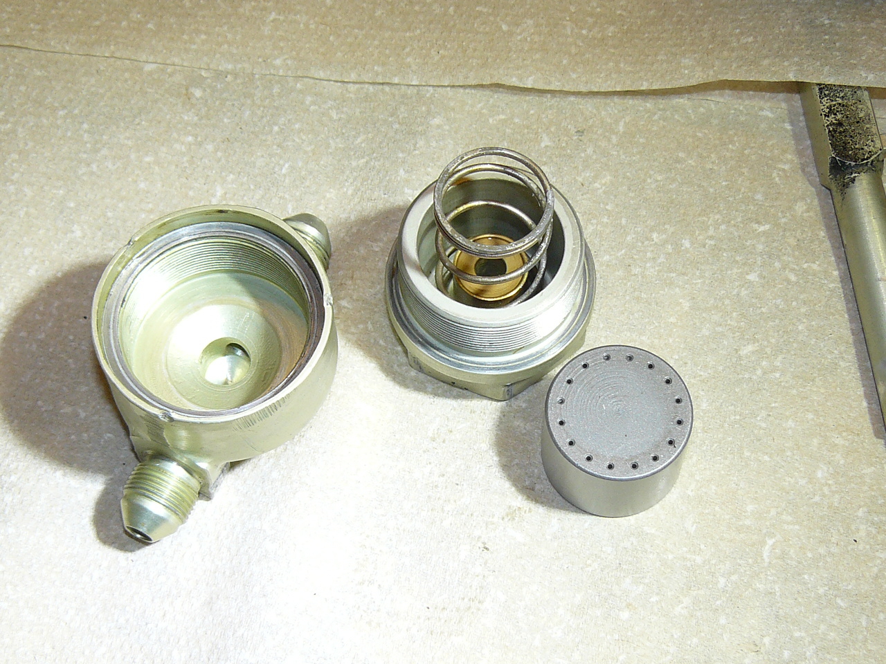

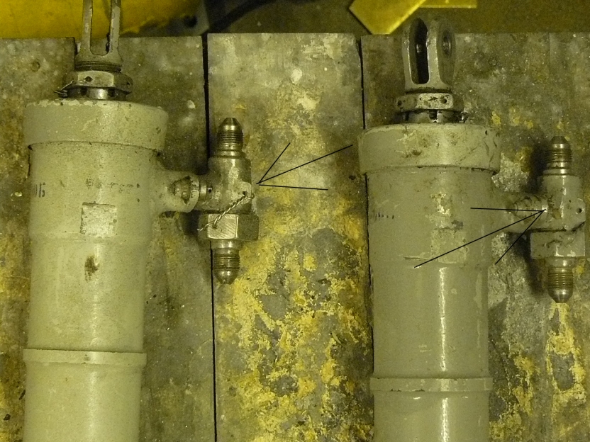

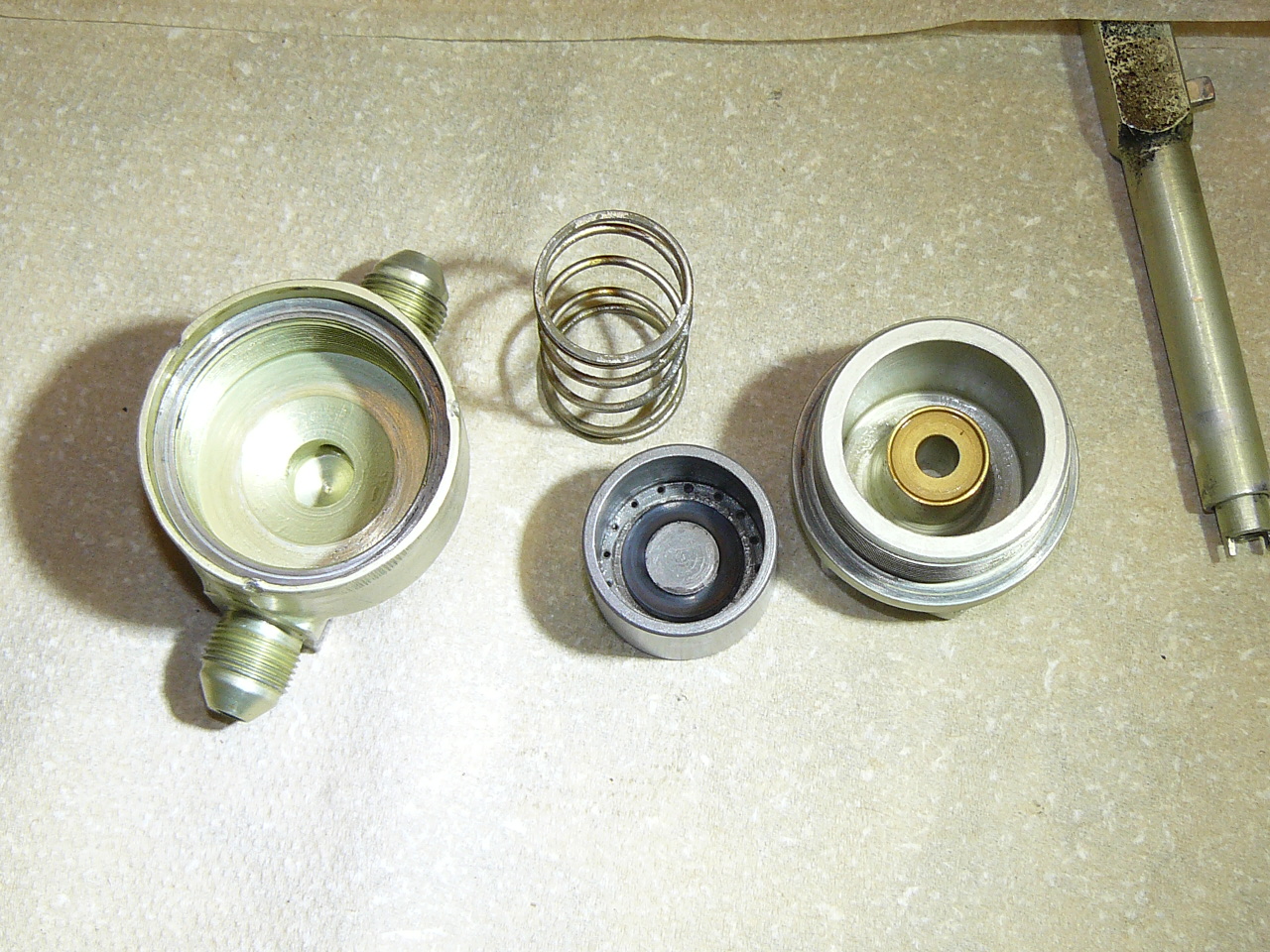

did you do an emergency l.g. extension recently ? Yes, I also believe the rubber balls in the actuator cylinders are deformed - standard condition, see arrows in picture. You may be able to exchange them on site, if blow gun is available. I added a few photos for assistance.
