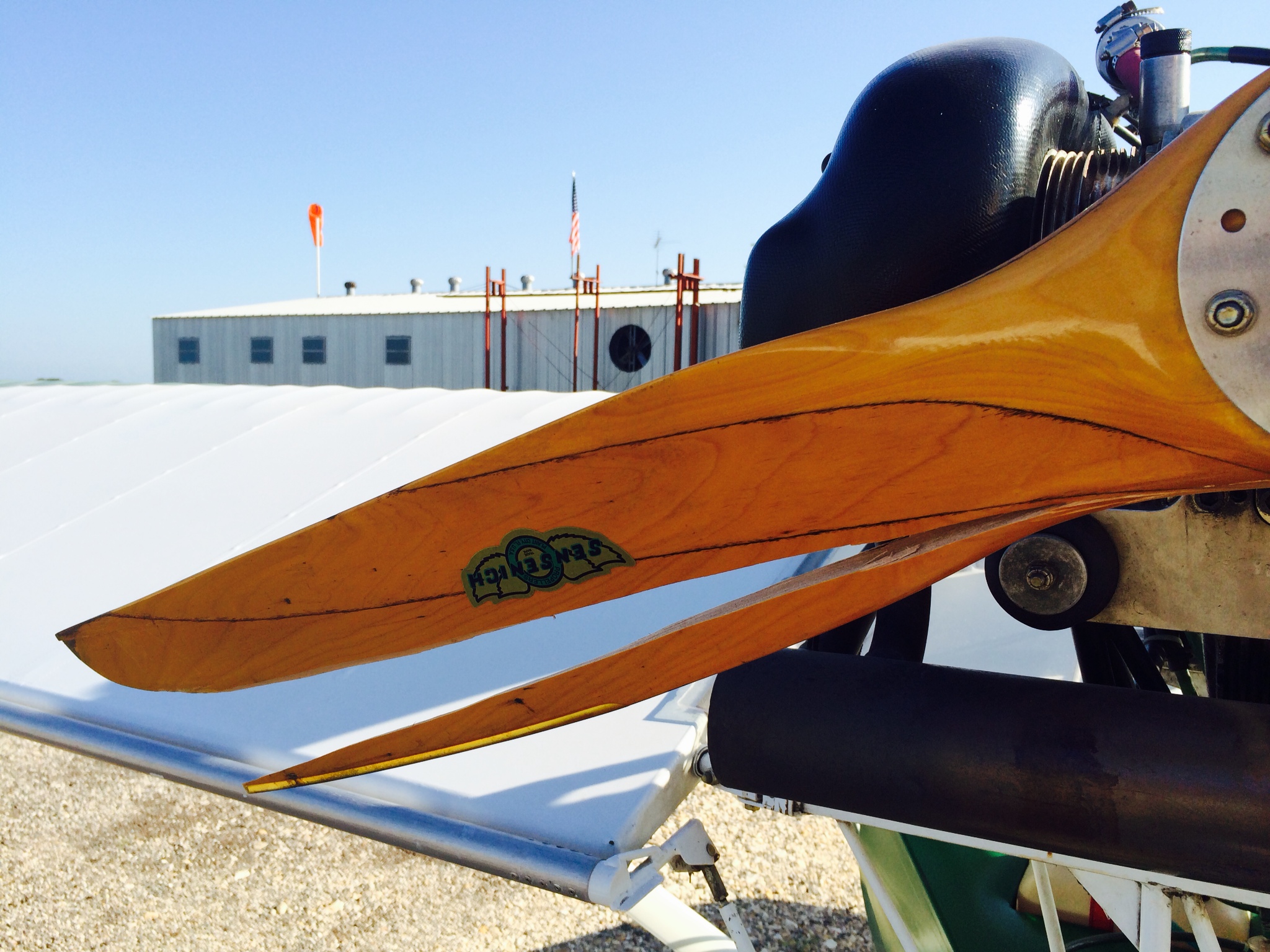

.Guys here's a picture of what can happen if you don't secure your fuel caps good.  This was a rather expensive lesson for me.  In the future I'm going to attach lanyards to my fuel caps.  While flying my plastic fuel cap came off and went through my Sensenich wooden prop on my Mark 3 Xtra.  I was lucky there was a grass strip near by.  Surprisingly the vibration wasn't too bad.  Had that chunk departed, it would have caused an unbalanced condition.  As it was, it just made a loud change in the prop noise.

You might want to consider a Warp Drive for your replacement prop. If you had one, you would have discovered you lost the fuel cap at your next re-fueling stop.

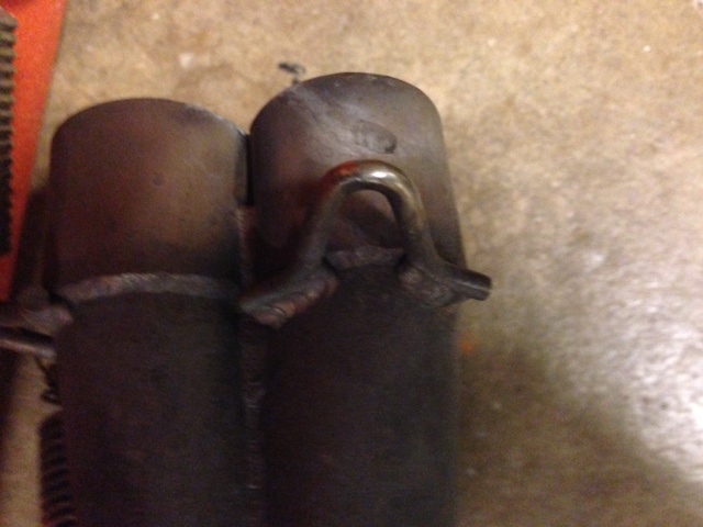

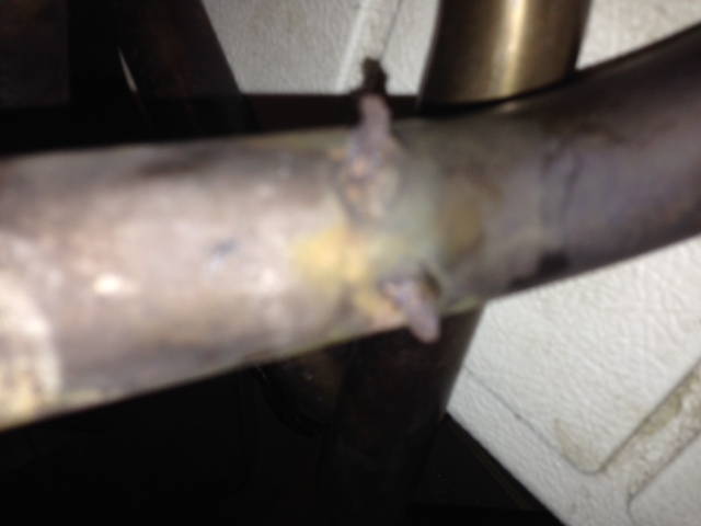

PostPosted: Sat Jul 12, 2014 11:40 am    Post subject: Re: Prop Strike Reply with quote
This must be the season for it. One of the exhaust spring hooks broke and the pieces of it went through my prop the other day. Safety wire on the spring held so only the pieces of the hook made the hit. A couple of flat places in the nickle leading edge were the only damage and I was able to re-shape those pretty well as directed on the Warp Drive website. I am replacing all the hooks on the front connection. The rear hooks look ok but all the front ones are corroded pretty badly.I think this is because the exhaust joint faces that direction and any exhaust leaking around it would hit those and accelerate the corrosion process. See attached pics of the good and that broken. Anyway it's something that might be worth checking. I know I'll pay more attention to that area from now on.

Ouch, that hurt!
Your lucky to be in one pice.

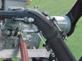

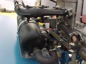

Richard Pike
Posts: 1671
PostPosted: Sun Jul 13, 2014 11:58 am    Post subject: Re: Prop Strike Reply with quote
Spring hooks? Broken springs? Damaged props? $15 and an afternoon of work and that problem goes away. Some 5/16" bolts, flat washers, cotter pins, some small compression springs, some large diameter muffler clamps from which you cut off the curvy little ends where the bolts go through and weld those pieces onto your exhaust. During your annual inspection check the bolts, they will probably have wear grooves in them about a 1/16" deep. That's why you start with 5/16". The pictures explain it all - sometimes overkill in this area is a good thing.
Also, notice the size of these 2 pictures: less than 50 kb each. The last several posts on the list of busted props, & trailers for sale have been pictures of 2 megabytes or more, and no "Do not archive" tags. So much for keeping the list archives at a manageable size... Shocked Not to mention how long large picture files take to download: my computer happily plays graphics intensive online games at nearly 100fps, but it still took a while to get those 2 meg files downloaded. In Windows 7 & 8, all you need to do is right click a .jpg picture file and tell it "resize;" problem solved. Wink
