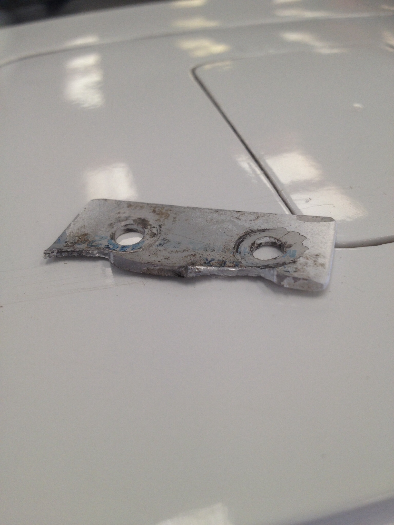

thanks for all your comments here is a pic of the front hinge ,its very thin but i am no expert ,i wonder if this did fail would the door coming off not damage the holes that the lock bars go into as the door ripped away as it took one hell of a chunk from the fuselage
 Filesize:  614.85 KB
 Viewed:  19722 Time(s)
Jim…and was that “chunk from the fuselage” adjacent to the front shoot bolt receptacle or the rear one? If we can assume that take off did not occur with NEITHER shoot bolts engaged, I would think therein lies the answer to whether or not the loss of door was initiated by improper engagement of one or the other shoot bolts…
In any event, you have my sympathies,
Fred

Talking of experts, have you spoken to Malcolm McBride at the LAA about
this. He could examine the hinge to determine if there was a pre-existing
crack that could have caused a failure.

If the door was correctly fitted to open freely and the strut positioned in
such a way that there was not effort on the hinge when fully open, then
there is no reason (not enough efforts) that this hinge breaks in flight
when the door is closed. So it broke when the door opened then departed.
I did fly with a crack on one hinge for month before I replaced it... and
it's the other door who departed because of the rear pin not correctly
engaged!

PostPosted: Thu Jul 03, 2014 3:08 am    Post subject: DOOR detached during flight Reply with quote
Where was the fuselage chunck removed from? Was it at one of the lock pin sockets?

PostPosted: Thu Jul 03, 2014 11:03 am    Post subject: Re: DOOR detached during flight Reply with quote
re chunk ,,, the chunk is near the top end of the rear of the door ,i have no idea how that happend

Can we just get one thing straight - the hinge did not break. The structure has torn away around the hinge due to a tear-out failure mode. The force generated by the door flying up means that almost any airworthy structure would have failed.
There is nothing wrong with the hinge design or manufacture. Build to the spec and ensure the pins are engaged and the system is 100% reliable.
Any changes to this area is deemed to be a mod and would need to be justified by a stress analysis and design submission to the LAA (in the UK).

PostPosted: Fri Jul 04, 2014 2:59 am    Post subject: DOOR detached during flight Reply with quote
John,
But is it not desirable that the hinges fail when the door opens in flight ? Rather than having the door flapping about and doing untold damage ?

PostPosted: Fri Jul 04, 2014 3:34 am    Post subject: DOOR detached during flight Reply with quote
Karl
it is desireable that the hinges let go, rather than tearing out half the side of the fuselage.
The force on a door behaving like a wing is considerable.

As Graham said, we do want the hinges to fail. The door tab may fail as well. You are right as usual Karl. Who cares about the door as long as it comes off and doesn't affect flight characteristics.
Any damage to the top of the aircraft, in my experience, is caused by grinding, or crushing the glass with the hardware, in the installation of the hinges. This is where the glass can get compromised. Some damage will always occur during a door detachment. Although I have seen poor layups in this area where there was only gelcoat holding one corner of the rebate in the hinge top. A couple layers of glass and a bit of filler fixes that during the build.
If built as per the manual with stronger hinges, you can count on a door that opens in flight, will really tear up the top attachment area. You'll be doing a much larger repair for sure. If many different knobs, straps, locks, hold down fixtures are attached to the door it will have more momentum and even more damage will occur.
If one builds the hinges as described and puts the hardware and washers as depicted (bed them in flox if you must due to the curves and such) and there are no manufacturing flaws, the door departs with only minimal damage to the hinge attach points. Usually it is fixable in a few hours then fill sand prime and paint.
The doors as designed will last many years without damage as proved on our oldest aircraft. If you damage your door while running up with the door open, it is your fault, not the doors. If you allow the door to flip open in gusty conditions, it is your fault. If you leave the door open on the ground because it is hot, and another plane blasts yours (like I did) it is your fault. If you have bad struts, replace them with new ones and do the mod 66 or alternate as on my website to save weight and eliminate the door lift problem. (I even contracted a US factory to build new struts exclusively for me and my clients. Metal fittings, fairly inexpensive, and I figure at five years just replace them with the hoses on the engine and fuel system. There are no 970-3s on the back of the fuselage door strut ball attachment so it will pull out with a smaller hole and less damage if the metal end doesn't release.) If the door doesn't fit, won't close, or latch without a hydraulic ram, fix it.
If you want a plane to last forever, it won't, but say you did, it would weigh a ton more due to all the extra stuff you must add for bullet proof longevity.
I grudgingly learned to do the maintenance and follow an IRAN (Inspect and Repair As Necessary) annual inspection discipline. I program replacement of components as part of a time change schedule. I list all my consumables on the computer and keep stock.

See Drawing Attached or below. I don't know which shows on matronics:

just a note the front hinge broke and the back hinge remained intact
i dont no if they was the cause of the door failing ,,BUT i have had i lot of been Their Done that comments .
So How many Doors have Detached In flight
even if the back pin has not located correctly the front should still be able to keep the door closed for safty reasons
i am just glad they got down ok looking at the elevator damage they were lucky
