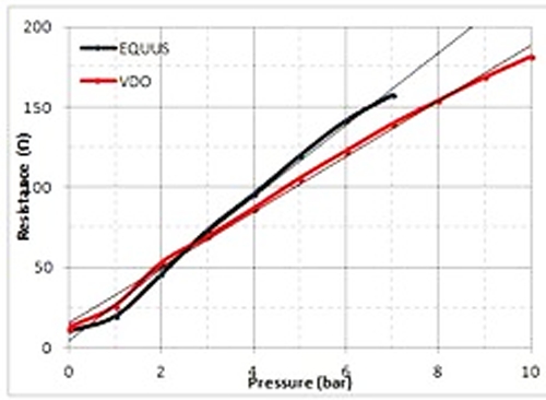

To avoid brownout during start up we installed a Mitchell oil pressure gauge as a supplement to the MGL. The tech folks at Mitchell helped us get the right gauge for the VDO single wire pressure sender (VDO p/n 360-004) and everything seemed to be working fine until they weren't. We traced the problem to a failed sender and installed a new one today. Per VDO the sender was installed dry to ensure it has a good ground. It seems to work fine with the Mitchell gauge, but won't produce a steady reading on the MGL. I've tried every setting in the setup menu for the oil pressure sender and the only one that works is for a 0 to 5 volt sender (the other three options are for automotive resistance style, Rotax 5 to 20 mA, and .5 to 4.5 volt). All the others lock up at somewhere between 133 and 139 PSI. With the menu set for the 0 to 5 volt sender the pressure varies between 62 and 80 PSI at 2200 RPM. When I go into the menu that allows me to see the raw data coming into the RADC unit it shows the sender is putting out .32 to .39 volts at 2200 RPM. If I decrease the RPM to 1850 the sender output goes up to .35 to .41 volts. This corresponds to 65 to 85 PSI on the Enigma. The part that truly makes my head hurt is that at VDO's website;
http://www.vdo-instruments.com/sensors/pressure-sensors-switches/pressure-sender-150-psi-1-8-27npt-29-12.html
The sender is described as sending a signal from 10 to 180 ohms yet, as I said, using the automotive resistance style setting in the setup menu causes the Enigma reading to lock up at 133 PSI.
Last, does anyone know where to get current documentation on the Enigma? What the owner has appears to be an early revision that bears little resemblance to the current software version installed in the EFIS. On MGL's website I get a 404, page not found error when I try the documentation page.

The VDO 360-004 is a resistance type sender. It can NOT output a voltage. The voltage is coming from the Mitchell oil pressure gauge. Ideally the MGL and Mitchell gauge should each have its own sensor. But that might not be practical. It seems that some type of buffer is needed to convert the voltage from the Mitchell to a signal that the MGL can use.

Joe, all, we tried every possible combination of sensor hook up to the Mitchell and MGL, both together and each alone. Even when the MGL was the only thing hooked up to the sensor the output on the raw data showed the pressure sender between .31 and .41 volts. In the end we left the MGL disconnected and are only driving the Mitchell gauge so the owner can fly while we attempt to figure it out.

Have you measured the voltage at the instrument-panel end of the sender wires with nothing connected at all? Or measure the voltage between the sender case and instrument panel ground? This measurement should be taken with everything electrical turned on. Maybe there is a poor ground connection someplace.
Are you using the same 'sender' for both the
steam gage AND trying to read it with the
EIS?
Opps . . . perhaps this is the answer to my
recent question. Joe is right, a variable
resistance transducer must be powered up from
the companion instrument . . . I presume the
Mitchell gage has power, ground and transducer
connectors.
Once biased up by the Mitchell gage internals,
there WILL be a variable voltage across the
transducer terminals that represents the
MITCHELL gage expectations . . . but since
the EIS is not privy to exactly what that
excitation is, it cannot properly interpret
the voltage.
If you want BOTH instruments then you'll
need to set up the EIS to work with a 3-wire,
linear voltage transducer . . . then add
an instrument set up to read THAT same
voltage.
It's not hard to do if you are handy with
a soldering iron and a few chips.

The MGL was the ONLY thing connected to the sender and the data still said that the sender was reading .31 to .41 volts. Any voltage would have been supplied by the MGL's RADC box. The output to the Enigma EFIS is through a proprietary cable, only the input cables from the various senders are user supplied. Going into the RADC to attempt adaptation or a fix is above my pay grade. :-}

Missed a thought. So, if I understand this, the gauge and RADC send a voltage through the VDO sender that varies its resistance with pressure and changes the voltage. This voltage change is then either converted to a meter reading or a digital output that goes to the EFIS. Yesno?
Rick
Yes . . . but EACH readout EXPECTS to see
a voltage/pressure signature that is consistent
with the BIAS current supplied by that readout.
The bias currents from TWO readouts will add
together and produce voltage/pressure values
that makes sense to neither instrument.
Theoretically, you might get away with installing
the VDO/Mitchell sensor/gage combination. Then
set up the 'smart' display look at the voltage
and then program the display to accommodate the SAME
voltage/pressure curve that operates the Mitchell
gage.
Under what conditions were these two voltages being measured?
The variable resistance pressure transducer is rated to present
a terminal to ground value of 10-184 ohms.
Here's a thread describing a builder's efforts to adapt
a VDO 10-180 ohm transducer to an MGL instrumentation
package.
http://tinyurl.com/pavxyb4
[img]cid:.0[/img]
Data acquired by the builder shows that sender resistance
is 10 ohms at zero pressure and builds to 180 ohms
a rated pressure of 10 Bar or 150 PSI. It also
paints a rather linear transfer function.
Here's a pdf that describes one builder's approach
to converting the variable resistance VDO transucer
into a variable voltage.
http://tinyurl.com/oc54e9e
A 300 ohm resistor in series with the gage to a 5-volt
supply will produce 5 x 10/(300+10) = 160 mV at
zero pressure and 5 x 100/(300+100) = 1.25 V at
75 PSI.
In your case, you're wanting the Mitchell gage to
take the place of the 300 ohm resistor. The MGL
display of .31 to .41 volts as the ONLY excitation
to the sensor suggests a bias current on the order
of (0.36/10) = 0.036A or 36 milliamps. If this is
a constant current, then the voltage would rise to
(100 x 0.036) = 3.6 volts at 75 PSI. But these are
things you would need to tell the MGL system to
read the VDO sensor.
Hook up the Mitchell gage as the bias source and
read the zero-pressure voltage value at the transducer. Then
put shop air to the transducer at about 75 PSI and
get a new voltage.
From these two values, you can advise the MGL system
as to offset and scale factors are for converting
Mitchell-volts to MGL display in response to VOLTAGE;
NOT as an interpreter of VDO sensor output.
