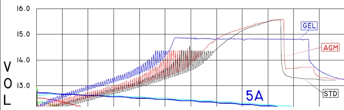

That's the one. I've had good luck with the Battery
Tenders too. I don't recall if I mentioned my disappointment
with the charger-gods at Schumacher with the performance of
an XC75W charger a couple weeks ago
[img]cid:.0[/img]
This 'super whippy' product was supposed to massage any of
the common technologies. In fact, when I tried the Standard
and AGM modes during some battery tests, the thing peaked
out at well over 15 volts . . . only the GEL mode proved to
be a profile I'd want to use with ANY battery. I've still
got it on my list of things to do to forward this data to
Schumacher with some hope of receiving clarification.
