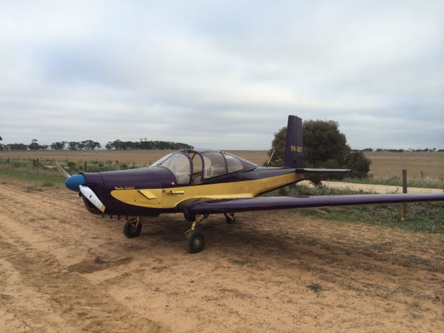

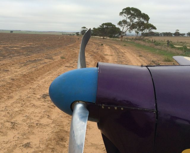

I’ve attached a couple of photos showing why we need to remove the prop.
David

Poor Eagle. Best of luck with the repairs!
