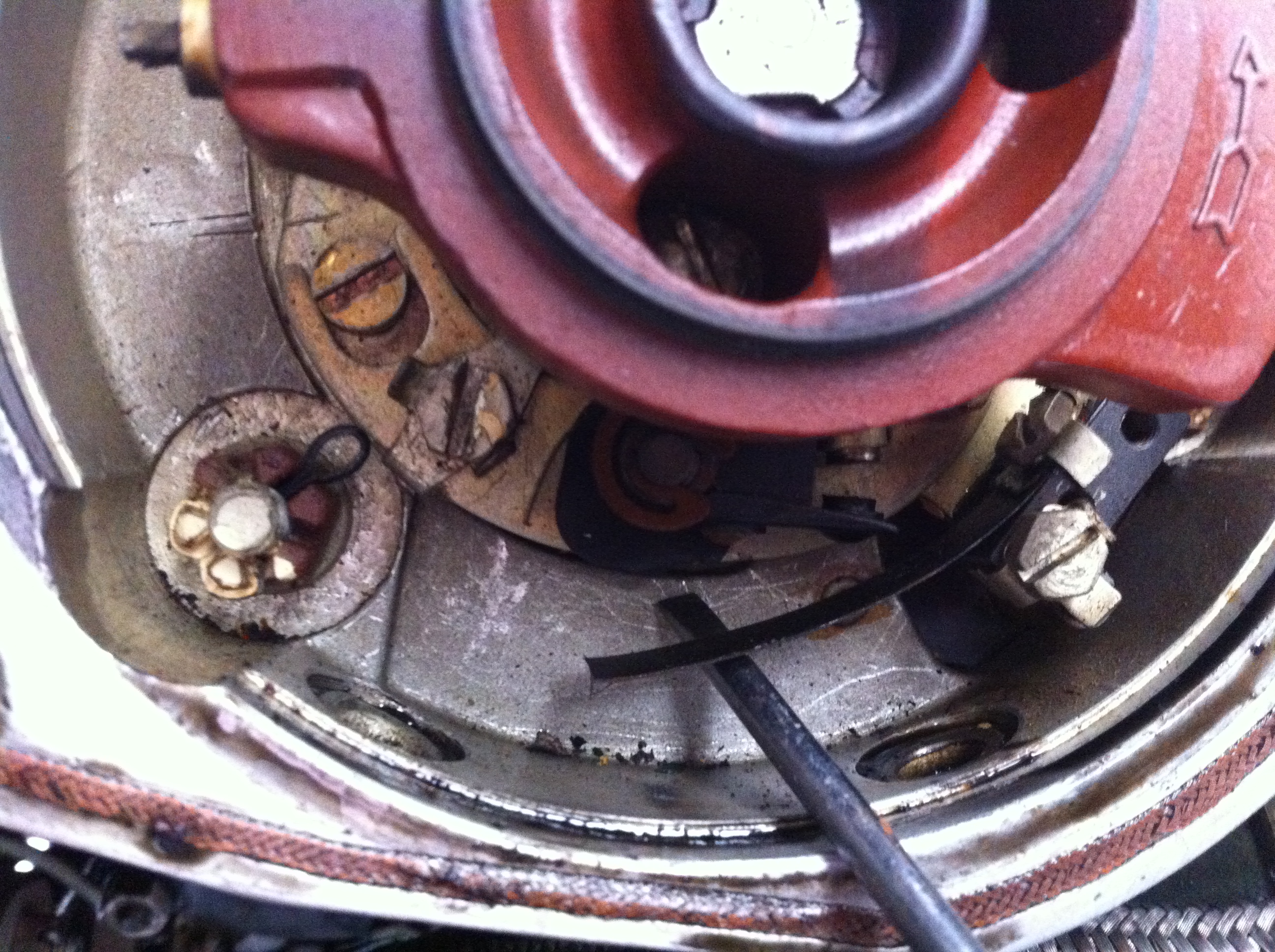

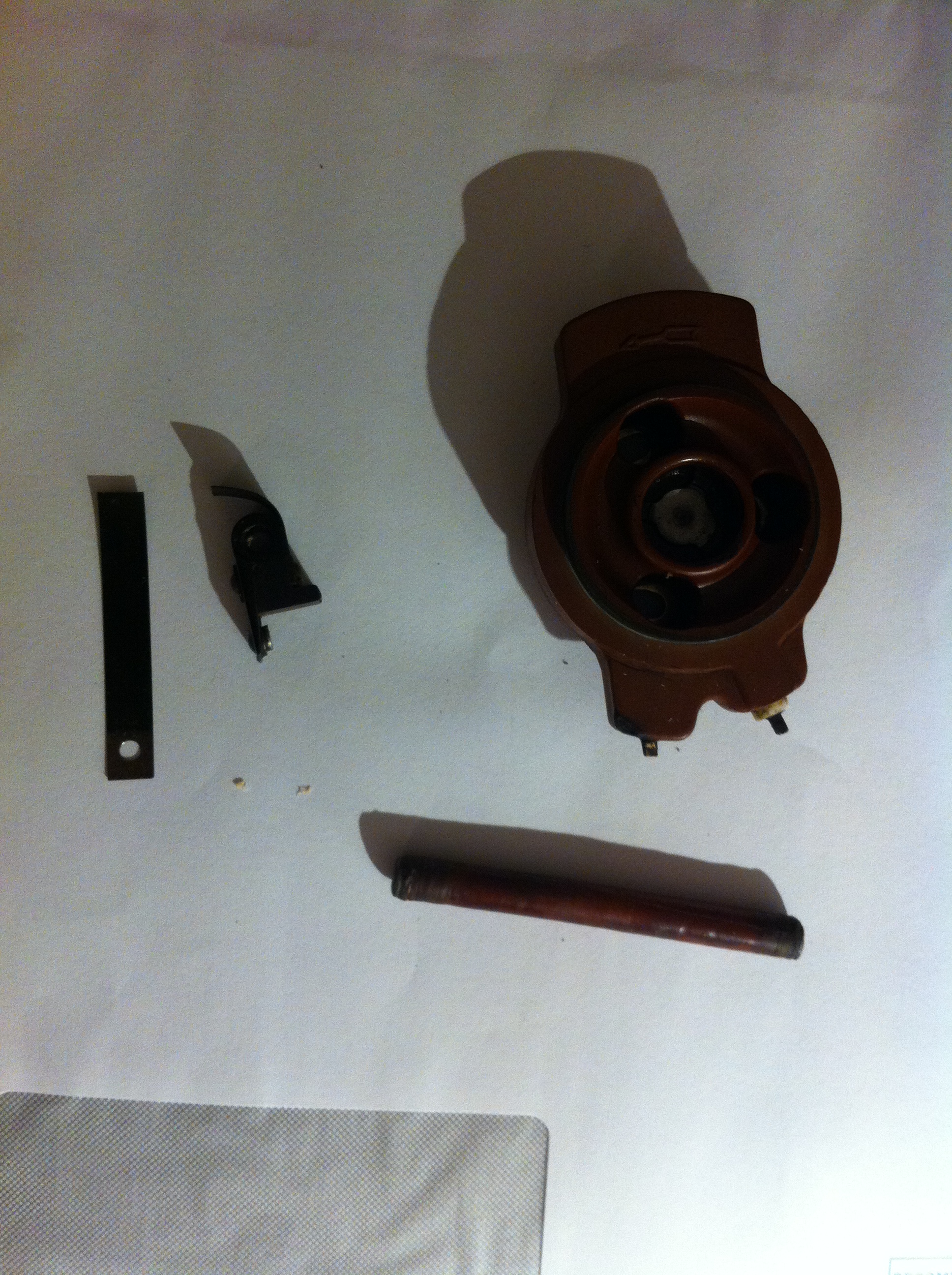

PostPosted: Tue Apr 08, 2014 1:56 pm    Post subject: Re: Magneto failure Reply with quote
Hello,
Problem is solved:
the p-lead was out of order
the spring of the breaker was broken
the head of rotor lightly damaged.
All parts replaced by parts of M14 magnetos and all works perfectly ....
thanks to every body for help
now just needs spare parts ...
Bruno

jan.mevis(at)informavia.b
PostPosted: Tue Apr 08, 2014 9:39 pm    Post subject: Magneto failure Reply with quote
Breaker spring busted, that happens quite often.
Is the rotor damaged by that broken spring?
I think that you can get complete mag set repair kits, for instance at
White Waltham Russian Enineering (ask Genna, top mechanic!).
Jan
