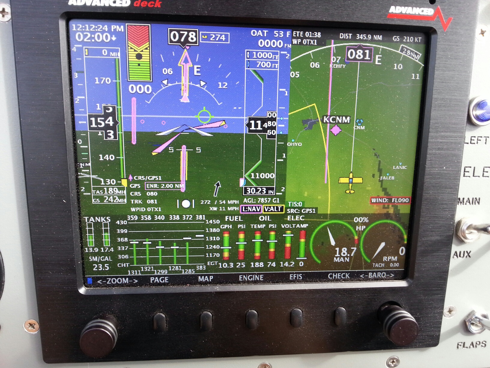

PostPosted: Tue Mar 18, 2014 6:36 am    Post subject: Picking the Matronics List's brain. Reply with quote
You'll want to fly LOP... the whole process is really pretty simple... plus when you're done adjusting and flying a bit, you know more about your plane and it's performance than you would have otherwise.
One thing that some of you might not know.... was flying from Newport OR down the coast to Gold Beach, and had an unbelievable tailwind. (4 souls on board) When I leveled off at 3,500' (to sight see) and went LOP... I glanced down and I was only getting 16.5mpg.... after a little thinking, I sped up about 20 mph, and like magic, I was now getting 18.5mpg. So there is a minimum speed needed to achieve the best economy. (Around 150mph indicated) Had I been at 10,000+ feet I would have probably been seeing 23 to 25 mpg... as I have on several return trips from Calif back to Texas. (see attached pic)
So, the point here is that you can throttle back to far, which will not allow you to fly farther.
Don McDonald
Pic attached shows what can be achieved with a good tailwind. At 2,100 rpm,half throttle, and LOP, you can still not only run fast, but run efficiently. Notice IAS still around 150mph. Seems to be the sweet spot for my 10.
