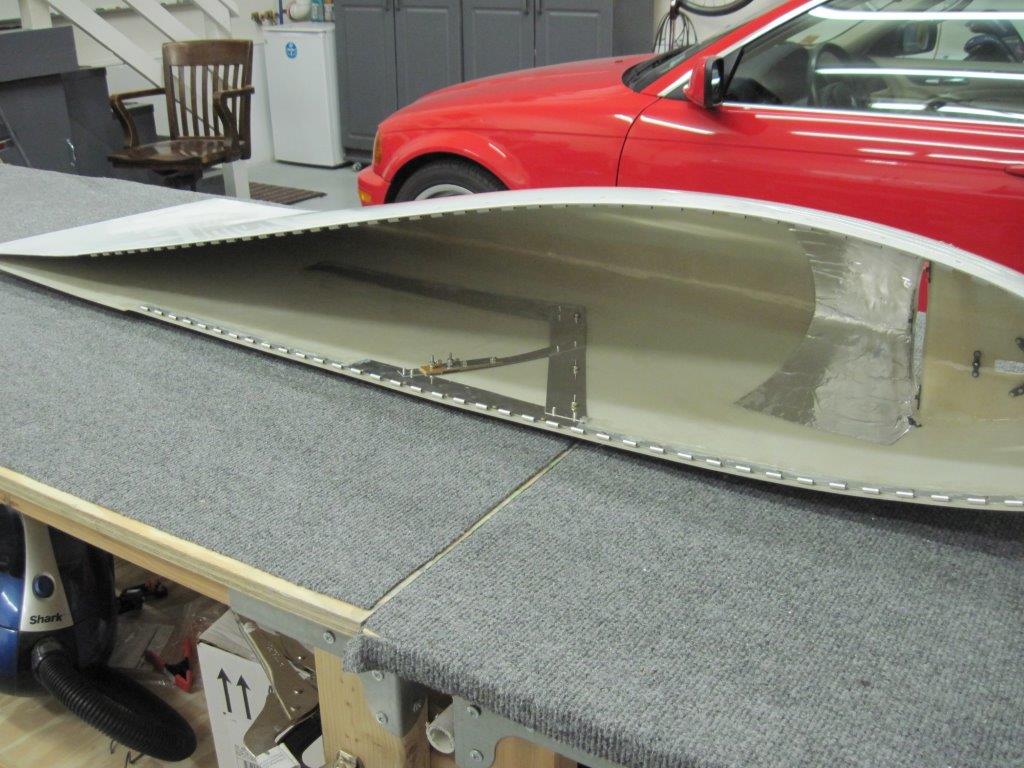

I have one in each wing tip and they work every bit as well as my last aircraft, which had the external cat whisker antenna. I also use them for the glide slope. Of course by mounting them in the wing tips off of the centerline of the aircraft, your Localizer beam will be offset by the approximate 15 ft. the antenna is off centerline Surprised
 Filesize:  126.63 KB
 Viewed:  4732 Time(s)
