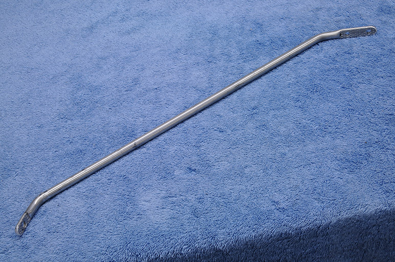

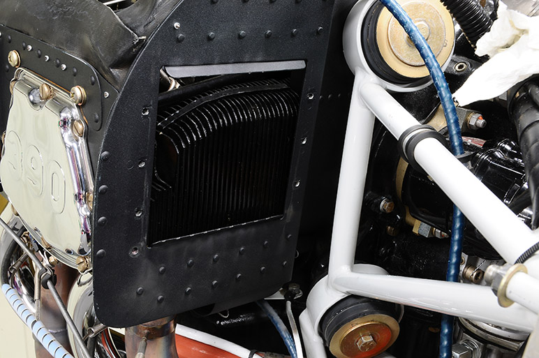

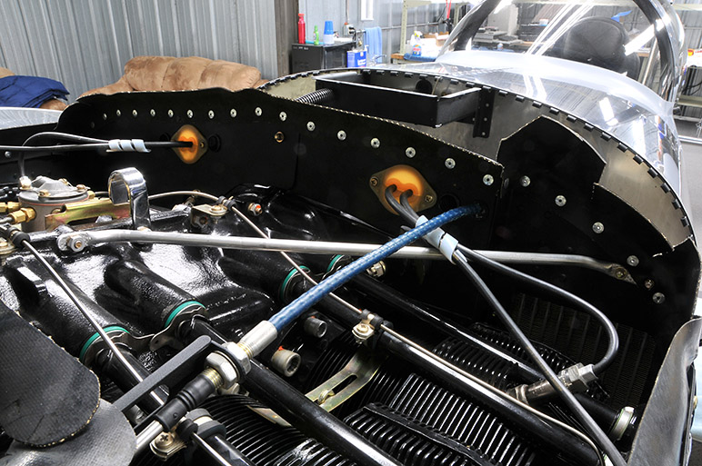

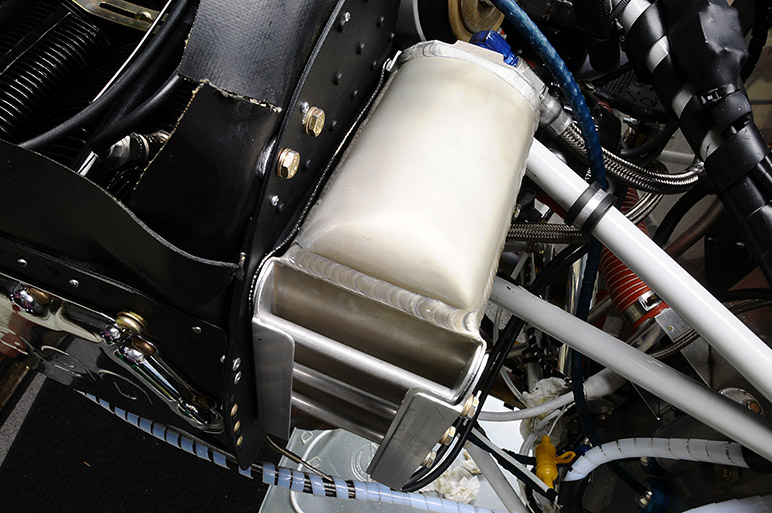

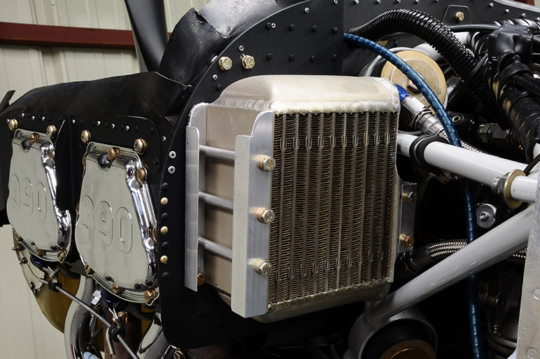

I thought the source of the cracking had been addressed. I had some issues with the left-rear baffle flange cracking too in the beginning. I made the rear baffle nice and strong, but used the stock left-rear piece which was .032. It just wasn't up for the task. I later added a cross strut from the crankcase just ahead of the hoist loop all the way back to the left rear corner and added some .063 angle stiffners over the oil cooler flanges for additional support. I'm wondering if I cracked the flange today taking the oil cooler off. It was pretty stuck on and I was having to do a fair amount of prying to get it to separate from the gasket. I would have been more careful if I'd of realized those flanges are made out of such crappy pot metal. Man, they are soft.
Since I'm rebuilding, I decided to rebuild the left-rear baffle part and was taking the oil cooler off today to accommodate that. That's when I noticed the crack.
Attached are some pictures of the setup prior to disassembly today.

>If you just install another oil cooler .... my gut feeling is that it'll crack too. If it was mine I would have it welded .... you can't braze aluminum .... and figure out why the oil cooler cracked in the first place. My first choice is engine vibration, and the second is stress due to the baffle mounting flange not being flat.
