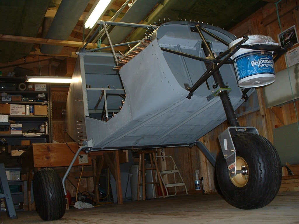

Bye the way I'm on wheels now I started from plans in 1991 and never thought I'd see this day. ....Geoff
