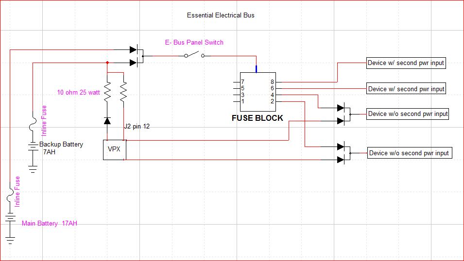

My RV-6 has been flying 12 years now with an electrical system based on the Z diagrams. Now I am assisting my wife complete her RV-7 electrical system. She has chosen to use the VPX Pro unit and wants to incorporate a "backup" source of power for clearances, engine start, and "endurance" (if the VPX box were to quit).
The circuit that we are considering uses a bridge diode that would allow the main battery to supplement the "backup" battery for increased endurance. Since I have not seen this variation before, there must be a "gotcha" that I haven't found. Attached is a picture of the basic circuit. Any suggestions and/or comments would be appreciated.

My first question would be why add the complexity of a second electrical
system, when virtually all situations can be handled by either backup
battery for EFIS, ship's battery or just plain old magnetos.

Define "all situations" . . . the term is non-
quantified/qualified. When we're designing a
TC aircraft, EVERY situation needs to be articulated
in the design documents along with the plan-B, C, . . .
or Z that mitigates that situation. Then we have
to go TEST every one of those plans to demonstrate
compliance with design goals.
. . . can be handled by either backup battery for EFIS, ship's
For OBAM aircraft it's a function of design goals built upon
the pilot's skills, maintenance protocols, airplane capabilities
and anticipated missions. Obviously, the manner in which
one might outfit a Kitfox can depart greatly from the
way you would craft an LAIV-P. At the same time, the
builder of an RV-6 in the Pacific NW (Lots of clouds
all the time) who travels a lot might have a more
sophisticated system than another builder who intends
to use is LAIV only in day VMC but wants the
speed, ability to hop the occasional mountain range
and air conditioning.
This litany of potential "situations" offers
a brief peek into the value of having design
goals synchronized to the end-use.
Production aircraft tend to have cookie-cutter
approaches to system architecture . . . because
the designers can only hypothesize greatest risk
situations for the targeted customer then address
those hypotheses within the framework of the
impediments to creativity imposed by the FARS.
We on the List have a clean sheet of paper
for the beginning of every project. The Z-figures
are intended to offer a sort of "Cliff's Notes"
on architectures that span the spectrum of
possibilities. Some builders have put Z-14
into their 2 place RV's at no small penalty
for cost and weight . . . but find comfort
in not having to go through the very non-
trivial exercise of optimizing their decision.
There ARE LAIV-P aircraft flying with one
battery, one alternator, and backup batteries
sprinkled over the panel and perhaps some
more in the flight bag.
Its unlikely that either builder has tested
available failure response plans against his/her
perceptions of capability in the Plan-B
hardware.
Given the decreasing failure rates of modern
electro-whizzies, it's unlikely that either
of the pilots in the last two examples will
have a 'dark-n-stormy night' story to write
up for Flying Magazine.

Okay, you're plagued with the same litany of concerns
that arise from lack of confidence in your present
'vision' for how this system should evolve.
be appreciated.
Read through the posting I made a few minutes ago
and then consider a list of design goals that are
based on . . .
(1) How will this airplane be used? Do you
anticipate long legs of travel at night over
unfriendly terrain?
(2) Are you anticipating more than a tiny
percentage of approaches to landing to be
in IMC?
(3) Do you plan to carry the ultimate in
backup reliability in your flight bag?
http://tinyurl.com/d5mrjgh
This is the stuff I recommend for folks like
me who only rent airplanes . . . but if
it were my airplane, those items would still
be with me. In fact, I've not turned on a
VOR or ADF in 15 years . . . nor have I used
a panel mounted GPS . . . but that's another
story.
(4) Are your skill sets going to be honed
to the levels necessary for low risk
implementation of the hardware you plan to install?
It's entirely possible to have an airplane
decked out to the window-sills with goodies
only to have A pilot become the weak link
in the chain.
http://tinyurl.com/kb2zr8m
I've flown with pilots who were quite proud
of all those dials, switches and knobs on
the panel who never flew more IFR than to
keep their ticket current. The greatest
risk for bending their airplane was not
rooted failure of hardware.
Keep in mind that 2x the hardware is 2x
the probability of failure. Got some more
batteries scattered around the airplane
. . . guess what . . . now you're running
a clinic for batteries upon which you believe
you're building a 'dependable' system.
Commodity items like batteries are like house plants.
Just because you have two of them does not mitigate
the need for knowledgeable preventative
maintenance but it DOES double the maintenance
$time$.
So before we spend a lot of time refining
the work-arounds for hypothesized failures,
let's look at the big picture and size the
solutions to realistic risks having the
greatest probability of presentation.
Then you're ready to sift solutions for those
having the lowest cost of ownership, weight
penalties on the aircraft and taxation of
your skill sets.

I would just add a simple Brown out 7ah Alarm battery/Aux bus charged thru a Schottky diode and maybe a resistor is very simple & cheap to do. A lot of equipment now comes with multiple diode isolated power inputs making it easy.
This allows flight plan entry and clearance requests before start up without draining the main battery, keeps the GPS/NAV/COM and EFIS from rebooting when cranking the engine, and provides maybe 20-30 minutes of extra time to get back on the ground.
Weight/cost is about $35 and 5 lbs. cheaper than a factory backup, which only powers one item.
Tim

Good data points. Let us consider the premises
underlying the evolution of Figure Z-07
http://tinyurl.com/my9u3ud
this shows a two battery/single alternator system
for an electrically dependent engine. This
exercise in 'electron gazing' grew out of Fred's
project already fitted with a EXP-Bus. I could
see a way to accommodate Fred's initial design
goals for two batteries with a simple mod to
the EXP-Bus . . . but I could see an alternative
to Z-19 evolving from the deliberations . . .
hence Z-07.
Off in the distance, I think I see a single-battery
variant of this architecture but that's possible
only after we get real energy requirements data
. . . and further refine the operating philosophy
for the system. Tim's words raise useful questions
that go directly to deliberations for sizing risks
in a single-battery design.
Where is it written or demonstrated that having
the ship's processors 'reboot' is a bad thing?
Under what operating scenarios is it useful/necessary
minimize the time between the glass being awake
and reaching the end of the runway just prior
to engine run-up?
I recall some stories about the Blue-Mountain
systems (hard drives?) taking perhaps 90
seconds to wake up . . . but when was the
last time you were ready to check mags less
than, say 3-4 minutes after engine startup?
I've reviewed as many of the airports I've
visited that I can remember. I cannot recall
any departure where engine run-up was accomplished
for before the oil was warmed up a bit and I
had taxied from parking to the run-up stand,
certainly 4 minutes, sometimes 10. I think
it took 15 minutes to get out of KCI once.
. . . the check list belongs to YOU . . . you
can adjust sequences of events to fit hardware.
Let us consider "draining the main battery"
for the purposes of gathering the ATIS data
and getting a clearance delivery. Suppose the
e-bus runs 5A and the exercise takes 3 minutes.
12v x 5a x 60s x 3m = 10,800 watt-seconds.
Cranking the engine 12v x 200a x 10s = 24,000
watt-seconds. What does the battery hold?
12v x 5a x 60s x 120m = 432,000 watt-seconds.
Okay, you used up 34,800 watt-seconds before
the engine was lit for 35K/432K or 8 percent
of the battery's capacity. If you're targeting
80% of new capacity for banishing your battery
to kiddie-car duty, then the last flight
will tax the battery to 10% of available
capacity.
The above analysis is a first order estimate
and does not take into account vagaries of
temperature and internal impedances of the
battery but it's in the right church if not
in the right pew.
Whats is the return on investment for 5 more
pounds of battery and two batteries to maintain
instead of one?
The value of this . . . or even more detailed
analysis presumes that you KNOW what the
drains are and what the battery's capabilities
are after accounting for aforementioned
vagaries AND targeted end of life decisions.
jluckey(at)pacbell.net

At 11:31 AM 2/2/2014, you wrote:
--> AeroElectric-List message posted by: Tim Andres <tim2542(at)sbcglobal.net (tim2542(at)sbcglobal.net)>
Tim

PostPosted: Sun Feb 02, 2014 3:39 pm    Post subject: Essential Bus question Reply with quote
OK, let me write it here:
Watching the Garmin 430 in my Cherokee re-boot after engine start is
very inconvenient.
Stop-watch that for me some time. I'd really
like to have a number on this widely discussed
but never quantified driver of design goals.
Is it catastrophic? No. Are there work-arounds? Certainly. It's
just a pain in the (at)ss.
In an experimental w/all glass, it would be even more annoying.
Now that I'm designing the electrical system for my RV-7A, I'm
certainly want a design
where that does not happen. This is one of the reasons people like
us build our own
airplanes - we get to engineer-out those little annoyances that we just have to
put up with in certified airplanes.
Then by all means do so. It's your airplane and your
design goals. The question wasn't whether or not you
wanted to do a particular thing, it was an invitation
explore why you wanted to do it . . . hopefully for reasons
firmly of your own choosing and not 'just because'
hangar lore and legacy traditions dictated it.
Brownout batteries have been discussed her on the list often
for several years an even illustrated one approach
in Z-10/8
http://tinyurl.com/7ro5yuc
All true but, there are also thousands of quiet little airports where you can
depart as quickly as you want to
Yup . . . there are. If a significant percentage
of your departures are so expeditious that
boot time on the glass becomes an impediment,
then you have an element of fact that drives
a different design goal.
I'm trying head off any notions that just because
one is considering a glass cockpit that a brownout
battery is recommended . . . it comes with a price in
weight and costs of ownership that may add little
or no value.
PostPosted: Sun Feb 02, 2014 4:14 pm    Post subject: Essential Bus question Reply with quote
Not to argue your points Bob, and I agree simple is often better, but I would just add that I don't want to wait 20 seconds for the screens to reboot after engine start as my engine data is there also and I want see oil pressure etc right away.
And I much prefer to enter a lengthy flight plan with the prop off as my attention will be focused inside the plane, I'll admit on occasion I've looked up from the panel and discovered the plane moving. My flight plan will then be lost when I then crank the engine, unless I save it to memory, which I won't unless I'm using it again.
And sometimes I take off with a hot engine, I'd rather not sit with the already hot engine running in the summer heat while I enter several waypoints in the Garmin.
To me it's worth the 5lbs for the convenience, and the cost is easily overcome in fuel not burned.
The beauty of EAB, built what you want, then live with your decisions.
Tim
Virtually all glass have their own light weight backup batteries so do
not have startup brown out issues unless no backup battery is installed.
I see very little value in being able to turn on GPS prior to start.
While one needs engine instrumentation prior to and during start, one

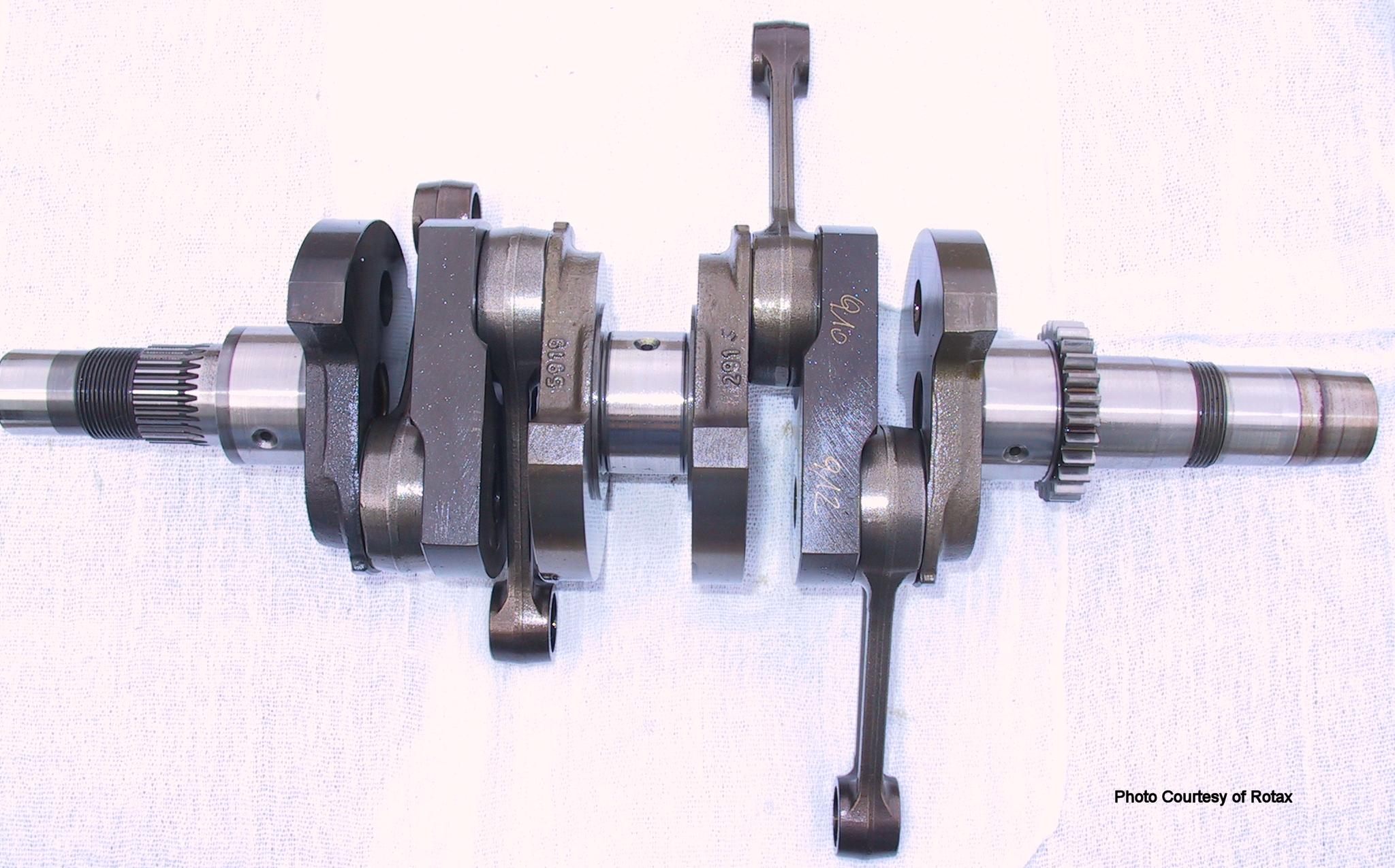

Bob, You also have to take into account that unlike the LyCo's, the Rotax has a five piece crank that is pressed together with nothing but the pressure of the fit to keep it together and aligned. I would imagine the trail of tears would include a piston seizure that causes the crank to come out of alignment which not only destroys a bearing or two, but gives the various crank sections a chance to beat upon each other. The reason for the multipiece crank is so that it can be made shorter by reducing the clearance between the side of the rod, see picture. With so little clearance between the rod and the adjacent crank web the twisted, misaligned crank now has a chance to really start beating on the rods, the piston skirts, and any pieces that have come loose. Of course the Rotax engineers have reduced clearances between the rotating assembly and the case halves to shave off more weight and by now the bearings are not only being twisted out of their seats but the case webs are being hammered, too. Well, that's about all I can conjecture about the cause and effect trail, but you get the idea. Rotax engines are just a different animal.
Rick

PostPosted: Mon Feb 03, 2014 7:08 pm    Post subject: Essential Bus question Reply with quote
I think the multi piece crank is needed when they use one piece rods with roller bearings. Still hard to imagine a 10 sec failure. An oil change now becomes a major event in the life of your engine!
I find this scenerio to be highly unlikely! If this were the case, then I would wager that there would be cases of this type of failure during normal operation, due to the stress and vibration created during high power running.
normal operation, due to the stress and vibration created during high power running. Roger
Let me venture way outside my pay-grade and offer an opinion that the Rotax multipiece crank is in no way an inferior design, and in fact offers lots of advantages:
1) Cost
2) The connecting rods need no end bearing caps, thus they are stronger and lighter.
3) Exceptional resistance to failure from torsional vibration.
4) The ability to use different metals for the various parts.
5) Shorter crank.
6) The ability to use roller bearings. (I have no idea if they actually should or do).
As long as the rod and main bearings are good, the idea that the crank can come apart is simply a distraction. Porsche 4-cam racing engines used a similar design, although they keyed theirs. But Still... Your Mileage May Vary.
