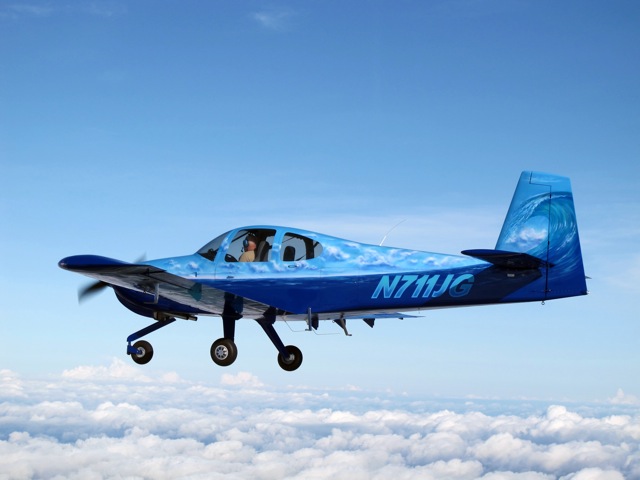

PostPosted: Mon Jan 27, 2014 5:10 am    Post subject: Re: turf runways Reply with quote
Go Pantless, like I did.

PostPosted: Mon Jan 27, 2014 6:35 am    Post subject: turf runways Reply with quote
I thought about that but just can't do it. 7 years with pants on has me used to them.

PostPosted: Mon Jan 27, 2014 10:54 am    Post subject: Re: turf runways Reply with quote
No chance of damaging these pants... Wink
John
 Filesize:  57.83 KB
 Viewed:  20156 Time(s)
jchang10
Joined: 05 Jul 2006
Posts: 227
PostPosted: Mon Jan 27, 2014 11:39 am    Post subject: turf runways Reply with quote
Looks nice. Normally, the gear fairing is held in place by the lower
pant. How did you keep the gear fairings in place without the pants?
Jae

PostPosted: Mon Jan 27, 2014 5:59 pm    Post subject: Re: turf runways Reply with quote
Jae
They actually stay on just fine. They are attached at the top, and the only thing I did different is taper them down as far as I could. They actually stay in place without any special work on the bottom. The nose strut is even easier, it already has screws to hold it in place. I did have to change the piano hinge set up on the mains - a pin to go up, and a pin to go down.
Without the pant brackets, and with hub caps, there's not much drag to worry about.
John

What you lose in speed/time, guessing...6 kias/15 min per long xc would be nothing compared to time and materials repairing broke pants on a grass strip. I would take my pants off in a heartbeat to save $170/mo hangar rent and walk out to my hangar.
Wayne G.
