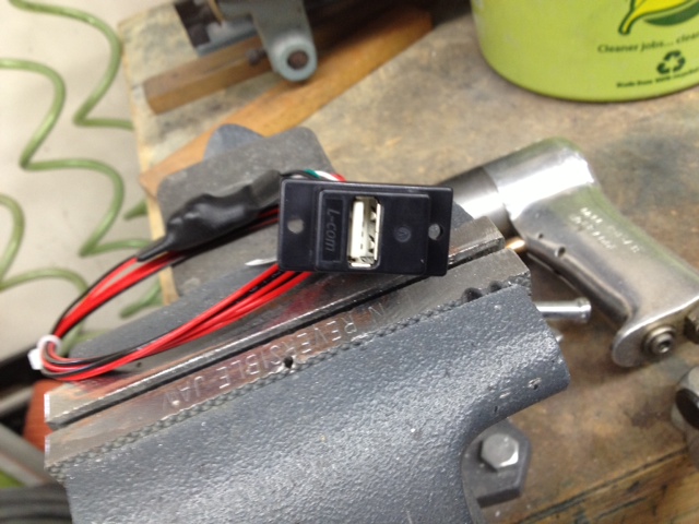

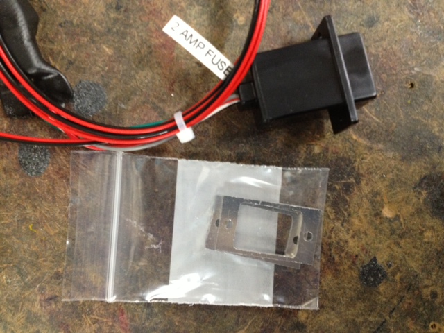

jeff(at)westcottpress.com
PostPosted: Wed Jan 15, 2014 12:45 pm    Post subject: Placement of phone jacks for back seats Reply with quote
Stein sells these...
On Jan 15, 2014, at 11:55 AM, Bill Watson wrote:
So there was a thread, probably on Aeroelectric, regarding USB ports. As I recall it was never brought to a conclusion.
What are y'all using for USB charging ports?
I have a cigarette port poorly located but I'd love to install a USB port or two.
On 1/15/2014 2:40 PM, Tim Olson wrote:
> You must not carry kids (re the charging)....we use
> the back seat charging ports all the time.
> Tim
 Filesize:  134.07 KB
 Viewed:  16016 Time(s)
 Filesize:  119.04 KB

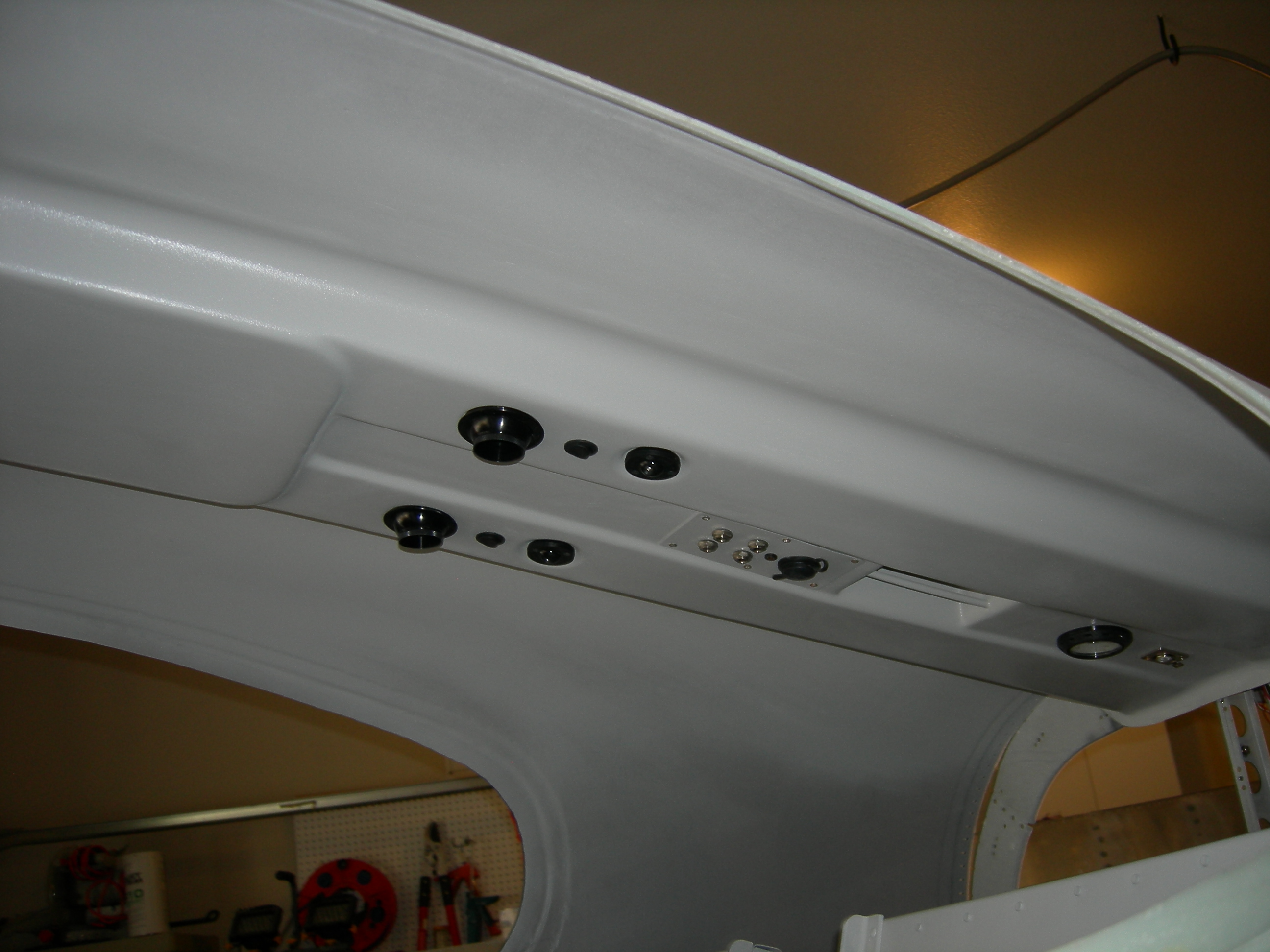

hotwheels
Joined: 01 Jun 2007
Posts: 240
PostPosted: Wed Jan 15, 2014 2:14 pm    Post subject: Re: Placement of phone jacks for back seats Reply with quote
Mounted mine in the overhead. Seems to be a good location so far.

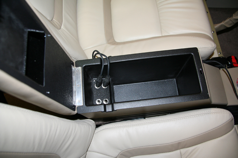

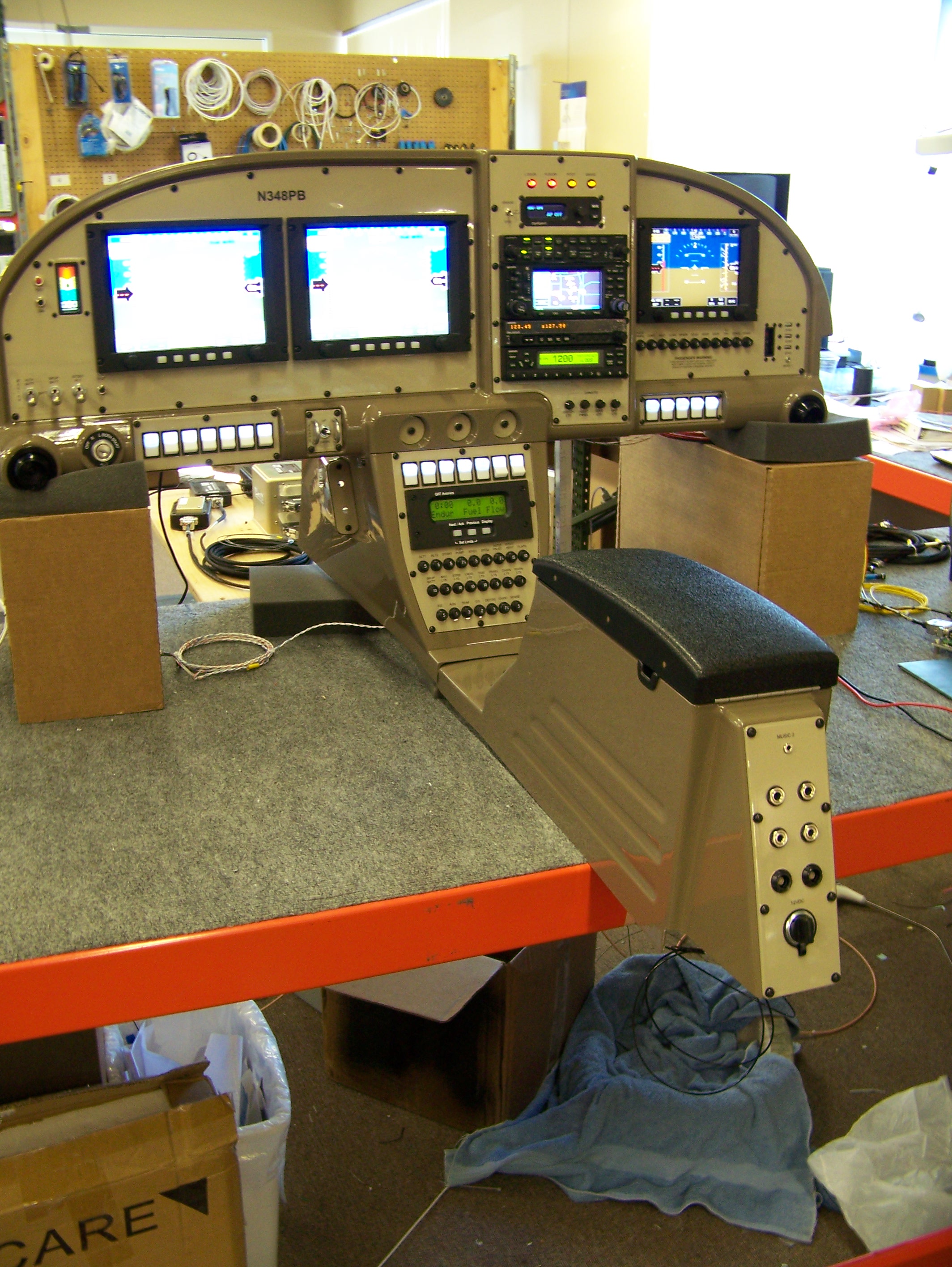

aerosport1
Joined: 07 Nov 2007
Posts: 231
PostPosted: Wed Jan 15, 2014 2:38 pm    Post subject: Placement of phone jacks for back seats Reply with quote
If you have a center armrest front inside and the rear passengers on the
back side. It keeps all the wiring
In the center. Also less likely to catch them on their feet when getting out
of the
Airplane. Charge jacks and music inputs work great there as well.
FWIW
Geoff Combs
