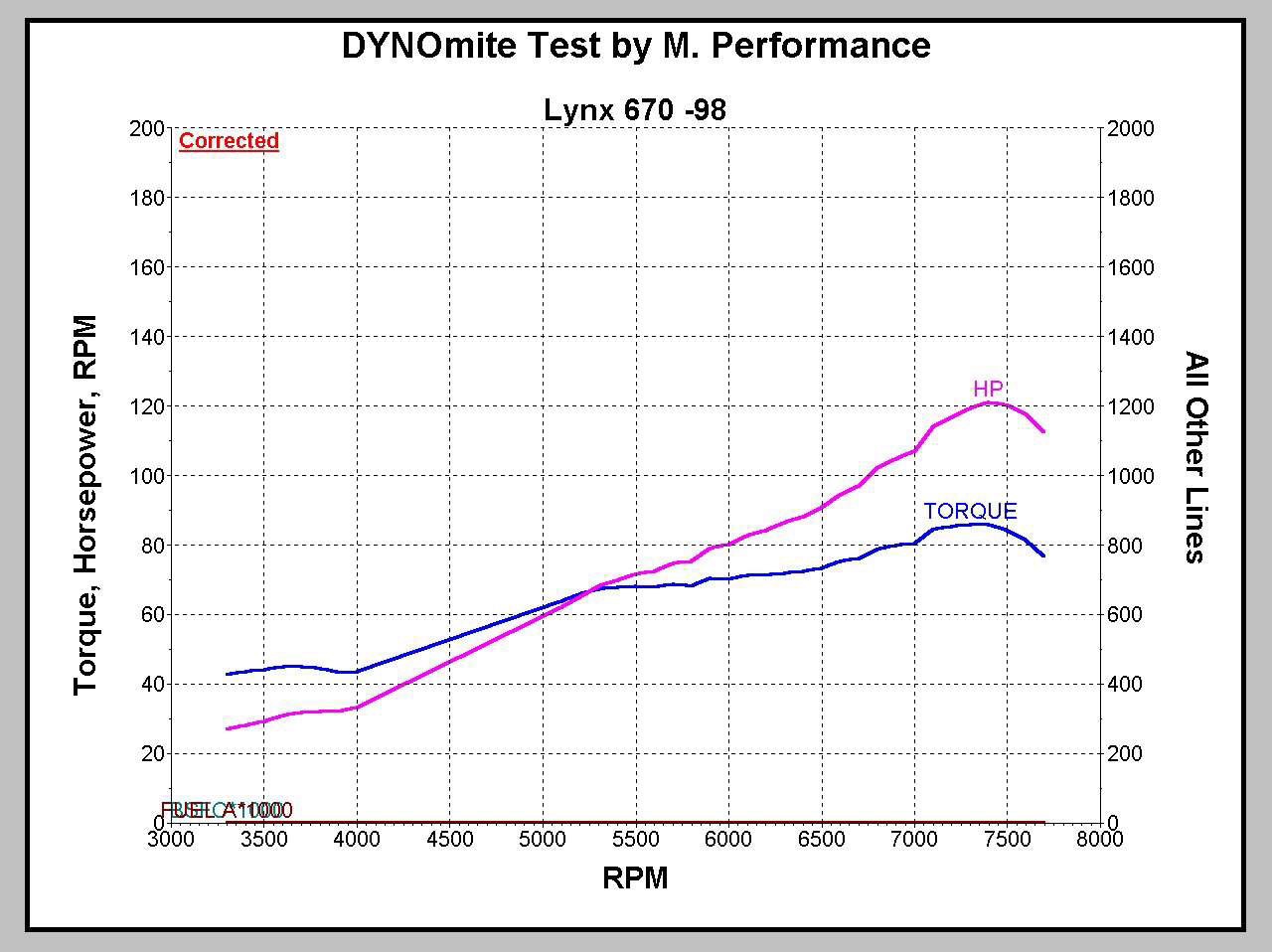

Power curve of a 690 in a sled.
In our application you prop it for 6400 to 6700 rpm max and voila, you have a 90hp engine on a budget.
I'll have a great comparison to my current 2si engine as the gearbox ratios are essentially the same and I'll be using the same prop.
Should be a great apples to apples comparison.
