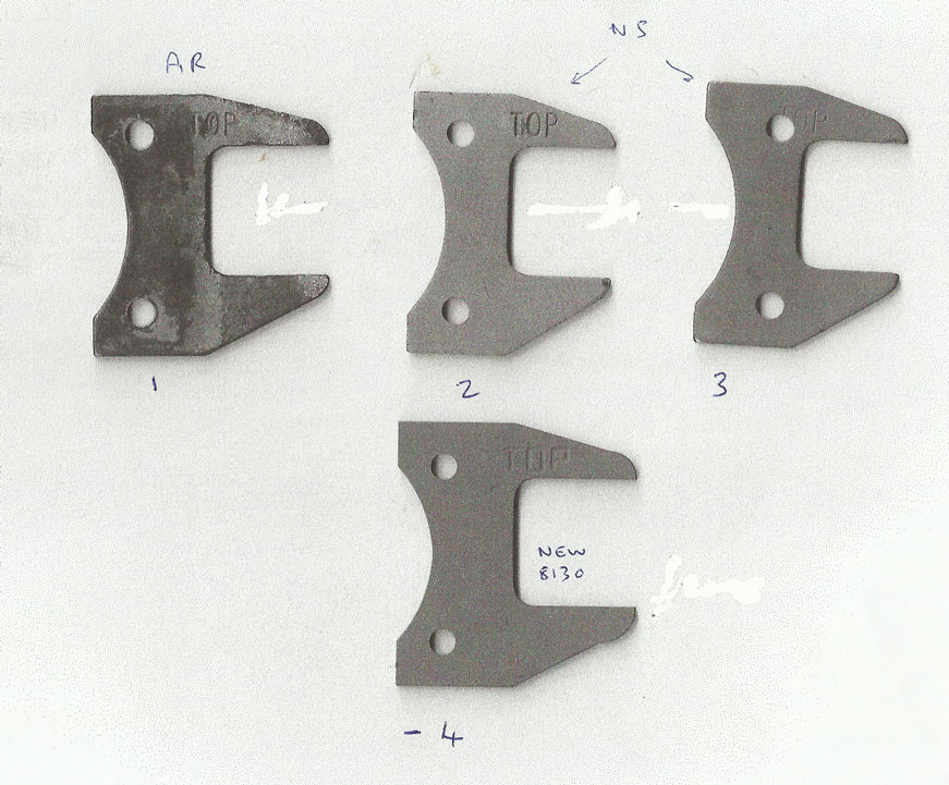

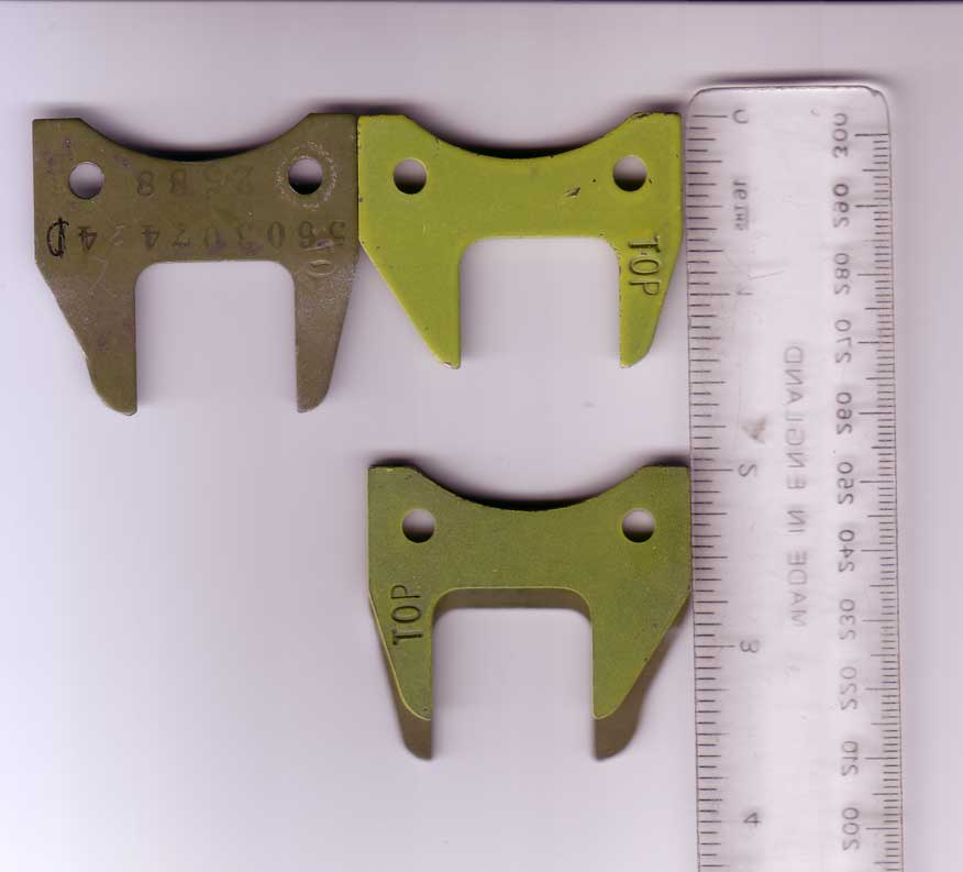

As for the aileron stops there has been many changes along the way, the attached picture shows just fours types I have found out there.
We are up to -4 so assuming the others mat have been -1's to -3's.
Again Garner may be able to confirm.

This is a 79 Cheetah. The stop looks like one of your earlier ones.
