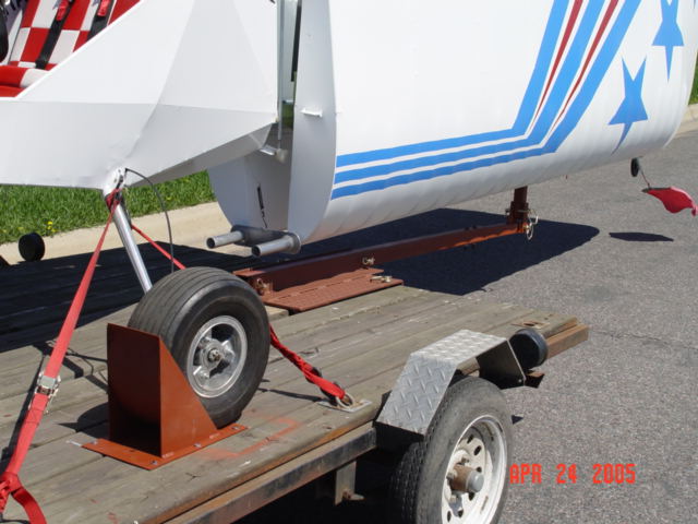

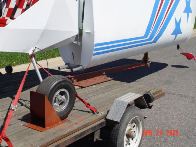

PostPosted: Fri Jun 16, 2006 1:05 pm    Post subject: Re: Kolbs on Open Trailers Reply with quote

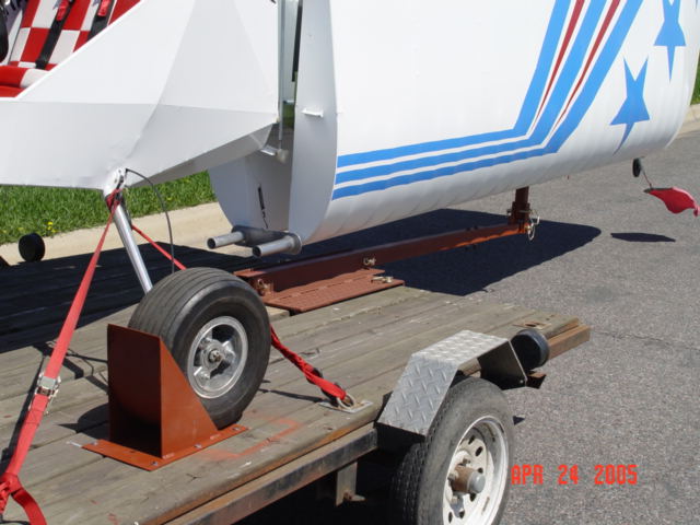

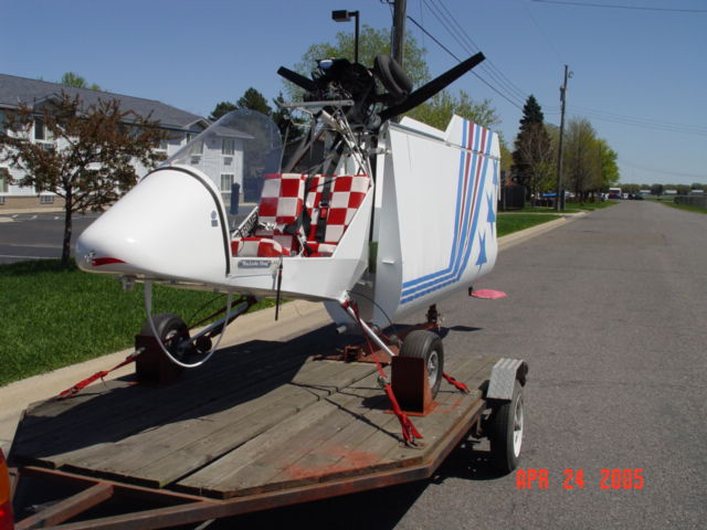

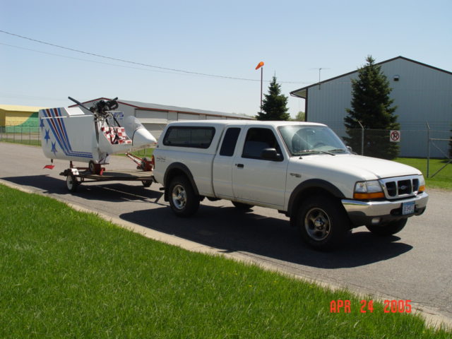

Firestar on Trailer... 22 ft plane on a 10 ft Trailer...
It pulls great, no problems....
Gotta Fly...
Mike in MN / N381PM

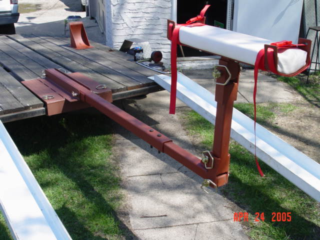

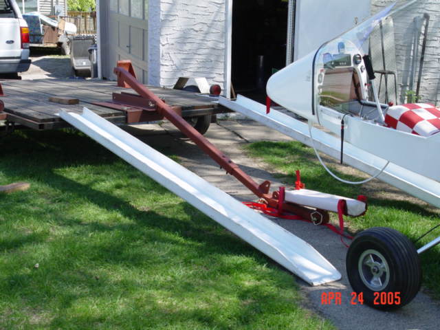

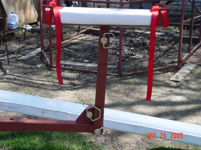

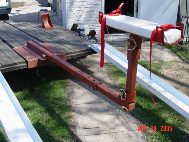

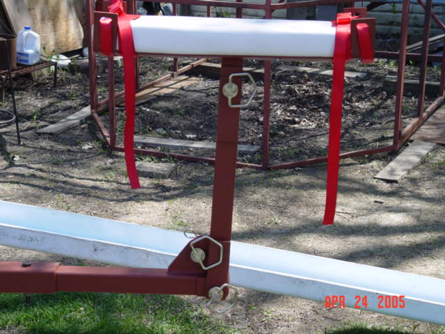

Do you have a picture of how you have the Boom Tube supported. Pete
planecrazzzy
PostPosted: Sat Jun 17, 2006 8:48 am    Post subject: Re: Kolbs on Open Trailers Reply with quote
This is how the boom tube is supported...The saddle pivots....
