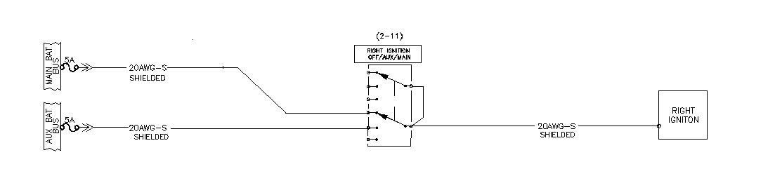

Bob,
I want to wire my electronic ignition switch such that to can select the Main or Aux battery bus (Off/Aux Bus/Main Bus). The drawing depicts what I'm thinking. I'm not sure that the S700 2-11 is internally wired as depicted...that is why I asked for clarification on the switch configuration.
I also want to use this switch for a pulsed landing light (Off/On Steady/Pulsed)
Mike Marker

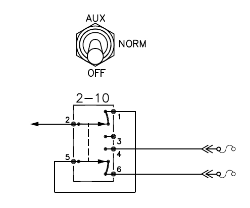

The S700-2-10 switch can be wired for single
pole three postion as shown below . . . just leave
the lower throw terminal (3)unhooked and you
get the desired behavior.
[img]cid:7.1.0.9.0.20131115220031.02131cb0(at)aeroelectric.com.0[/img]
 Filesize:  33.87 KB
 Viewed:  7307 Time(s)

Thanks Bob! I made several failed attempts to figure out how to wire the S700 2-10 switch to perform desired function...but you drawing makes it obvious. So I'll be using the 2-10.
Mike Marker

The 2-11 nomenclature is not carried over from
the mil-specs like the other dash numbers. I think
B&C added this callout to describe one of the
variants of the 2-10 . . . which are fundamentally
unnecessary since the 2-10 can be wired to accomplish
the same tasks.
