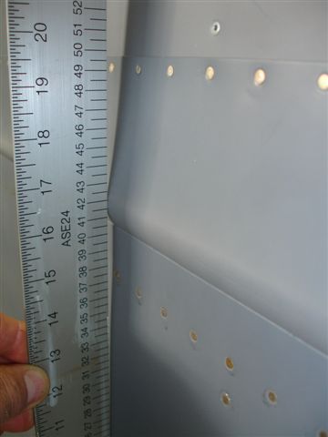

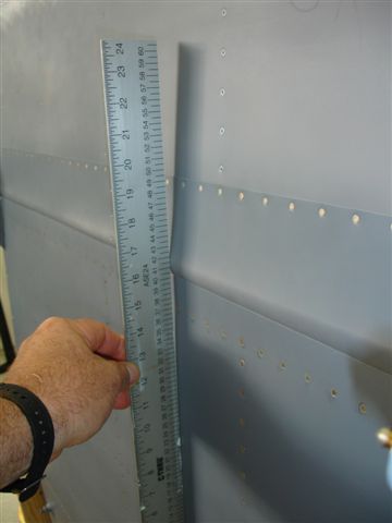

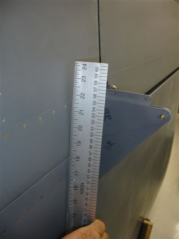

OK. Pictures are worth a thousand words. Below are several pics I took of the flap wing gap.
The first pic was taken between the two inboard flap hinges. Notice how the flap sticks out below the bottom skin.
The second picture is a closer look. Pretty ugly.
The third pic was taken right next to the middle flap hinge bracket. Perfect!
I write this in hopes that someone else will not go through the same thing I did.
I am not a first time builder. I have built a slow build RV8 and have a working knowledge of how Vans kits go together. However, this is stumping me at the moment.
So, because of these irregularities, I get to build new flaps. What I would like to know is if anyone else out there seeing the same thing I am?
Btw, this is a slow build RV10 kit.
Zack

PostPosted: Mon Jun 12, 2006 2:29 pm    Post subject: Trailing Edges Reply with quote
Thanks for the explanation. I haven't seen this on any of ours, or at least
haven't noticed it (and that shouldn't be hard to notice). It almost seems
as if the leading edge skin didn’t get pulled up tightly against the ribs.
I can't imagine how that could happen unless you got some bad hinge brackets
or the leading edge skin is bad. Even having a warped flap shouldn't do
that, singe the bracket is forward of the spar. Could it possibly be
something with the wing or wing brackets (I shudder to even mention this)?

PostPosted: Mon Jun 12, 2006 2:30 pm    Post subject: Trailing Edges Reply with quote
Hi Zack,
Don't know if I can be of much help. I jumped over the fuel tanks and
skinning the bottom of the wings so I'm not able to hang my flaps at
this time.
After looking at your pictures here are some things to think about. Is
the distance between the hinge pivot and the bottom skin the same for
each hinge (check both the wing half of each hinge and the flap half)?
Is the nose skin of the flap more reflexed (sagging) at the inboard end
of the flap? If you have access to a digital protractor clamp the flap
in place so it won't move and take angle readings off of the main skin
(from front to back) along the length of the flap and wing.
Here is the thinking behind it. If either half of the hinge points
progressively run down hill in reference to the skin the whole flap
would droop at one end. Don't know how this could happen with the
pre-punched kits.
If the protractor reading progressively gets worse down the length of
the flap then the problem may be the twist in the flap is centered
around the spar flap (this would cause the leading edge to droop and the
trailing edge to rise or via versa. Well that's my $.02.
Vern (#40324)

I'm just confused about what I'm seeing back and forth in the emails.
I saw your 3 pictures and I can't even begin to imagine how it came out
that way. I'm not trying to be insulting, so please don't take it that
way, but man, somethings wrong there. (I know you know that. Wink )
I only wish I could come up with a good reason.
I would durn well hope that the problem isn't with how the flap attach
brackets are, that are riveted to the wing....if they're bad, I'd hope
that they're bad on the FLAP side, not the wing side. You may want
to use a ruler and square and whatever you can, and verify that the
approximate orientations and distances to the holes on the flap brackets
on the WING side are all symmetrical with eachother. I mean, measure
from the skin edge or rivet line, or center of rear spar, to the holes
in the flap brackets, and make sure they're all identical. I'm
almost 100% sure they should be. If they are, then you can breathe
and sleep better knowing that the wing is OK, and the flaps are all
that's wrong.
When you get them right, it will be just like you imagine....they'll
all look like your 3rd picture. When the flaps are all the way up to
the rear spar, they're actually reflexed about 3 degrees I think.
I *think* if I remember right, that's the orientation I had them when
I lined up the trailing edges with my ailerons.
Now, I built that section 100% following the plans. I don't know if
you had bad parts, or slipped up somewhere, but if the parts were good,
I don't think it would be that easy to make that nasty looking of
a mistake. Make sure when you get the new parts that they're
also all symmetrical.

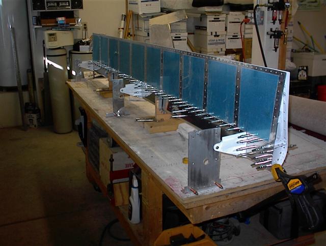

Well, I didn't build the flap on the wing but I did make some brackets to
hold the flap hinges in alignment while I built it. In the picture, the
clamp at the nose is to pull the trailing edge tight and remove the waves.
